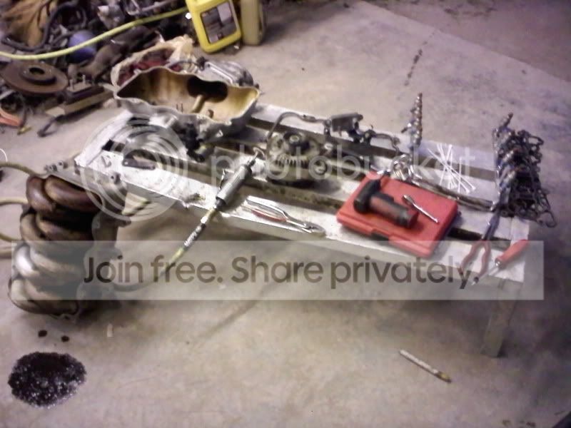

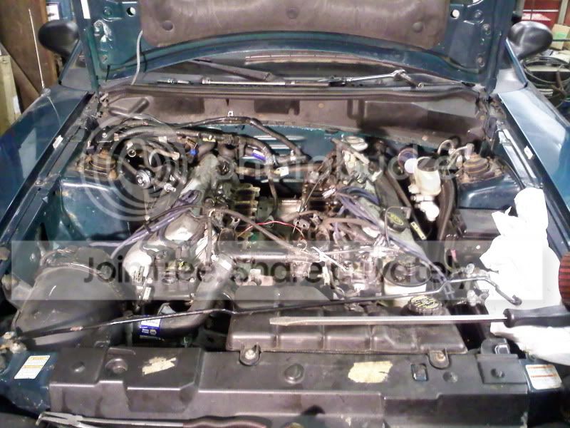

Today we're finishing the imrc delete install. got some plates and tore it down last night. so that will def be deleted when tuned. I'm about to go in this afternoon and throw it all back in. should get it running right.

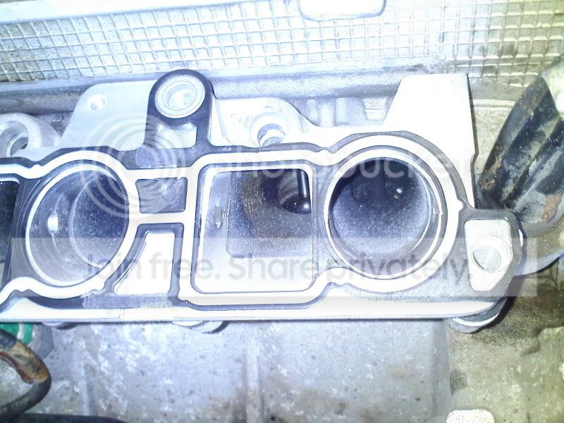

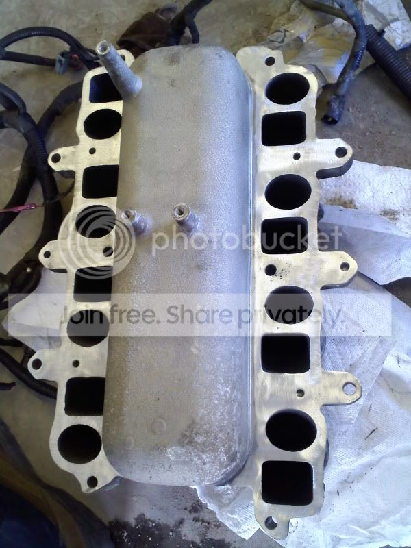

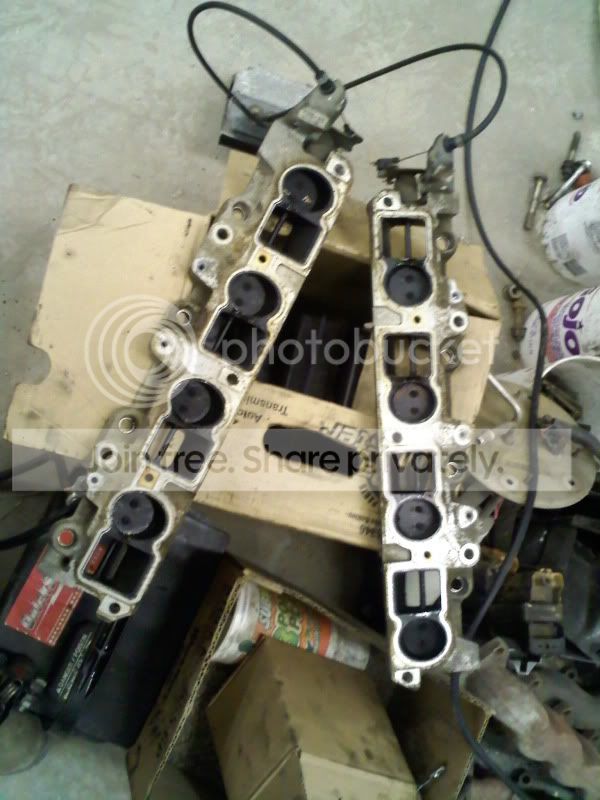

As promised, some pics of the imrc delete install will be up in a few mins.
98green5.4
98green5.4
Mar 18, 2009
567
Looks messy. blah.
who needs em? haha.
Dirtyyyyyyy... :angry7:
one side dirty, other side clean :thumbsup:
Cleaned up the intake bottom where gaskets seal.
No imrc butterfly's. straight through.

You have to plug the holes between cylinders tho. That's probably where your idle issues are coming from. If you did plug up the holes between the cylinders where you removed the rod, then you are good to go. If not, then you are going to have issues possibly. I have a friend of mine remove the rod and he welds the holes shut, then mills them flat, they work really well. We do this a lot on the 3V engines.

of course. the holes are filled in where the rods used to go.
