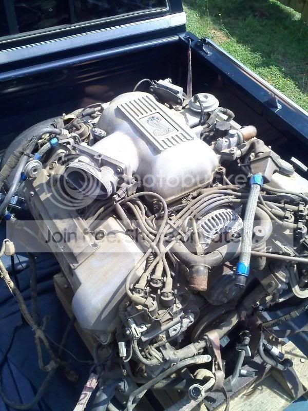

Alright, some of you know about my 1998 Pacific Green mustang gt. bought it with a nice size hole in the block. car has 80k on it and the guy claims he was going 140 on the autobahn and threw a rod. BS or not, it needed a motor and a 5.4 sohc was coming soon, possibly with a lightning s/c setup on top of it. That idea didn't work out though. We got the motor in the car and started checking prices on intakes and other things, making exhaust work, etc, etc. So the 5.4 was sold to some guy who wanted one for his f150 after we decided that it wasn't really worth it to mod or buy everything that needed to clear tight spots, exhaust and close under the hood. my mustang was motor less, just like it had been for the majority of its life it seemed like. Then we found the 96 cobra motor in South Carolina that a guy had...
Went after the motor asap. looked good so we picked it up. 60k miles on it. :thumbsup:
Then came the gathering of parts. this swap did not happen overnight, but its getting done. picked up the computer, hoses, wiring harness for motor, and other things before it went in the car.

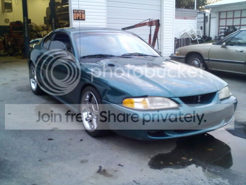

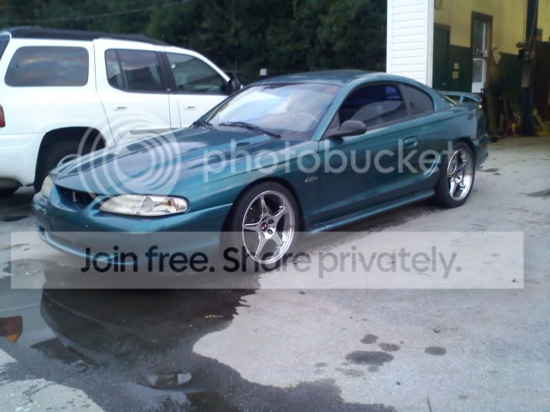

update for 10/31/09
today we fitted the exhaust to the car, and hung it up/tightened it down. before it was just hanging by bolts and a couple hangers. Full mac system minus headers.
Also took some old stock springs i had and cut one round off of each spring. Gave the car a real nice stance, and also put the chrome y2k's on the car.
The motor got the cooling system put in (all new hoses and a good flush and refill). hooked up heater hoses.
Power steering pulley was being a pain because the pulley was bent. changed out the whole power steering pulley/pump mechanism for another one.
all that really lacks to get it on the street is the tranny wiring harness needs to be ran down behind the motor and then figure out why the fans aren't kicking in.
anybody ever had this problem before? might be a fuse, something not hooked up, but i have a feeling something just isn't lining up since the motors have been swapped.
not much longer until this one is in the streets. (sorry for no pics, phone tried to die on me all day long)
