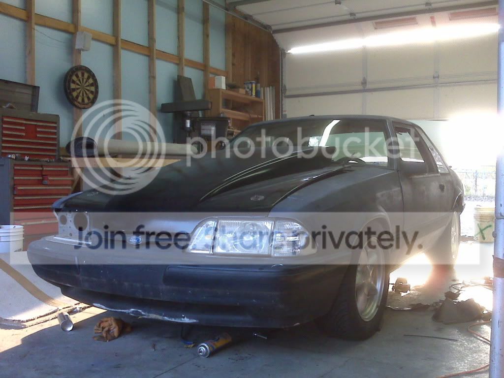

i got some work done on the car today. i managed to get almost all of the sound deadening out of the car and just mocked up the hood and trunk lid today. the trunk lid looks like its going to fit damn well but the hood on the other hand the hood is still cheap.
NXcoupe
Aug 16, 2009
1,369
80
that's an HO fibertrends decklid or at least a copy of one. I have had their decklid on my orange coupe for almost 12 years now, and it is still perfect. Even the lock works in it, just used a file to open the lock hold up and put the cylinder in it.
Keep up the good work, coming along great.
correct it is a HO fibertrends deck lid. looks like its going to fit like a glove
