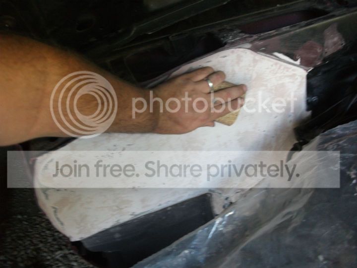

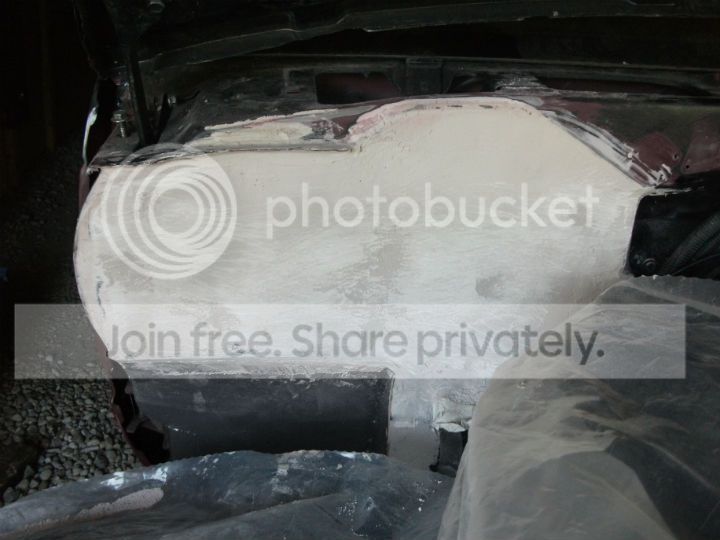

been sanding my ass off!

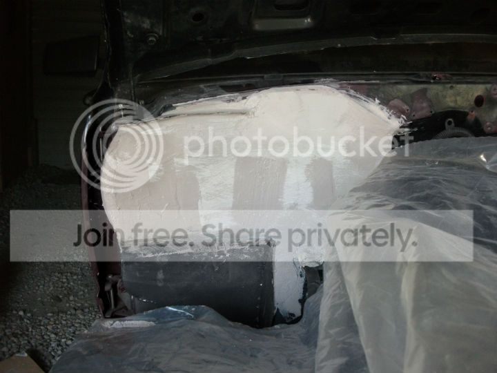

found all the low spots by sanding with a flat board and 60 grit:
applied more filler in the low areas:
sanded some fn more :p
she's almost ready for some filler primer :)

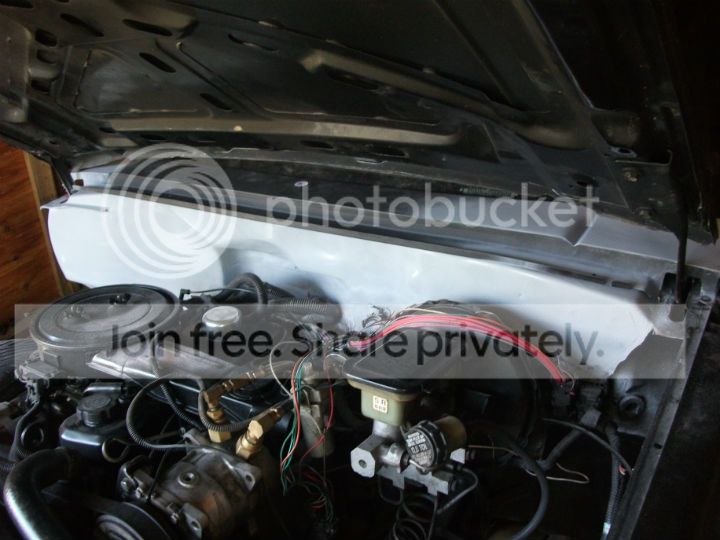

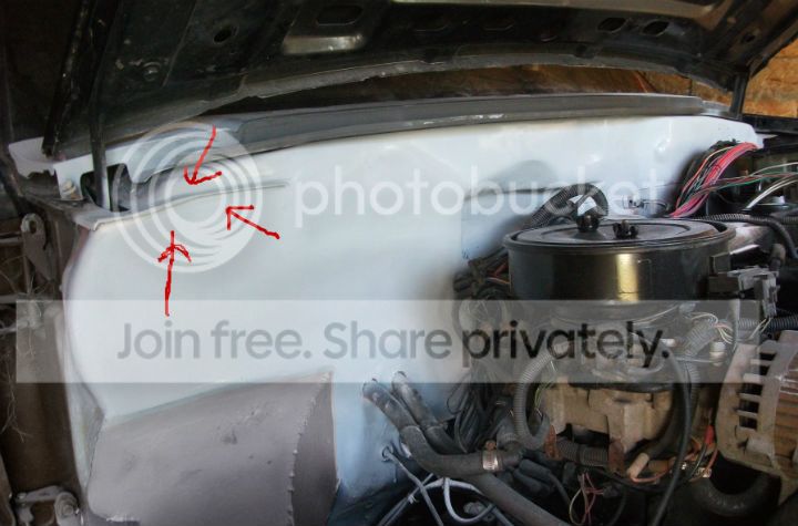

firewall is coming along pretty good. nearly done...just some more sanding and she's ready for paint.

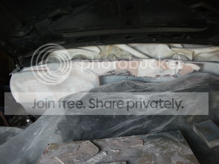

this fn little lip has to stay. its a pinch weld of the 2 panels making up the firewall and wipr cowl area. buggin me though

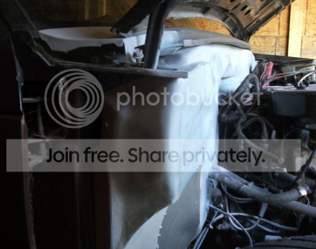

what i started with
to this...allot of work fellas, lol.
primer reveals i have some more sanding to do no doubt but its pretty close!

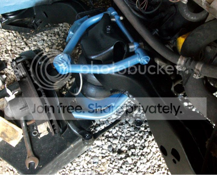

changed it up a bit. was'nt diggin the bright blue frame, lol. sanded the frame back down and painted it with black enamel and did the control arms blue. 4 coats of clear

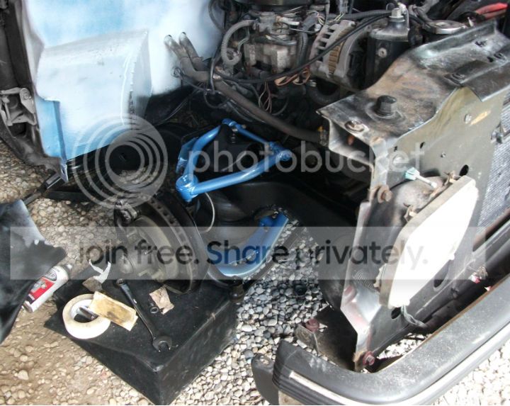

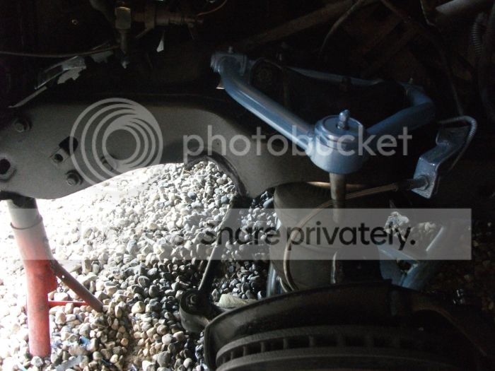

ok i think i am happy with the front suspension/frame :) i had it all done then completely tore it all back apart and redid it. no more glossy bright bumpy blue, lol:
yea, i like this allot better. textured black enamel and blue on the upper and lower control arms. stainless braided brake line. need to do something with these ugly ass rotors. wire brushed most of the rust and grime off them.
