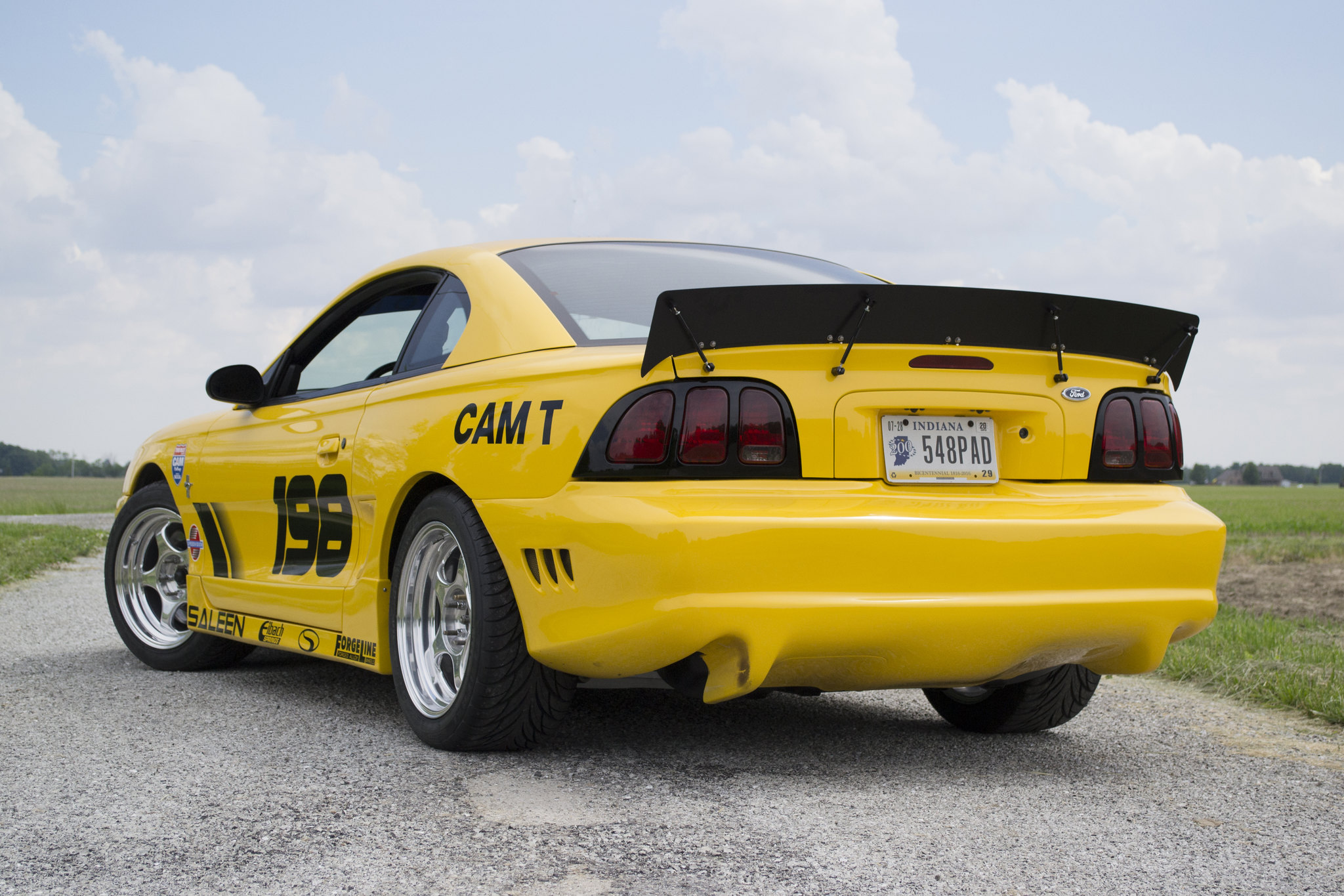

Finished product. I am pretty pleased with the end result. Autox is this weekend so I will be able to test it out and see if anything needs to be changed. I can upload more pics of the building process if anyone is interested.
DSC_0572 by Kyle Matson, on Flickr
DSC_0564 by Kyle Matson, on Flickr
DSC_0559 by Kyle Matson, on Flickr

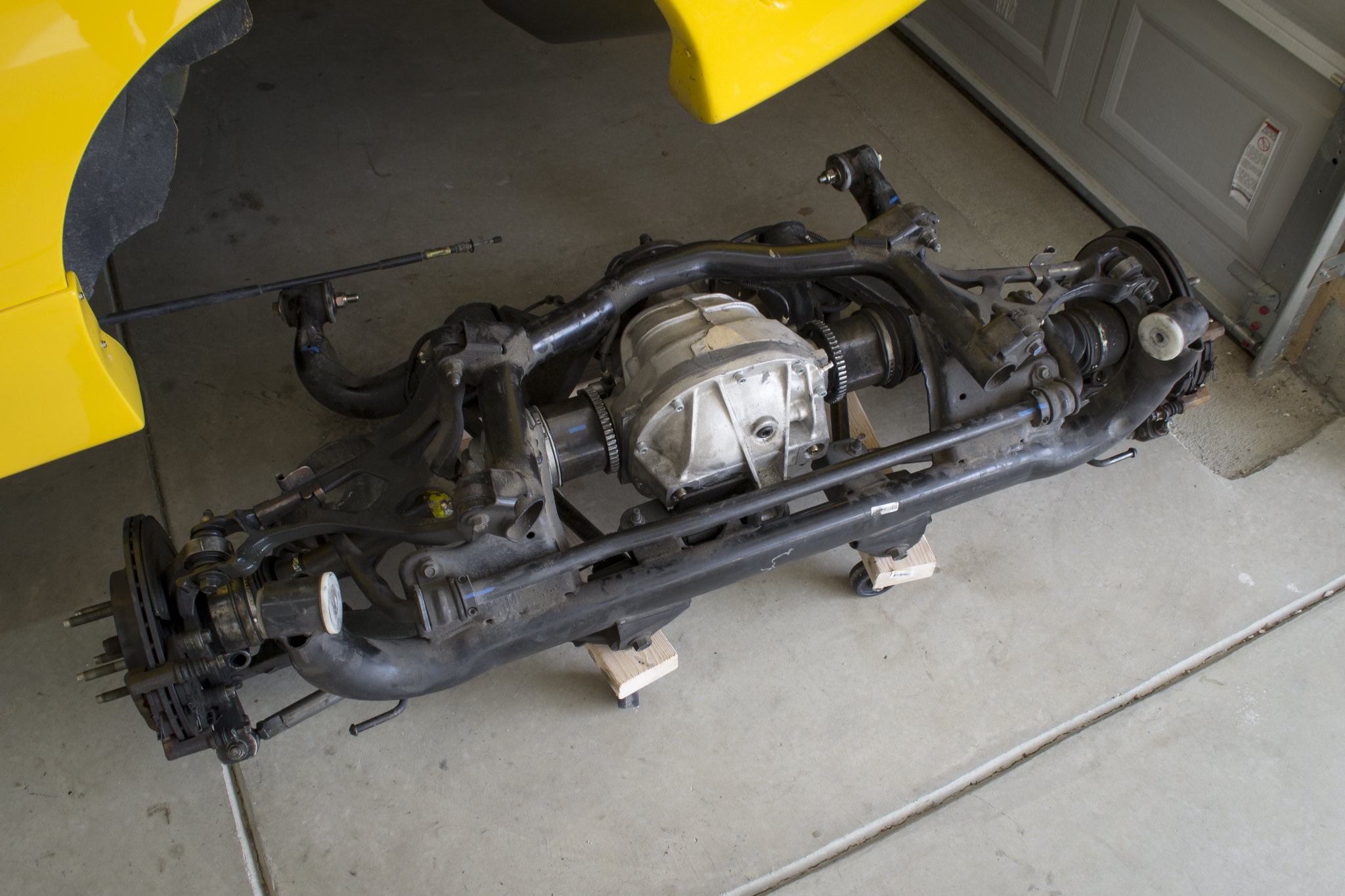

Long overdue update here.

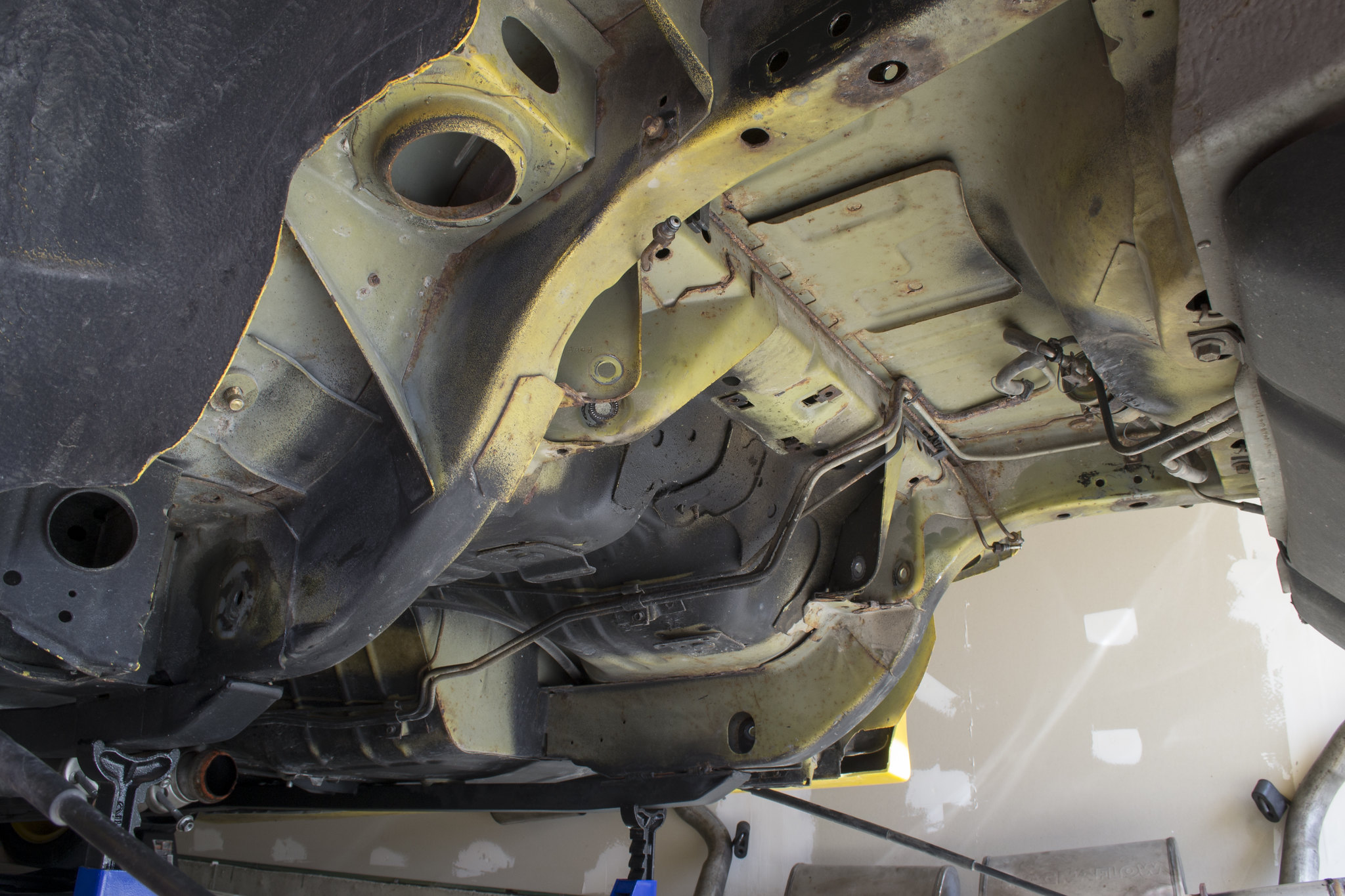

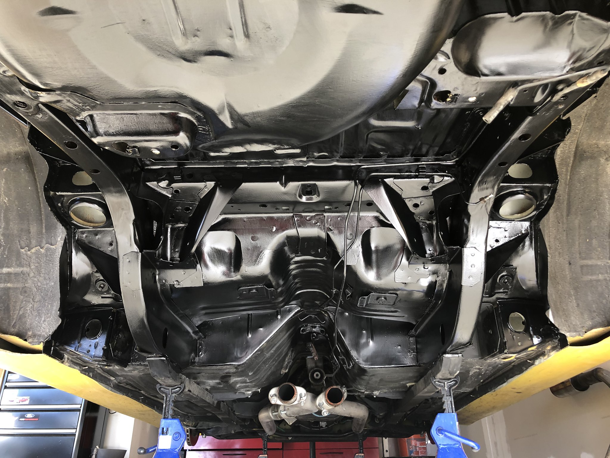

Traded my SRA setup for an IRS from an 03 cobra. I stripped the underside of the car, cleaned and painted everything, and installed new fuel and brake lines.
DSC_0424 by Kyle Matson, on Flickr
IMG_2529 by Kyle Matson, on Flickr
DSC_0413 by Kyle Matson, on Flickr
IRS has been completely tore down, cleaned, painted, and refreshed. The IRS already had the full FTBR catalog thrown at it but everything was covered in grease. One axle shaft was destroyed so both have been replaced, hub bearing have both been replaced along with one new hub.
DSC_0501 by Kyle Matson, on Flickr
DSC_0511 by Kyle Matson, on Flickr
DSC_0509 by Kyle Matson, on Flickr

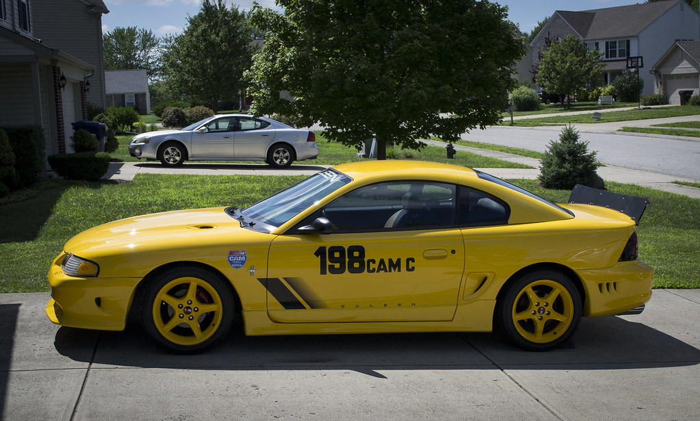

Current state, ready for the autox season to start
DSC_0689 by Kyle Matson, on Flickr
Custom side exhaust I built
DSC_0705 by Kyle Matson, on Flickr
DSC_0682 by Kyle Matson, on Flickr
