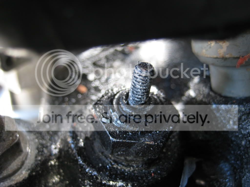

:laughing5: NEVERMIND!!! Looked in my Haynes and found this is in VERY FINE print. "Caution: Handle the coolant sensor with care. Damage to this sensor will affect the operation of THE ENTIRE FUEL INJECTION SYSTEM." Upon closer inspection, i found this
I'll replace both. Thanks to the scan tool, I would've never figured it to be that small sensor. I initially thought my o2 sensors were going belly up but they're fairly new and i'm not running rich. Learning something new every day.
