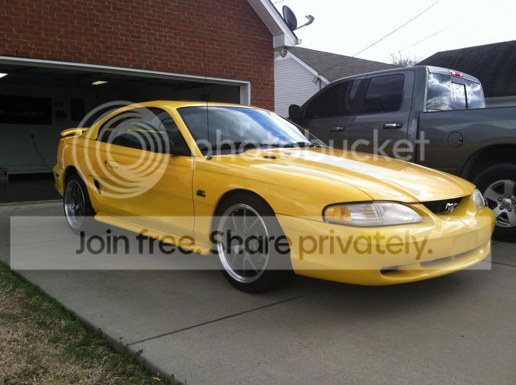

I'm running cut stockers. 2 coils in front and 1.5 in the back. Tony used to run cut H&Rs that I'm trying to get from him. They looked sweet.

How low does that get you? Pic? Hows the ride?
Warning : TO MUCH AWESOME
The ride pretty much sucks over anything that isn't smooth. I didn't measure before and after but here is a pic.
