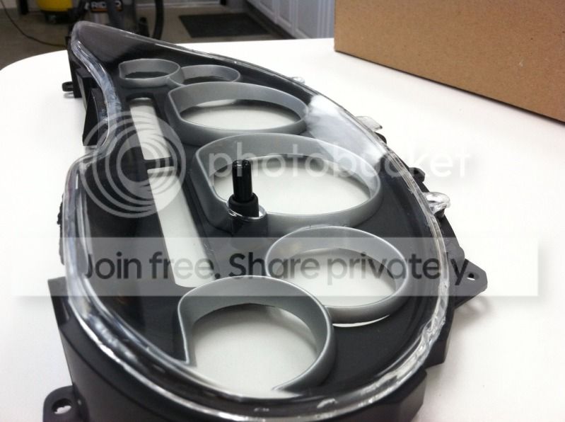

As some of you may remember, last year my buddy Tom (69clark) cast me a set of his Sinis Engineering gauge rings with some leftover resin I had lying around. I spent probably 15 hours on them getting them perfect and ready to install. 3 days after I installed them, the rings cracked as a result of shitty old resin, which resulted in the cluster glass to crack as well. No fault of Tom's at all, just shitty resin I gave him.
I was so pissed of with the damn rings, I never fixed them and they have been like that for over a year. On my recent quest to mintify my car, I asked Tom if he could cast me another set of rings to replace the originals. The great guy that Tom is, he had the resin ordered, rings cast, and they were sitting on my desk at work just over a week later!!
Here's a few quick pics of the process:
Fresh rings after I cleaned away all the mold flashing and sanded them to 320...
New bezel from American Muscle with the glass CAREFULLY separated (an hour with a dremel and a cutoff wheel on low speed)...at this point I had also sprayed a coat of guide coat on the rings to help find all the imperfections before bondo...
Initial test fit of the painted rings in the new bezel. I primed, sealed, and painted the basecoat with Dupont Nissan Silver Frost that I mixed with our new mixing system at work...
Rings glued in place...I placed plastic wrap between the bezel and the gauge cluster so that any glue that splooged out would go on the plastic wrap, not the gauge faces...
Glass expoxied in place...
FINAL PRODUCT!!!

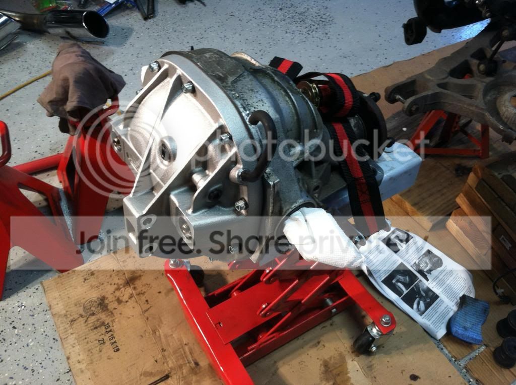

I took a few days off work prior to Thanksgiving weekend this year and gave myself a nice 5 day weekend to work on the car down at my parents house in their new garage! I've needed new bushings and to reseal my diff cover for way too long, and while I had everything apart, I switched to a Borla Stinger catback. When I removed the diff cover, I noticed a hairline crack running down the entire length of the cover where it mounts to the rear bushing mount, so I picked up an FRPP diff cover to finish the install. I also installed new rear brake hoses on either side because they got slightly torn from the brackets on the IRS. I also re-undercoated my rear wheel wells, and repainted my caliper brackets. Here's some pics from the project, and a teaser vid (cold startup) of the Stingers!
Side note: Before anyone says "Should have used the FTBR bushings", save it please. I know they are better but I can't afford them and I got the MM ones as a gift.
ENJOY!!
IRS removed, halfshafts and diff removed...
Welp, cya later!
Bushings drilled out...
Subframe and rear diff mount bushings installed...
Diff all sealed up with Lubelocker gasket and FRPP cover (NICE PIECE!!)
