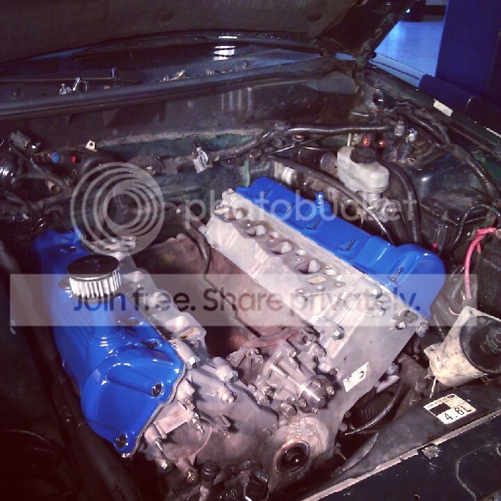

Did my Pi swap a few months back thanks to this write-up. Stock PI head swap, Dorman intake, mostly stock everything else. Theres a noticable power gain but my favorite is the exhaust note, I'm running a BBK off road x-pipe with dual Pypes mufflers. It sounded good before but after the swap....AMAZING. Heres a pic going back together.
