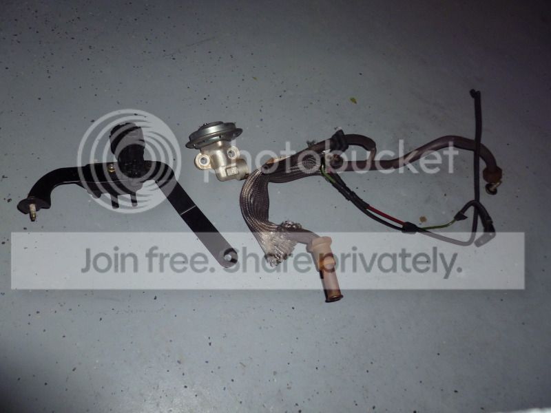

I was able to clean up quite a bit of wiring by doing a few things..
1. Coil-on-plug conversion
Was really easy to do actually. Thought it was going to be a *****.. had to do it for the blower swap!
All the shit that left!
2. EGR delete
Super cheap. Get a block off plate for nothing, and then there is a pipe cap you can buy at Lowes for the manifold.
MORE SHIT GONE!

to delete the egr, you need a block off plate(free with a little piece of scrap metal) and either a cap for on the exhaust manifold or I have heard of people taking the piece off of the egr tube that screws on to the manifold and just sticking a penny in between with a little rtv. The only part of this that costs any money is turning off your check engine light afterwards(tuner).
