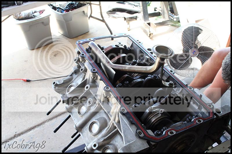

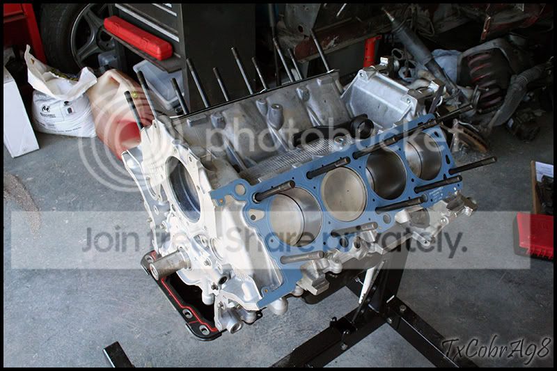

Anyways, today, my dad and I got the short block finished. We got the pickup tube on, oil pan, and heads on today, which is all torqued down and ready to go. I suspect we will be finished with the engine tomorrow and ready to lower it into the car. Im getting pretty excited to hear the car fire up and on the rollers, just so I can tear back into the car and install the vortech!
PICS!

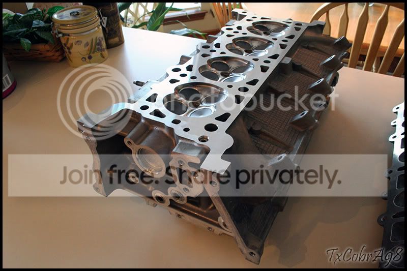

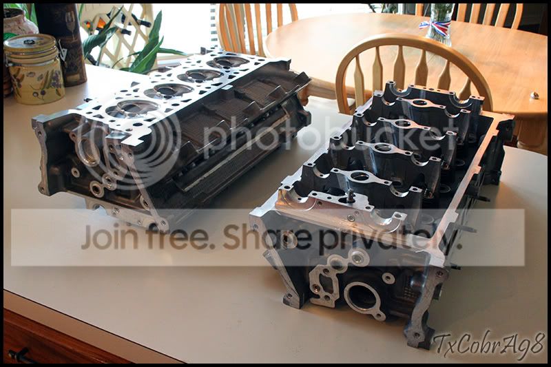

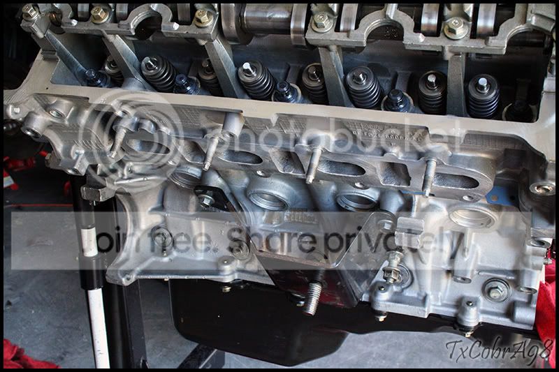

Rebuilt, machined, pocket ported heads!
top side of head
valve side of head
4v =D

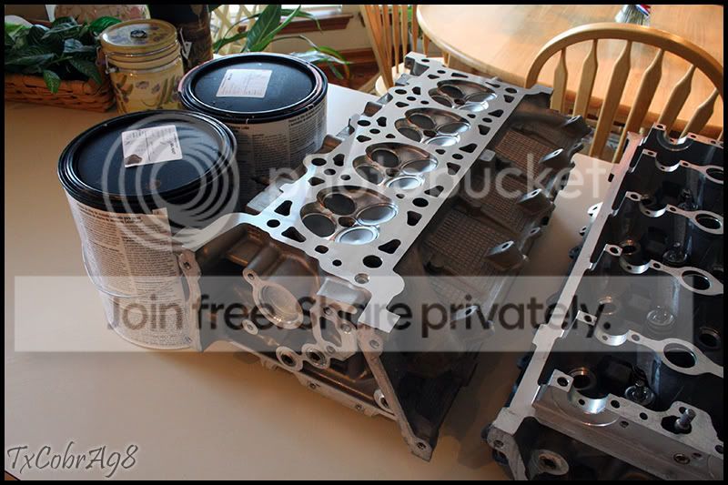

size comparison of these massive heads.. wow! 2 - 1 gallon paint buckets
pickup tube installed
head gaskets, multi layered steel felpro's

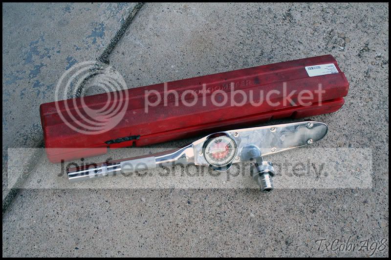

heads torqued down to 80 ftlbs - we had to go get a new torque wrench as ours stops at 80ftlbs and my dad said he was taught in the military not to use a torque wrench within 20% of its max/min amount. so, we got a new (to us) snap-on dial torque wrench. pretty cool.

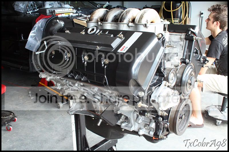

Okay guys, been a while since my last update. I finally have the engine in and tranny bolted up! Now, i only have little things to put on like AC compressor, power steering pump, fuel rails, upper intake, electric fan, cooling system, coils, plugs, wires, fluids, exhaust, wheels, EGR lines. so im nearly done!
the engine looks great though, with all of the black powdercoated pieces. im still unsure of how I am going to break the engine in yet but im will figure this out probably tomorrow. anyways, hope everyone enjoys the pics. read the captions for more info!

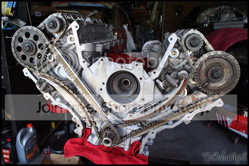

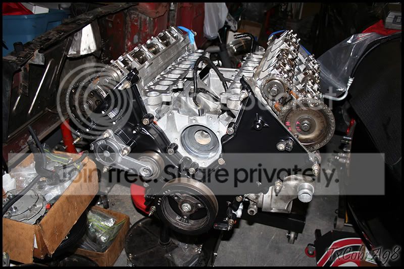

Timing chains on and engine timing complete
the new-to-us snap-on torque wrench we bought for 70 bucks. i liked the dial indicator on it and it was a snap-on so if it ever breaks, we can get a new one! anyways, we bought this because our other torque wrench didn't go high enough as explained earlier.

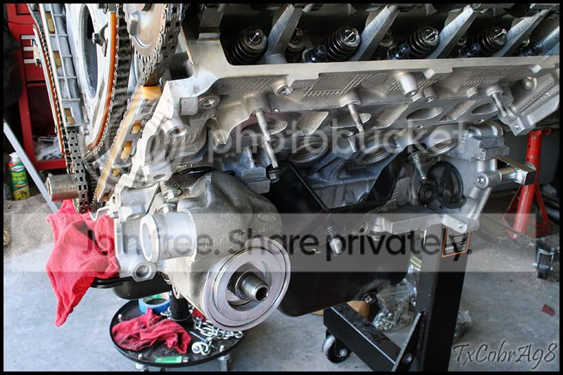

oil cooler and motor mounts installed
passenger side solid motor mount

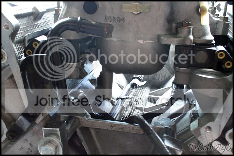

knock sensors installed and coolant crossover tube

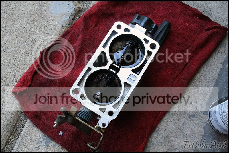

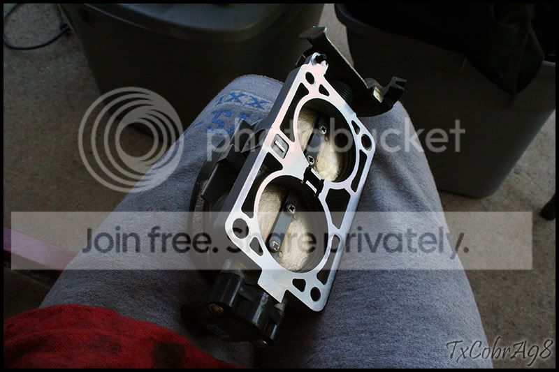

dirty throttle body

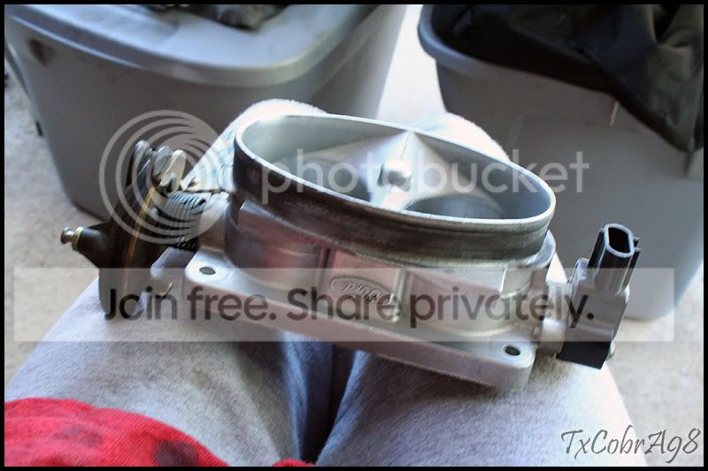

cleaned throttle body
polished it up slightly with 3 stages of steel wool.. didn't really try and make it a mirror finish, just cleaned it up.

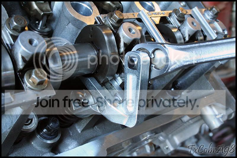

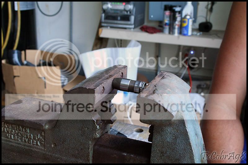

valve spring compressor tool i ordered (that doesn't work worth a s***) - i just ended up undoing all the timing chain assemblies and taking the intake cams off and putting the rocker arms in and bolting the cam back down. the tool only worked on the exhaust cams and valves.

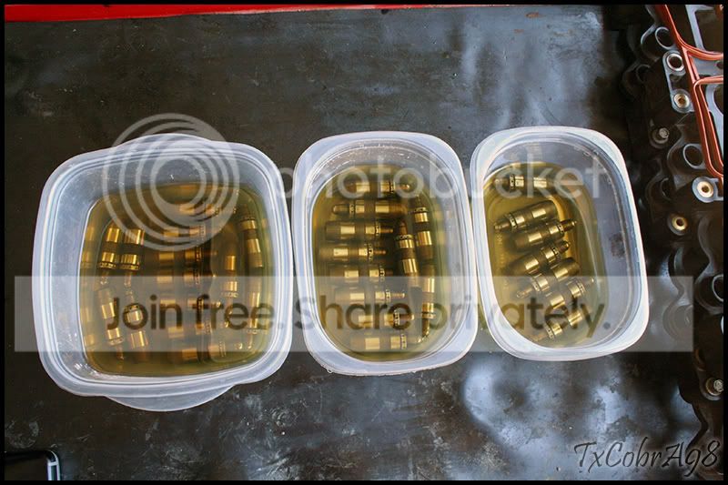

lash adjusters soaking in oil
compressing the exhaust valves to put the rocker arms in

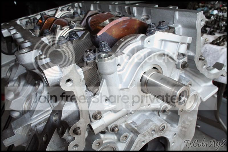

new high volume oil pump installed

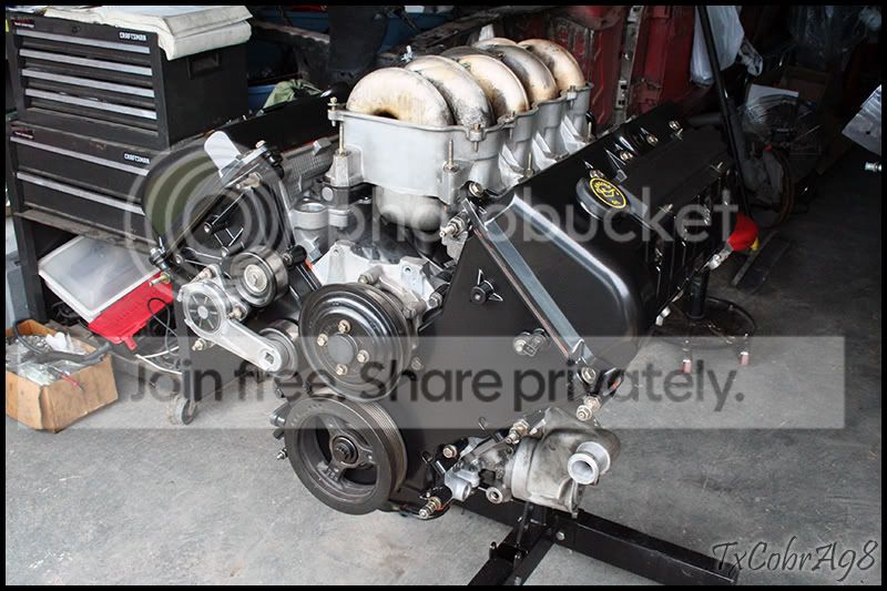

timing chain cover installed, along with polished up belt tensioner, and harmonic balancer installed with new ARP crank bolt torqued down to 125ftlbs i believe is what it was? the stock crank bolts are prone to failing, hence the new ARP bolt.

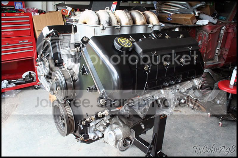

valve covers installed after they had been cleaned up and put back together to make sure no foreign material was in them

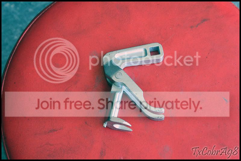

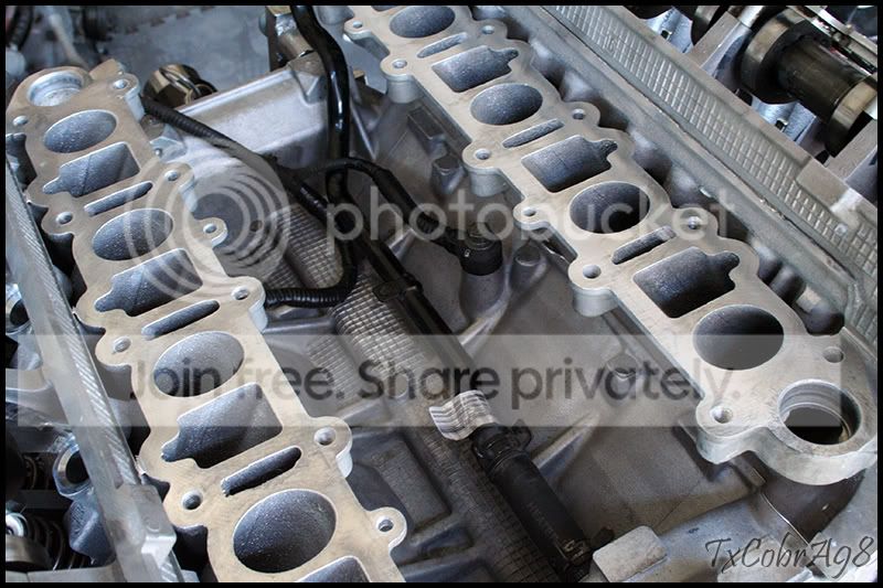

WHOOO! no IMRC's! watch for an IMRC delete HOW TO coming soon!
yummmy!
cleannnn IMO

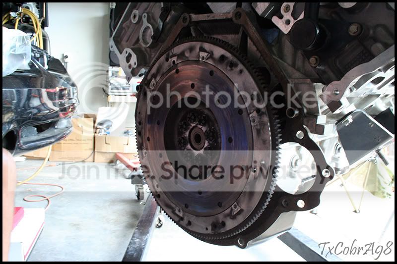

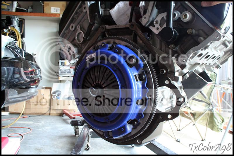

billit aluminum flywheel bolted and torqued down. bolts are torqued in a criss-cross patter a turn or two at a time, until torqued.
SPEC Stage 3 clutch installed - bolted and torqued down, also in a criss-cross pattern
