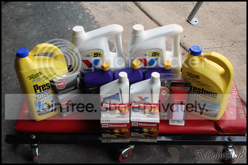

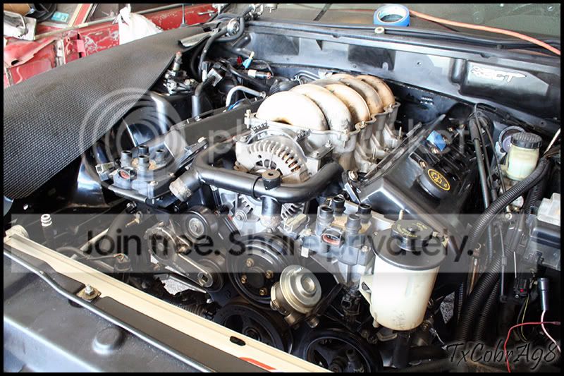

Well, today was a busy day. I got up at 8:30AM central and stopped working at 9:30PM. I did run a few errands to go pick some things up and called HPP Racing to schedule a dyno session. Today, I bought all my fluids and such. Heres my shopping list:
Motor Oil - Valvoline 10w40 Non-Synthetic - 12quarts (6 for initial break in and warm up, drain, 6 for the next 500 miles or so)
Oil Filter - 2 x Motorcraft FL-820S filters
Tranny Fluid - Royal Purple Max ATF - 3 quarts
Coolant/Antifreeze - Prestone 50/50, im thinking maybe i should have gotten straight antifreeze and done a 70/30..?
Spark Plugs - NGK TR6 for break in - I will switch to NGK TR7s in a couple weeks once i put the blower on
Drain Plug - Magnetic Drain plug that I don't have to remove to drain the oil - just have to push it in and twist it
New PCV valve - im not going to run the catch can system right now, i dont like my current catch can setup
Also, today's progress - ALL INSTALLED - the entire upper intake assembly on and vacuum lines connected, complete wiring harness, fuel rails, accelerator cable assembly, coil packs, alternator, water bypass tube, drive belt, heater hoses, power steering reservoir, power steering pump, dip stick, AC compressor and lines, motor mounts with nuts torqued down to 110-120ft/lbs, driveshaft with bolts torqued down to 80-90ft/lbs, shifter, and clutch cable!
What i have left - long tube headers, hpipe, steering input shaft, EGR lines, cooling system (t-stat, rubber hoses, coolant reservoir, elec. fan), battery, CAI, wheels, hood

Well, the car has been running for 3 days! I have put probably 250 - 300 miles on her if I had to take a guess. I am loving it! TXCBRA doesn't run amazing quite yet though. I have a dyno and tune session up at HPP Racing thursday to get it running better. The IMRC delete is killing it down low, bogs and surges quite a bit and i believe the timing is being thrown off from the IMRC deletes. But, should all be fixed thursday.

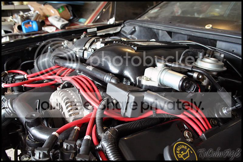

She sounds very good though. I haven't burned ANY oil that I can see yet, which is awesome! normally i'd already be putting oil in.. so this is pretty awesome to not have to throw oil into her every few days. I will be getting videos probably tonight, depending on weather. I was out last night taking pictures until 2am which I will post up a few of them later on. All in all, im super happy! Anyways, heres the rest of the pics of the motor going in and what she looks like all put back together!

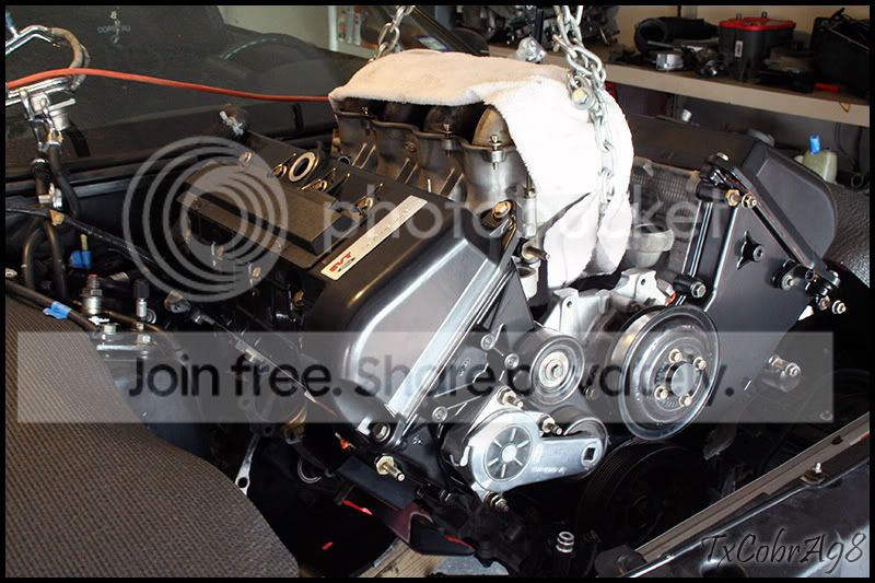

The motor being dropped into place
Me putting in my Steeda Tri-Ax shifter after new Royal Purple fluid went in.

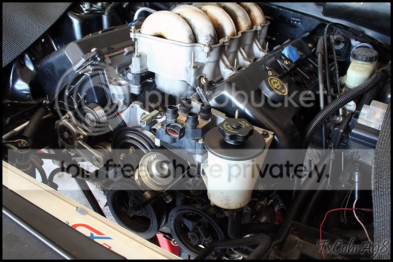

Some of the front accessories on the timing chain cover
Alternator, water bypass tube installed

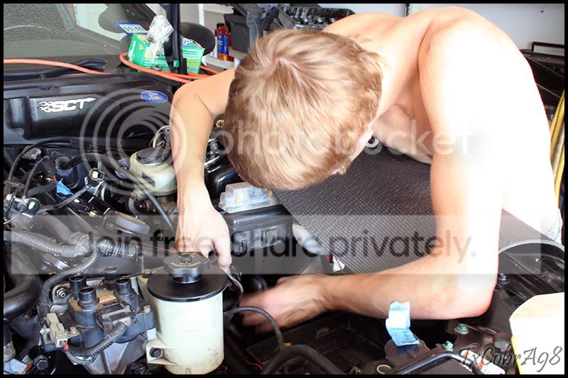

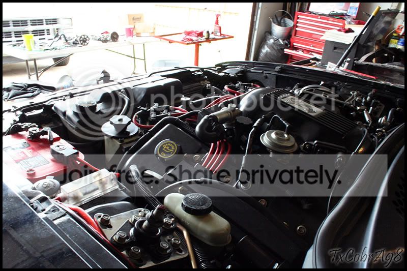

me running the wiring harness. when putting the wiring harness back in, its pretty self explanatory where things go based on how the wires bend and fall basically back into place. but i still like to label the harness connectors with some tape just so I am 100% sure things are in the right order. It also helps speed everything up a bit.
the fluids that I am running. Valvoline non synthetic 10w40 oil - royal purple Max ATF tranny fluid - motorcraft fl-820s filter - NGK TR6 plugs gapped at .032" - Prestone 50/50 coolant
me putting in the 6 quarts of valvoline

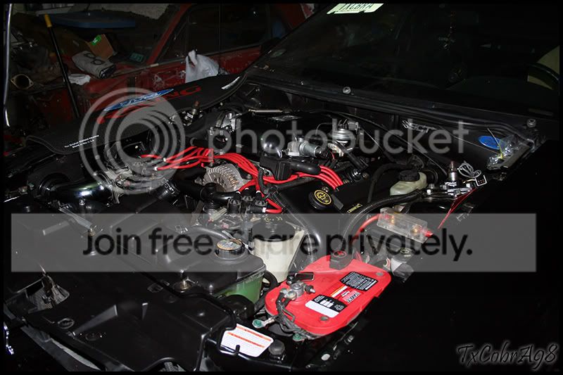

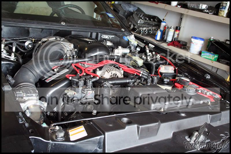

everything installed and ready to be fired up!
no leaks, warmed up to temperature, thermostat opens, all is good!
bout to take her out for the first spin and break in!
end result! whoooooooooooo
