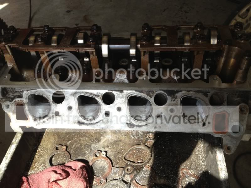

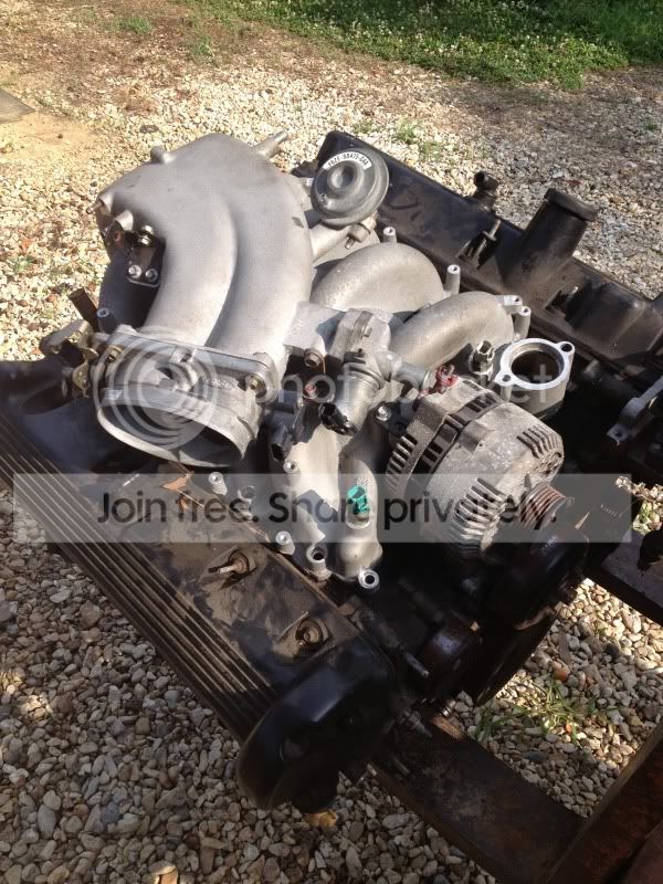

So my main reason for doing this is the valve stem seals need to be changed, well that's where it begins. My goal is to to upgrade home brew style. Lol. First I came across a svo intake on eBay so I scooped it up. Then I have a complete npi motor just laying around so I pulled the heads and started work, beginning with a port match of the manifold and heads. Next a friend of mine is gonna hook me up with some pi cams for cheap cheap. After that the valves will get lapped and valve stem seals will get changed out. I'll be sending the heads to clean up the mating surface. Then the install will be done with a tune from mod mafia in ms.
Test fit.

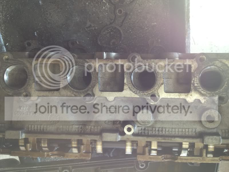

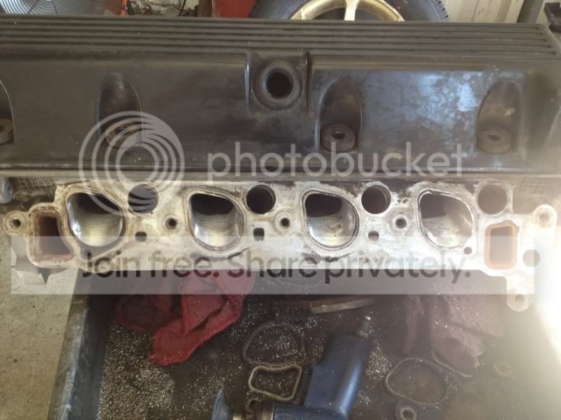

Port matching

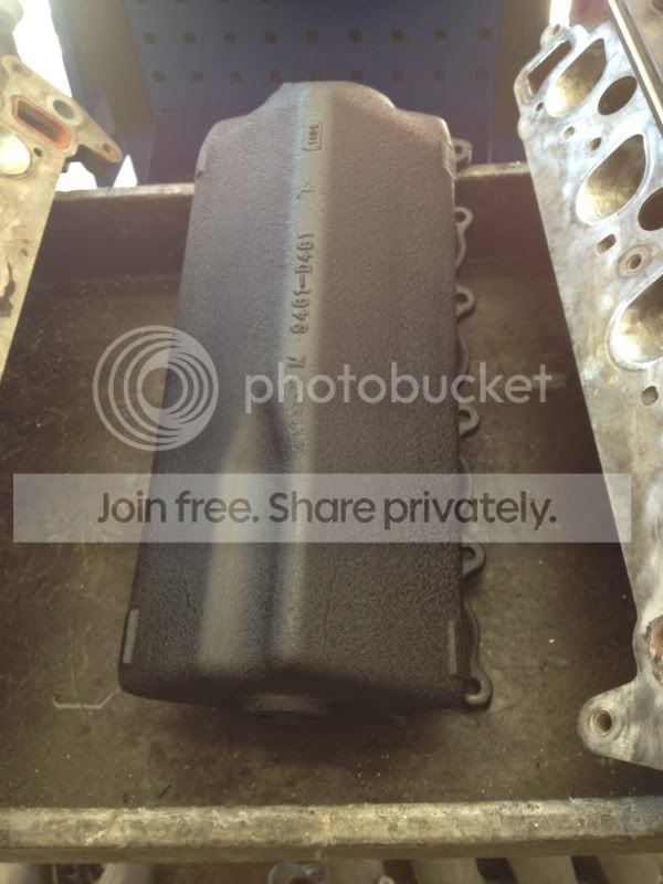

can the SVO be taken apart? you may get some more power out of it if you port the plenum. you may be able to get more airflow on any sharp radius angles.. i done this on my RR intake and seen some power.

Yes you can but the inside has no sharp angles. That would be a lot of work for a mere 1hp. If I was using big cams and higher compression I would do it but for stock pi cams I'm just gonna port match.
