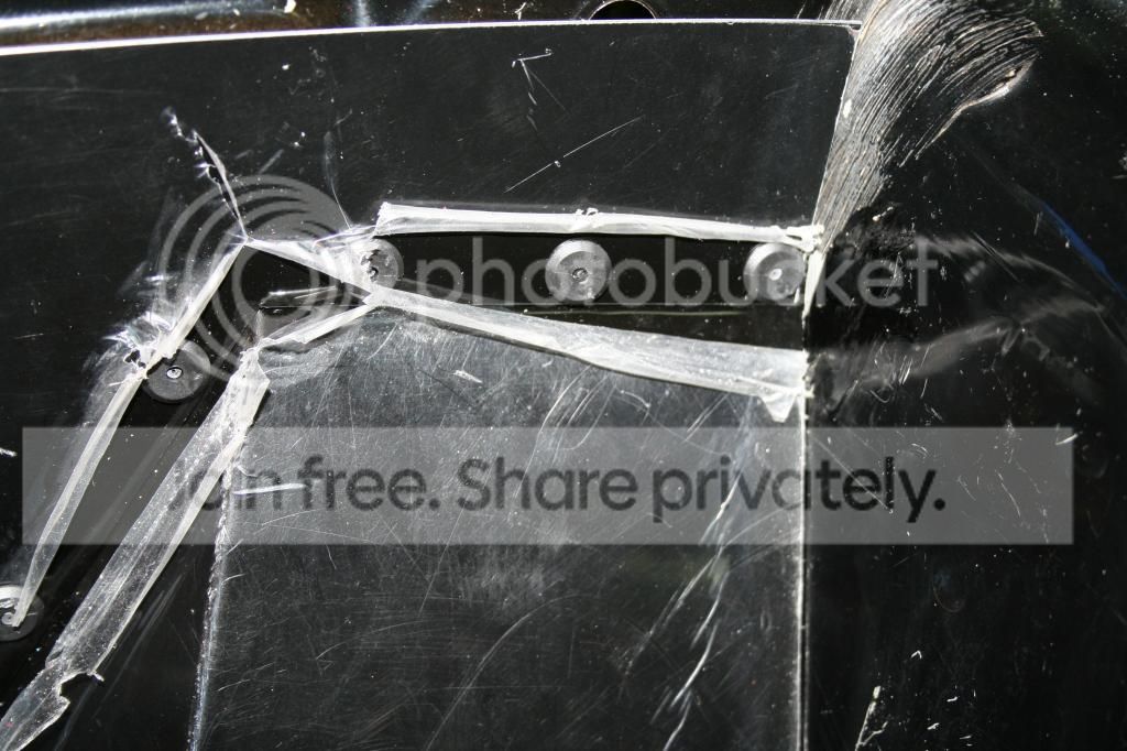

Finally Got these panels installed and I am very pleased on how much they clean up engine bay. Word of advise you many have to remove some other around the heads as panels need space for installation and some trimming. I deleted the windshield washer tank as I live in a rainy climate and I never use it as it makes a mess all over my black paint. Something to consider as you will have to make the hole for the tank if you want to reuse. Panels are gloss black, the plastic wrap was left on to help protect them. Re-routing wires is up next on drivers side.
Current state.
Plastic rivets are used since there are easier to remove than metal ones plus since they are black they blend in.
Close up, holes had to be enlarged. The top rivets go in the sidewall of engine as well as two of the bottom rivets.

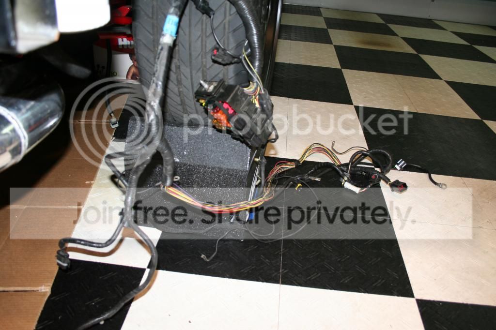

Wiring! - the fun part /:
I am not looking forward to this part at all. I have been doing other projects around the house to avoid tackling this part of the build.

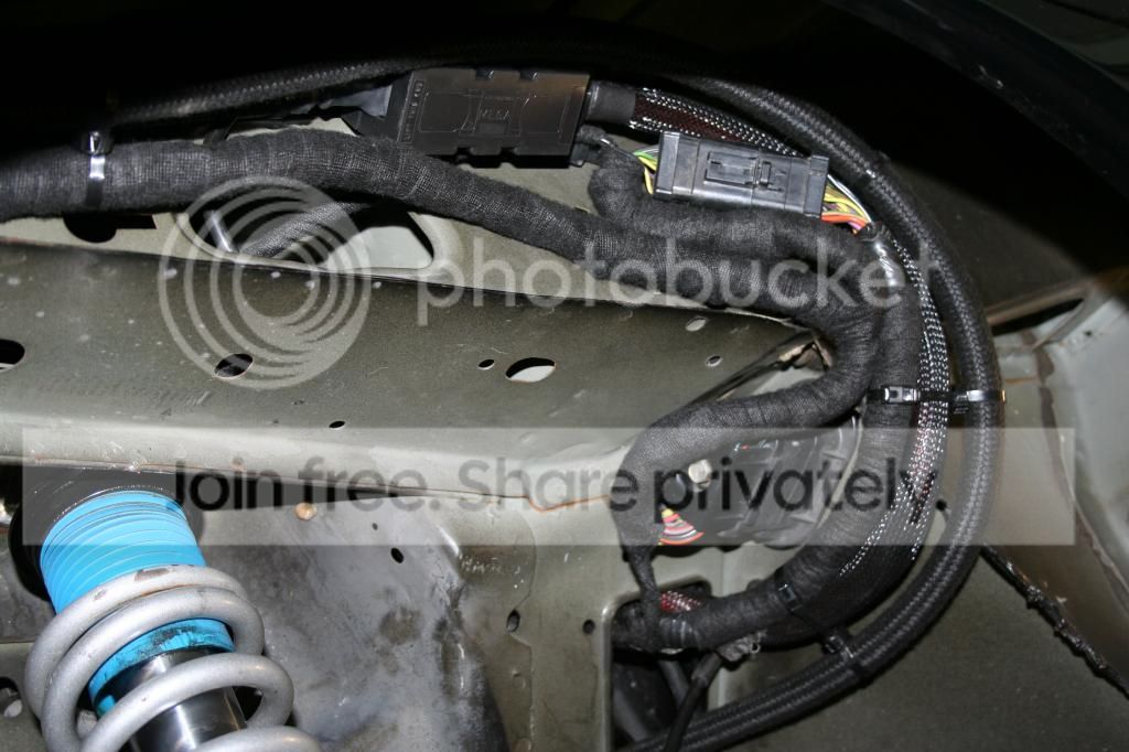

Since Dalamar has brought up wiring here are some pics. I am using self fusing tape for the first layer and Tesa tape for exterior to wrap wires. Tesa tape is used in BMWs and other German vehicles for wiring. It is extremely flexible and looks real good plus easy to use.
This is easy compared to what I have to deal with the MS.
Here you can see that I left some of it wrapped with silicon tape and other with Tesa tape so you can see the difference. If you use thick silicon tape make sure not to wrap it super tight as it will cause the loom to not be flexible. You can use the Tesa tape by itself but I feel better wrapping it with both. I may use only the Tesa tape when it comes to interior and one or two wire runs that are not by the headers.
I cut out some of the factory cable's push tabs. You may wrap them up with Tesa tape and push them in existing holes.
Here is how I wrapped the drivers side. You can see the factory wiring main power cable to battery in the rear and -6 line for overflow canister.

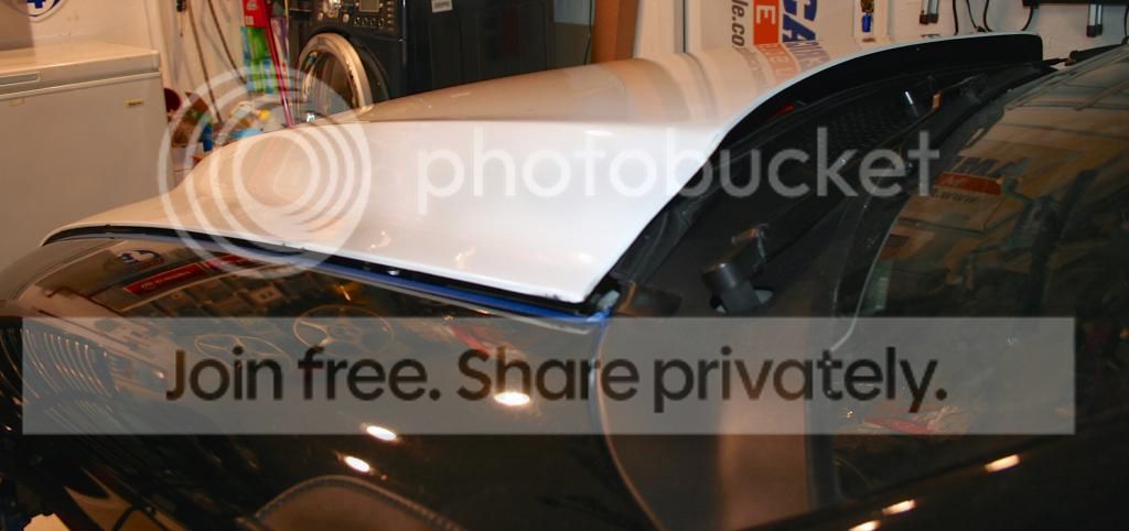

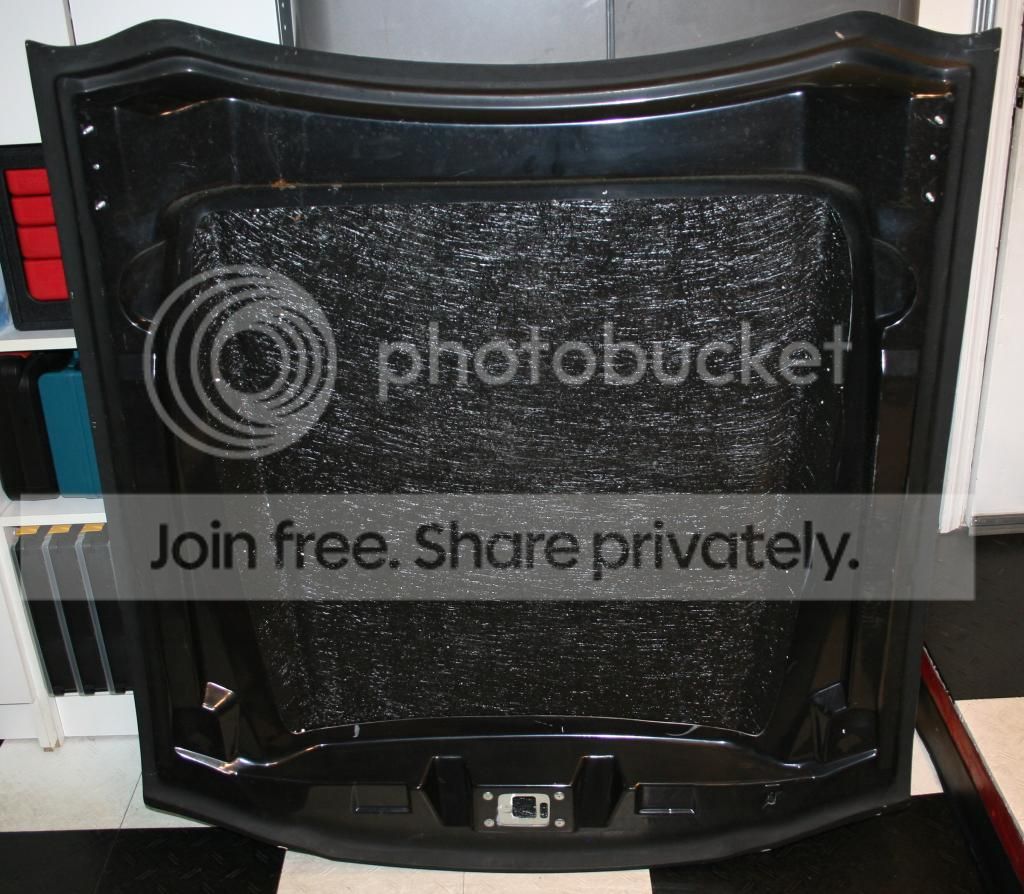

I scored locally a great deal on this new Kaenen 3" hood. Its the one from American Muscle. It looks exactly like my old 6" hood. As like my old hood this one is fully open in the rear which allows more air to escape compared to the Cervinis which is slotted. Since the underside is unfinished it is lighter than the Cervinis. This hood will also have move room underneath since it appears to have a bigger cowl. I really do not need this much clearance and I will most likely sell this one as well for a lower profile hood.
Fully open and like my other hood water will not go in since it slants towards the windshield

Venom, cowl induction hoods pull air into the engine bay, not vent air out.
Yes that is correct. Let me clear things up. A cowl hood provides cool high pressue air inside the engine bay "while the car is moving". When you are stuck in traffic the cowl hood is not pulling any air and is venting air out of the cowl. The bigger the cowl opening and quicker that hot air escapes while idling. Any owner of a cowl hood will tell you that they can see the heat escaping out the vents while idling. It is an added side benefit which does not matter at the track but on a street car it matters when you live in a state that sees 95plus degree weather. Hopefully that clarifies what I was talking about when I said "allows more air to escape" which should of been "vents more air while car is idling (not moving) :)

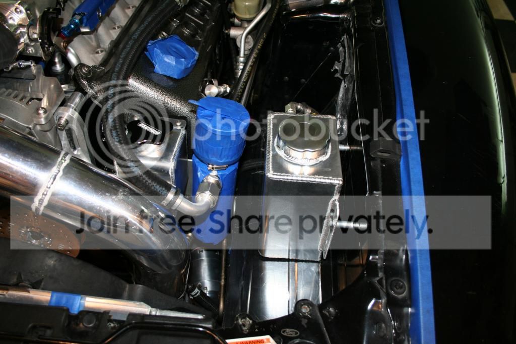

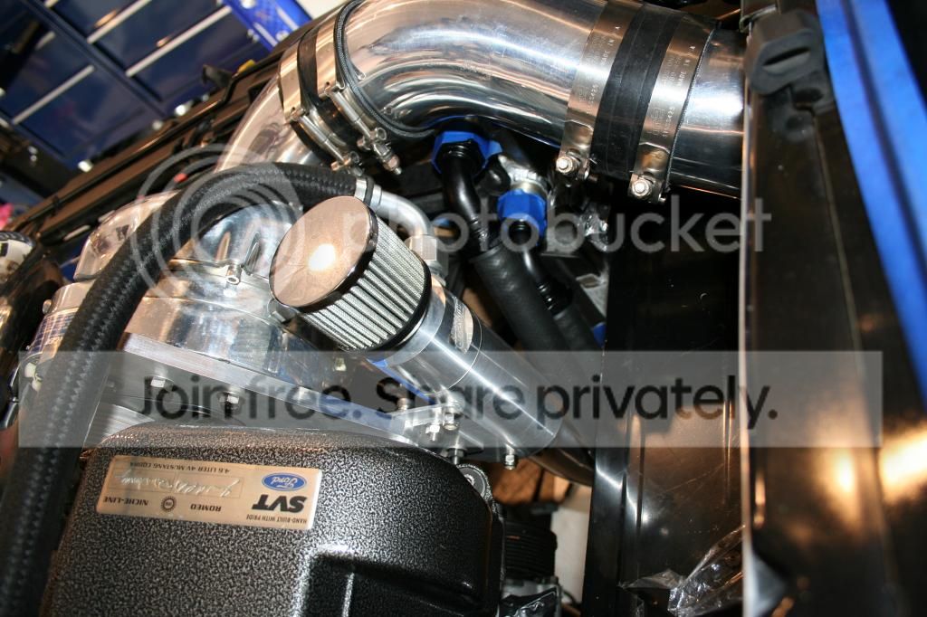

Can you tell me a bit about that catch can set up?? Looks good..
Its an Aerospace catch can. I got this since it uses -12 an fitting. I got 2 to avoid the lines crossing over from one side to the other . A bit overkill as far as catch can but I think it makes the bay look more symmetrical plus better too much than too little.
