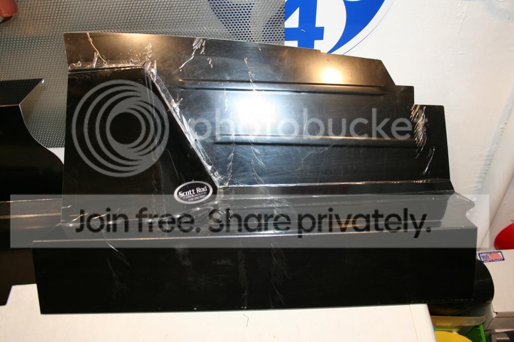

looks good man. Curious why your not gong with the weld in scott rod panels? Just seems like the riveted in panels will just not look as finished as the rest of the engine bay.

There's many reasons I have not gone with weld ins. Paint is a long ways away plus I know myself I may change a few things around. Last thing I want is to make holes into a panel that has no holes. The riveted panel will serve its purpose then it can be sold if I do not like it. I think a clean engine bays look nice but at times it may be way too much and you may lose the mechanical look of an engine bay. It may look too much like these hot rods that everything is covered up and looks too pretty Kind of hard to explain but trust me if it does not look right it will be changed. One benefit of the riveted panel is that it looks like there will be some spaces or empty cavities in between the stock and Scott Rod pieces. You can use this to hide wiring. The only thing I may do is use plastic rivets instead of metal ones as plastic rivets are easier to remove. Ultimately I am looking to keep things simple, easy to work on and clean, in that order.

I gotcha on the weld-ins as I welded mine up, cut the hole for the NA power pipe and then found a deal on a vortech kit. But the fun with metal and welding is its easy to fill in holes and make it look like it never happened. If you want to make them easy to remove check out a rivnut tool and you could make the panels removable by just taking the screws out.

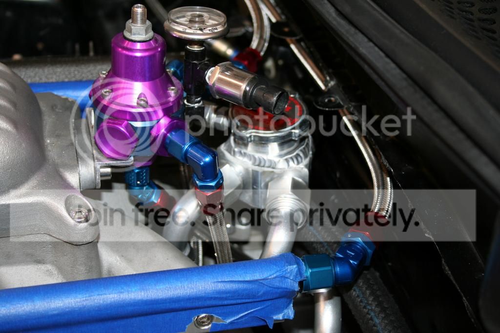

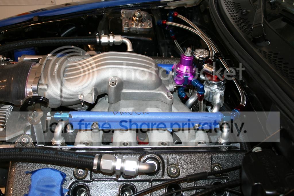

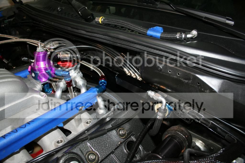

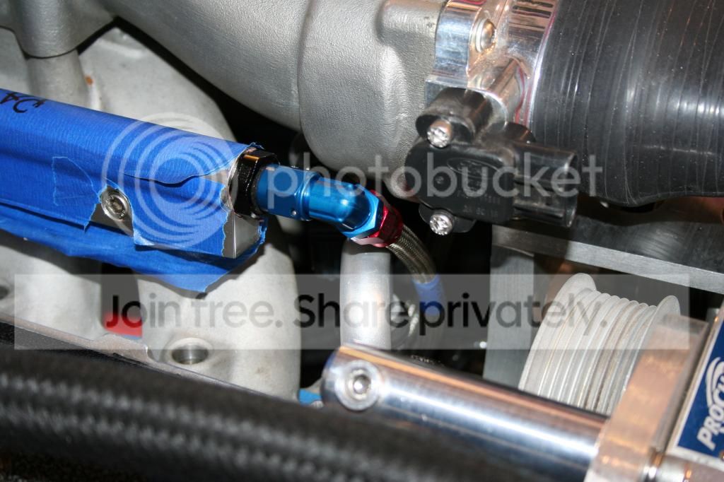

Got a couple of things done. Fuel lines run and got a great deal for a Saleen kit which I have been looking into for some time.
Current state
Flex fuel sensor
-8 y block
FPR, lots of lines under there but better hidden then all over the engine bay
Here you can see the return line -6 that goes under the intake
Close up
Other side

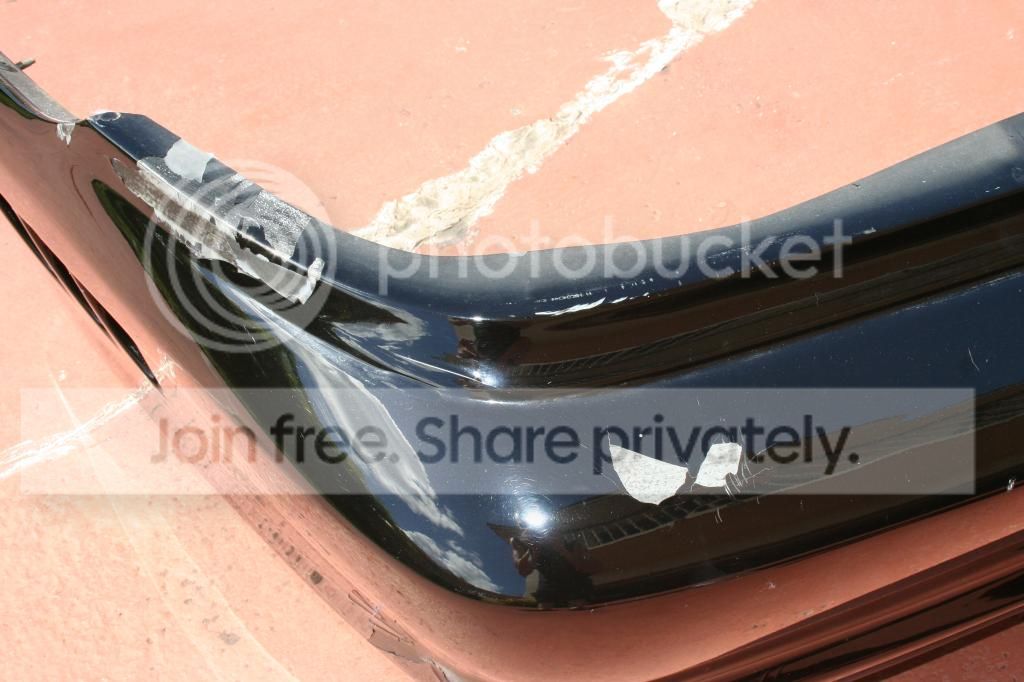

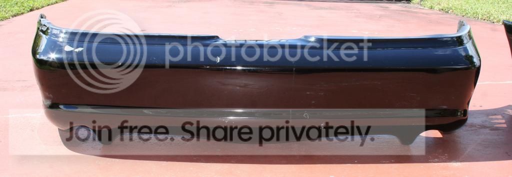

Saleen bumpers
Despite them looking good from far they are far from good. Looks like poor prep or lack of flexible additive or both.
Side skirts are really bad as they used some epoxy to hold them in place and was nearly impossible to remove them off the Cobra they were attached to. I might get a pair of Cervinis Stalker and sell these off as the work required might be a tad too much and results might not be as good as new set.
Had to try at least front bumper and as expected looks great

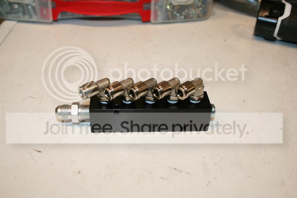

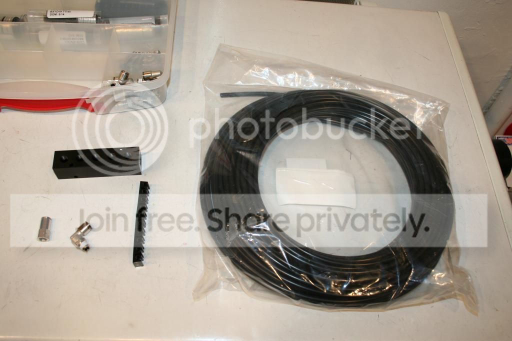

Got a couple of things today that will keep me going. One being the panels and other is vacuum manifold. I went with push to lock lines. I noticed that a lot of racers are using it plus my red race valve came with one. I hope that going with the push to lock setup makes it easier, cleaner and more secure than using AN fittings.
Lets see how this works out, kind of hesitant to make holes in it.
Make sure to get nylon tubing as it holds up better to heat and bends easier.
Here is the fittings which are nickel plated brass. I have noticed that many use the thermoplastic fittings but I have seen specs and noticed the these have a lower melting point then brass. This means that the fittings with soften at a lower temp. I am sure that you can get away with the plastic fittings but feel safer with brass plated plus think it looks better in silver finish. The manifold block is small and can be mounted anywhere. Also note that the 90 degree fittings swivel making it easier to position. The long rectangular piece is a holder for the tubing to make the routing cleaner when dealing with multiple lines going in the same direction. The straight fitting is female and is going to be used with a barb end to connect to lines that are not threaded like map sensor.

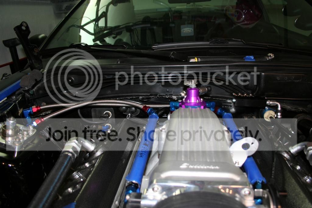

Mocked up the vacuum system. Didn't know how or where but it seems like best place would be against the firewall. It is just laying there will have to make a bracket or screw holders down to firewall. I was hoping to mount the overflow can but seems like I will have to start wiring as theres tons of wires I need to move on the drivers side. Sorry about aome of the pics that are a bit blurry.
Close up
