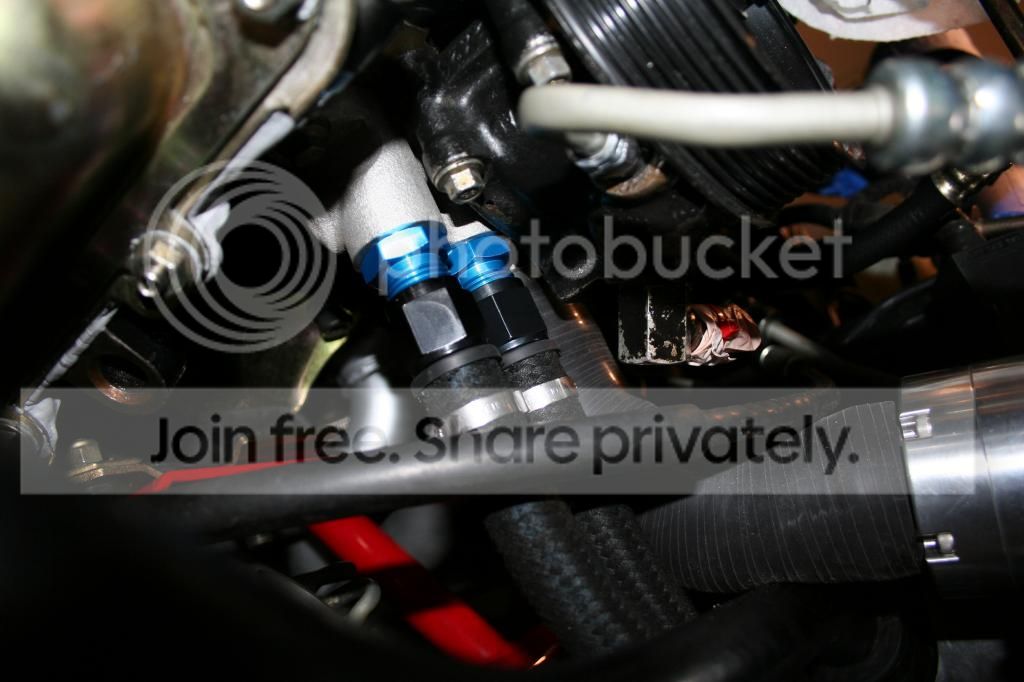

Revised the thermostat housing. Since I live in a hot climate warming up the car won't be as much of an issue. The 3/8 will circulate water into the block bypassing the radiator. Since the bypass is not going through the radiator it should warm up quicker. Once the thermostat is open the water takes the path of less resistance which is the -16s. It's the same concept as most have done with drilling holes into the thermostat when they delete the crossover. The other 2 ports are for adding temp sensors if I want to monitor temps from that spot in he cooling system.
V
venom
Mar 31, 2007
480
Here is the thermostat block and tee.
Bypass
Inside look
One port is the bypass and other is for a temp sensor just in case I want to measure temp coming out of radiator.

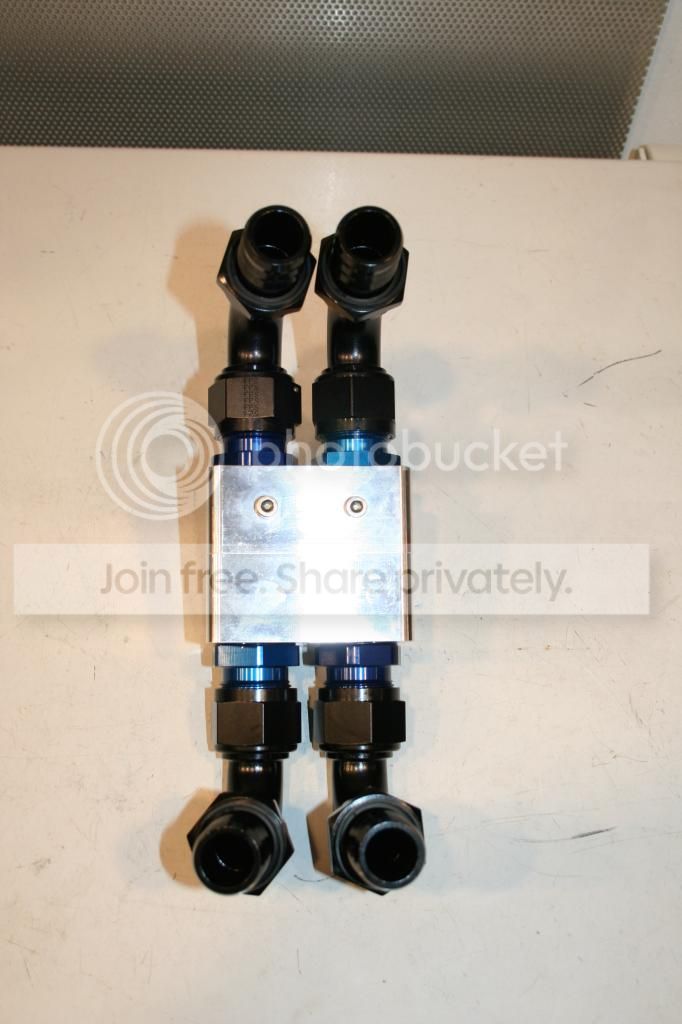

Going to try and get things done on a weekly basis as I want to move the build forward. I was able to mount the coolant block and remove the main harness and CPU. I have plans for a Mega Squirt plus it provides for a cleaner look without all those factory wires.
Stock harness
There is a lot of clearance for lines.
Its easier to remove glove box and insulation to get factory ECU and bracket out of the way.

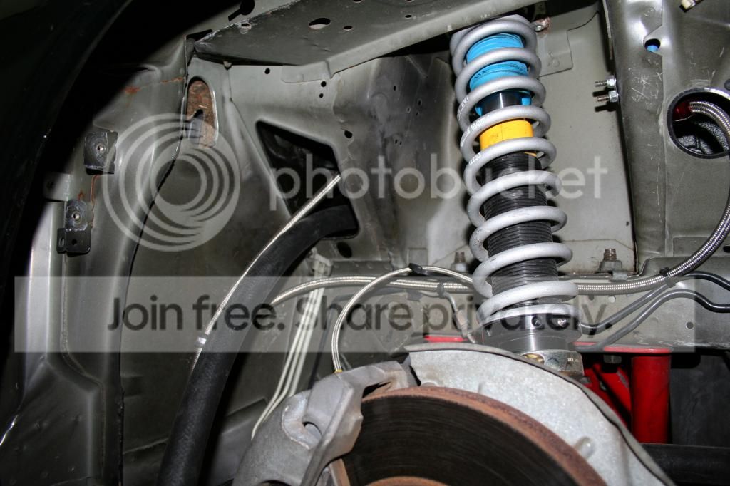

Top view of -16 lines
Took a while to get things lined up as the A/C lines had to clear as well but not shown in the pics.
Here is the inside shot, the lines will be inside the fender toward the top where there is dead space. I have recently found out that Fragola released 3 weeks ago a -20 AN push loc hose like the one I an using. Unfortunately it came to late for me but others may want to go this route. You can double up on aluminum brackets if you don't have some thing thick enough to support something heavy instead of using steel. Not too pretty but it works and not seen. Will focus on pretty things up top where its seen.

Here is the bypass tee 1.75 radiator to 2.0 FRPP housing.
Bypass at the thermostat housing

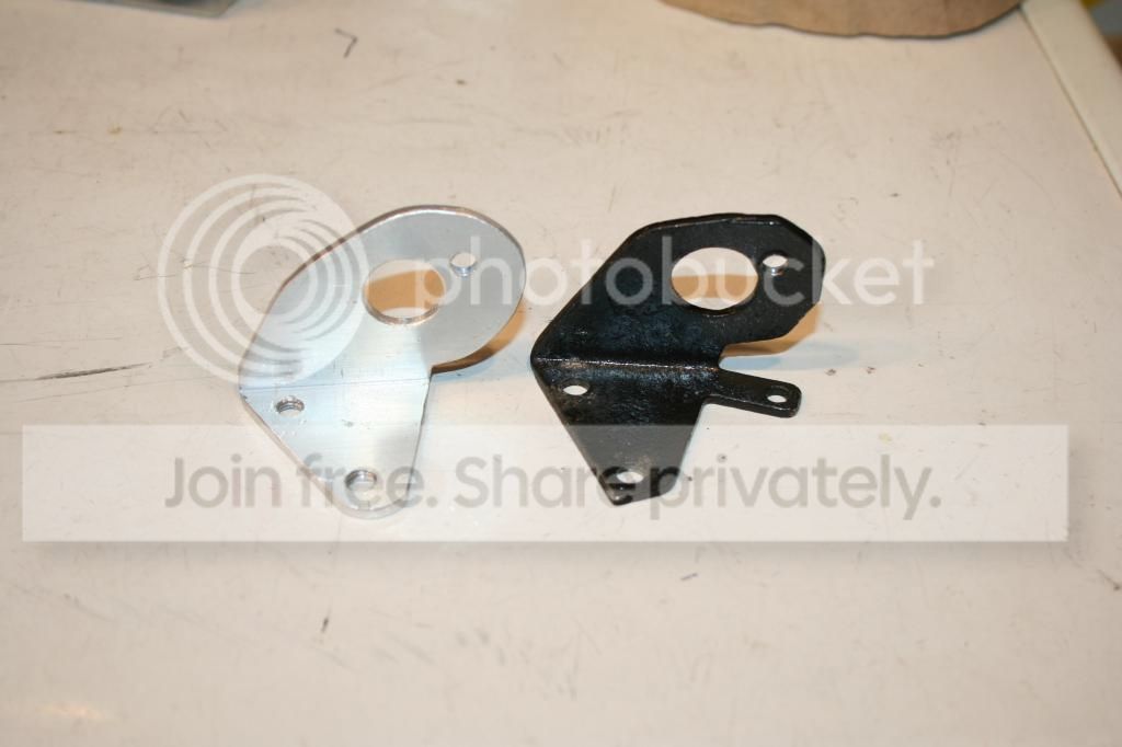

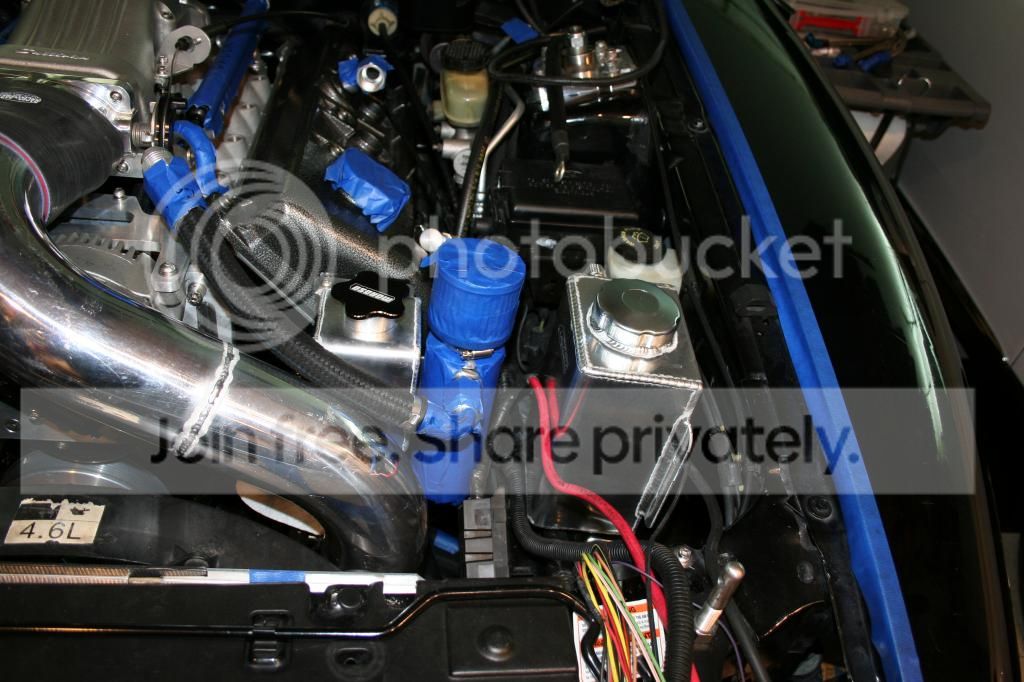

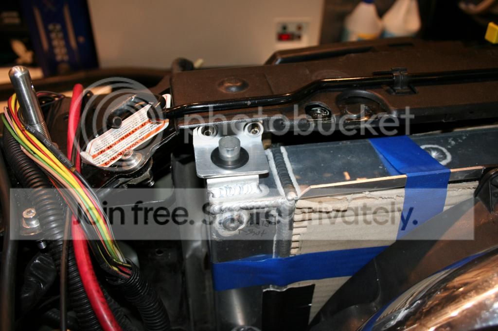

Made a bunch of brackets. I do not have a drill press or grinder. I could of purchased one but space is a premium and for the few brackets I needed may have not been worth it. These have bee done with a drill, cutoff wheel and hand files. Next up will be CAI and fuel lines.
Here is how everything looks. Not even going to think how much time I will need. Tackling one section at a time.

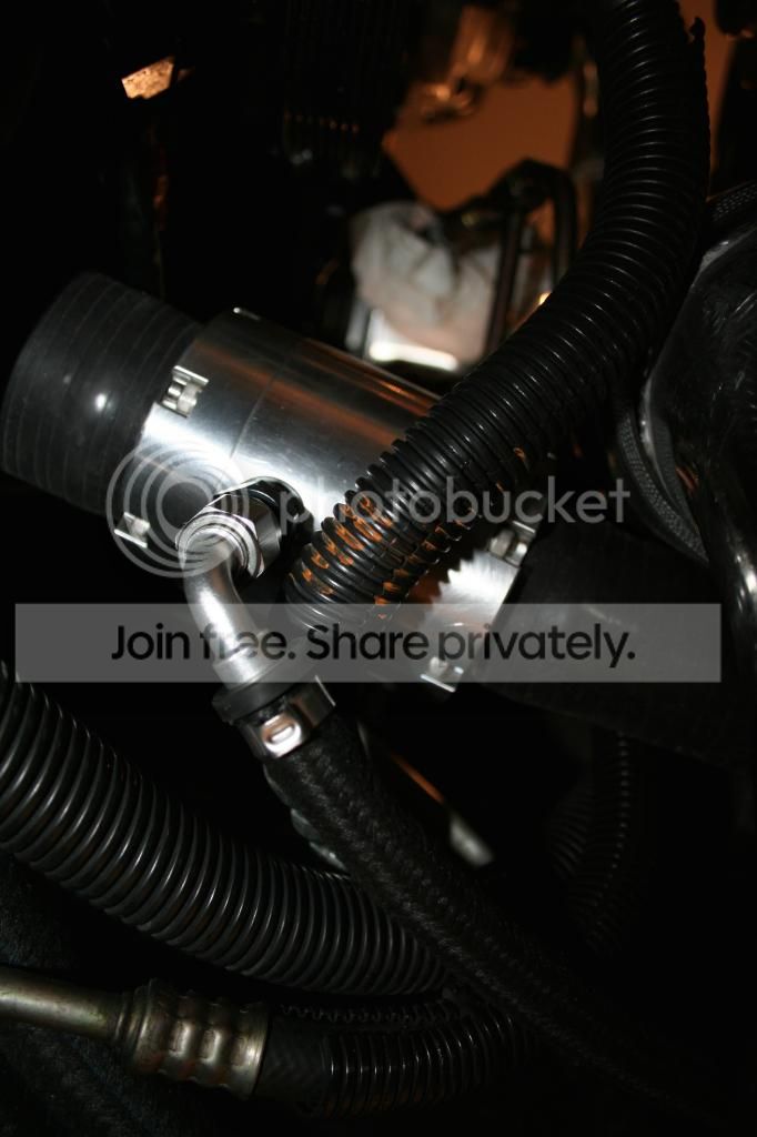

Passenger Catch can mounting on the SC bracket,line need to be extended to valve cover. You can see the inlet for the radiator
You can see the bracket I made. I had to cut the dowel and use a section of the original bracket to hold it down and against the rad support. This will give more clearance for an 4" home made power pipe.

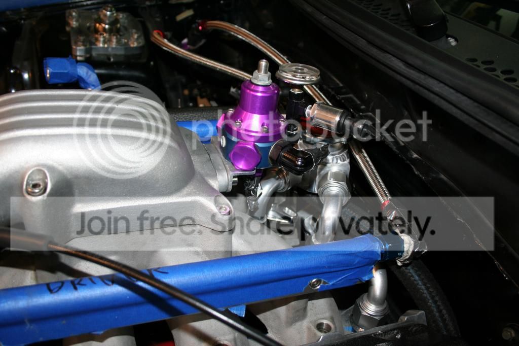

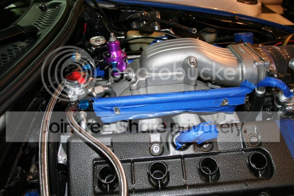

Fuel Pressure Regulator. I mounted everything in the back so all the line run under the intake to keep the clutter down.
Driver Catch Can. I need to extend the line to the valve cover.
Here is the bracket for the driver side. The rubber grommets will allow flex.
I made this bracket as the one I had was steel.
Here is the throttle cable and FPR
Close up FPR
Radiator overflow,mock up
Another view.

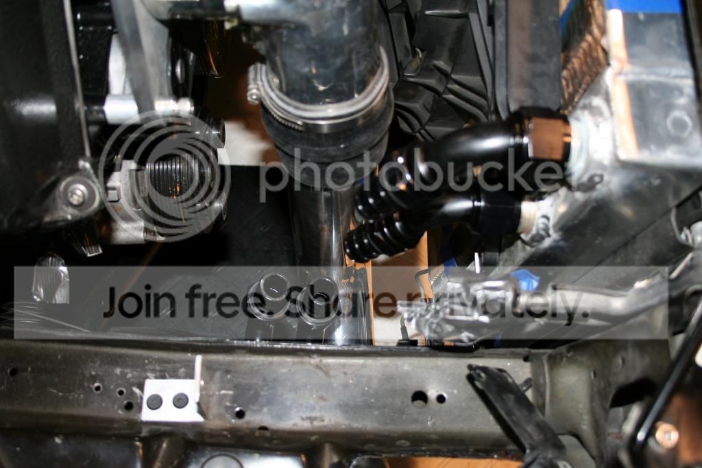

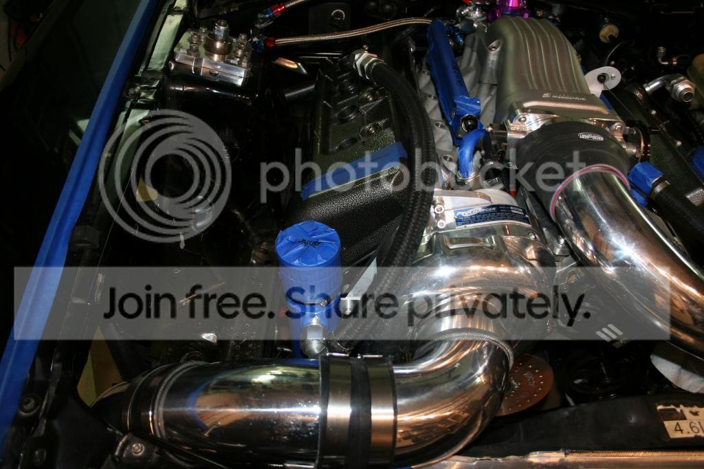

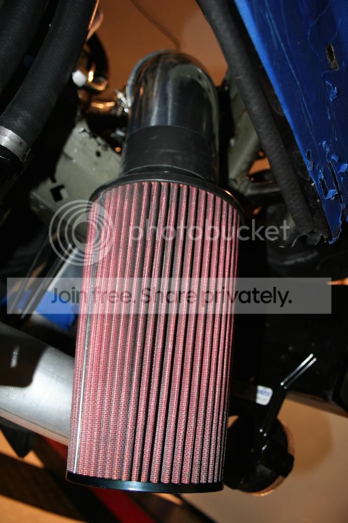

Thanks to all for the positive feedback. Today I made my own power pipe. The D1 has a 3.75 inlet and a power pipe uses a 4" pipe. I got two 45d and one 90. I did buy a 90d 3.75 to 4 coupler but I did not like the way it looked so I used IC piping instead. Not too sure if I am going to weld my home made power pipe as it is an extremely tight fit. I like the flexibility of being able to move pipes around. I can always weld them together however there is no pressure on these pipes since it does not see boost and will be doing it strictly on looks if anything but I like how it looks now. Ill be getting some panels from Scott Rod to cover the large hole. I will not be doing weld on but the aluminum panel.
I made one of the lines for the catch can. Hopefully it looks good once I make the drivers side one. I used a 3.5in to 4in coupler and cut ooff the 3.5 section. Since it flairs out it will fit.

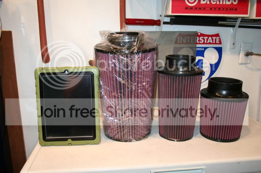

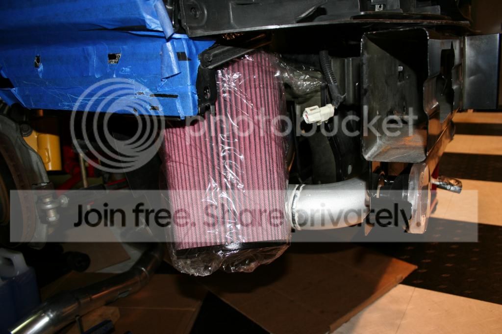

Test fit of filter. This is only 3.5 inches but using it as a guide to check for clearance. Will see if a larger one fits
once I test fit bumper
