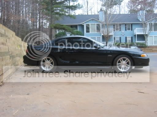

to lower my 94 gt i used the laurel mountain mustang springs that claimed to lower the car 2 inces front and rear! but i have seen alot of mustangs that have nor wheel gap in the front or rear! what kind of springs are you guys using? and what shock are you mating them with?
