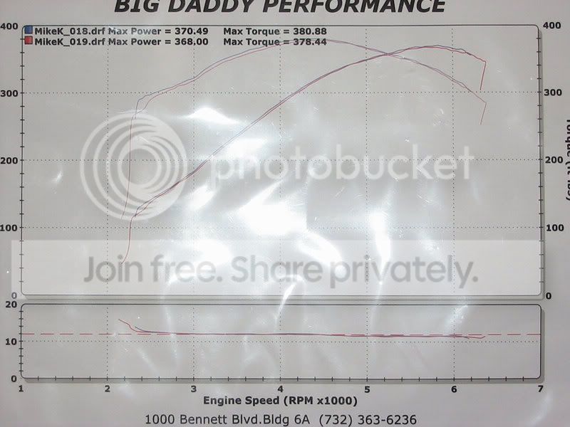

Just wanted to see if I was on pace with the mods done and what she actually puts down? Here are a list of mods with a brief description of the car. This can also help others out who always ask "what does it take to break 300/400/whatever hp".
1997 Mustang GT, Automatic
Vortech SQ Trim ( I see about 12psi)
3.12 pulley
MPH power pipe
Vortech mini race bypass valve
Paxton front mount intercooler
PI intake manifold
Crower stage II NPI blower cams (soon to come)
Accufab 70mm throttle body
Accufab plenum
SLP longtubes
SLP offroad x pipe
SLP loudmouth catback
K&N filter
Walbro 255lph intank pump
FRPP 42# injectors
SCT dyno tuned
Other factors:
4.10 gear
Built AODE
3500 torque converter
Roughly where do you think I should be?

Well the last sheet I have was before the PI cams. This sheet is with stock NON PI cams

Neat. Are you going to have the tune re-done with the cams?

yup, doing the cams, springs, retainers, degreeing them and getting one last tune for the car. Realistically I think I should see between 400-420rwhp/400+tq
