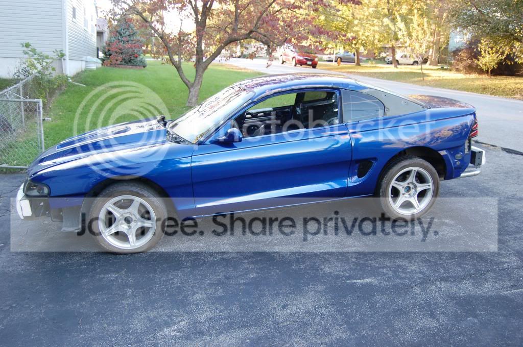

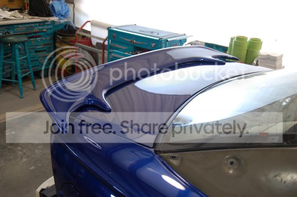

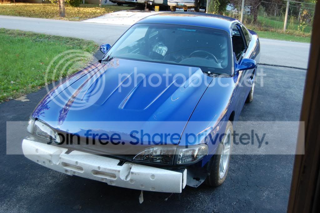

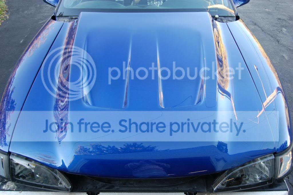

Here are a few pics of how it sits now! These are a week out of the paint booth, and this is before the car was wet sanded. I took the windows out, and replaced them afterwards. This shows the hood and spoiler, and when I was test fitting the bumpers. Test fit the headlight for pics, and these are the wheels I borrowed to roll the car around, but have chrome Saleen 18's.

Side shot with door handles shaved, should I lower it?? LOL. No weight in the rear, it looks like a 4-wheel drive!
Saleen Spoiler, it was on back order for almost a year, back when I ordered it!

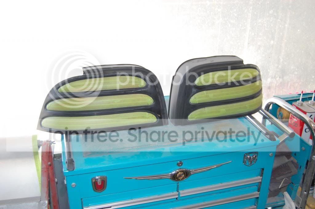

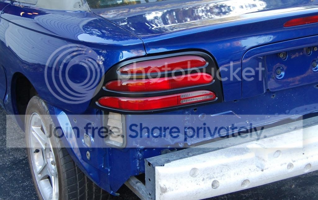

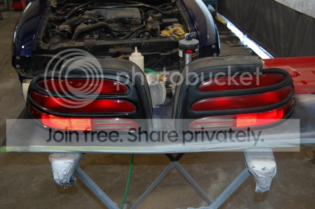

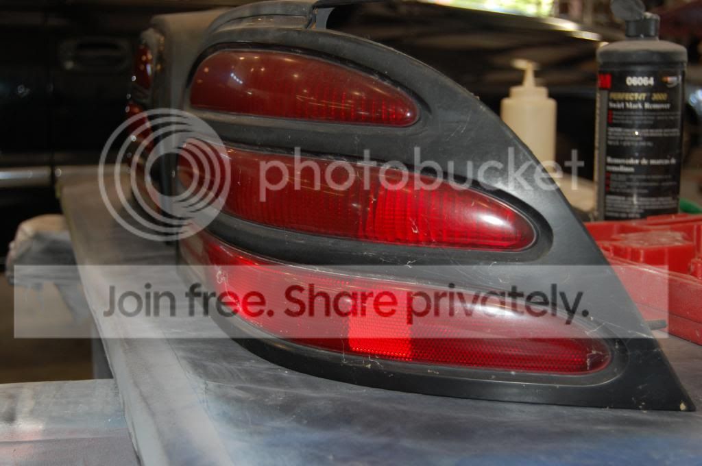

Polishing and restoring the taillights!
Before:
Left one sanded and polished:
Taped off and ready to repaint:
Painted and installed:
Much better!

Nice dude love the color I would have color matched the bezels tho , looks good

Thanks for the compliments, I have always liked the look on the Saleen cars, I know I don't have the bezels like the 94/95 Mustang taillights, but the matte finish black is good enough for me!
