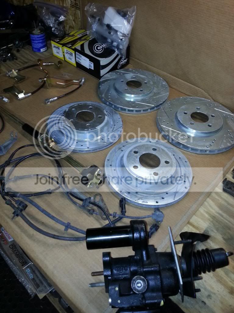

Okay, I know it has been a little while since I gave an update, been collecting parts! Here is are the brake parts, just waiting on the calipers to get back from the powder coater! I went with a 2004 Mach 1 steering rack, hydroboost unit, J&M stainless brake hoses (all 5) Hawk pads, and have the cobra brake set up on all four corners.
I will add some pics of the Hydroboost swap details, trials and errors soon, also I will post pics of the engine and the progress on it in a few minutes!

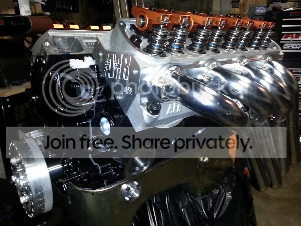

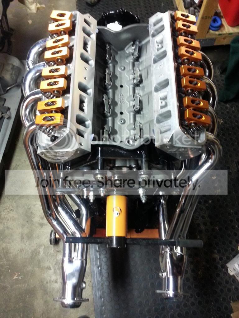

Here is the engine so far, Woody from Fordstrokers did a nice job, and we installed the ARP head studs, gaskets, heads, headers, with stage 8 bolts, link bar lifters and a few other pieces today. Check out the tapped oil pan :), and teh powdercoating on the timing cover! Thanks Jason from painted with powder, Jim and Nicole from Fordstrokers, and Doug from Total Mustang! Need a pushrod length checking tool and then tighten the harland sharps! The heads are AFR 205's worked over and done by Ed Curtis at FTI, same for the cam! He worked up the order and it resulted in a 613 lift! Holy $hit!

How many cubes did you have Woody build it as?
Had woody make it a 408!
Fcukin awesome man. That engine looks like a beast lol.
What kinda numbers are you shootin for?
I would like to see 550 na at the wheels! I know woody made a beast of an engine, thanks and Ed Curtis has done a few combos for friends, and they always did better than we predicted so we will see!
I got the firewall cut to fit the hydroboost unit, the 04 Mach 1 pedals are in with a UPR clutch triple fork and the Bullitt pedal covers, they were a ***** to get on, thanks for the advice (American Muscle Video) was a lifesaver, basically boil the pedal covers in water, put on gloves and start wrestling! They are worth it though. I am waiting on the water pump, pushrods, and then I can adjust the rockers, and install the lower intake!
On the Hydroboost, I have found a ton of threads from various websites, Corral had a huge one, that was a big help. I have the firewall cleared for the hydroboost unit, the master cylinder has the lines going to the proportioning valve on the bottom instead of the side like the factory 95, so I have even more room next to the engine. I will flare them and install them this week. I purchased a new proportioning valve from Latemodel, it looks great. One note is there are two different M.C.'s. The one with ABS and Traction Control has a 1-1/16 bore, and the one without ABS and T.C. is only a 11/16th bore, I went with the bigger one! More or less matched what came with the unit off of the Mach one.
