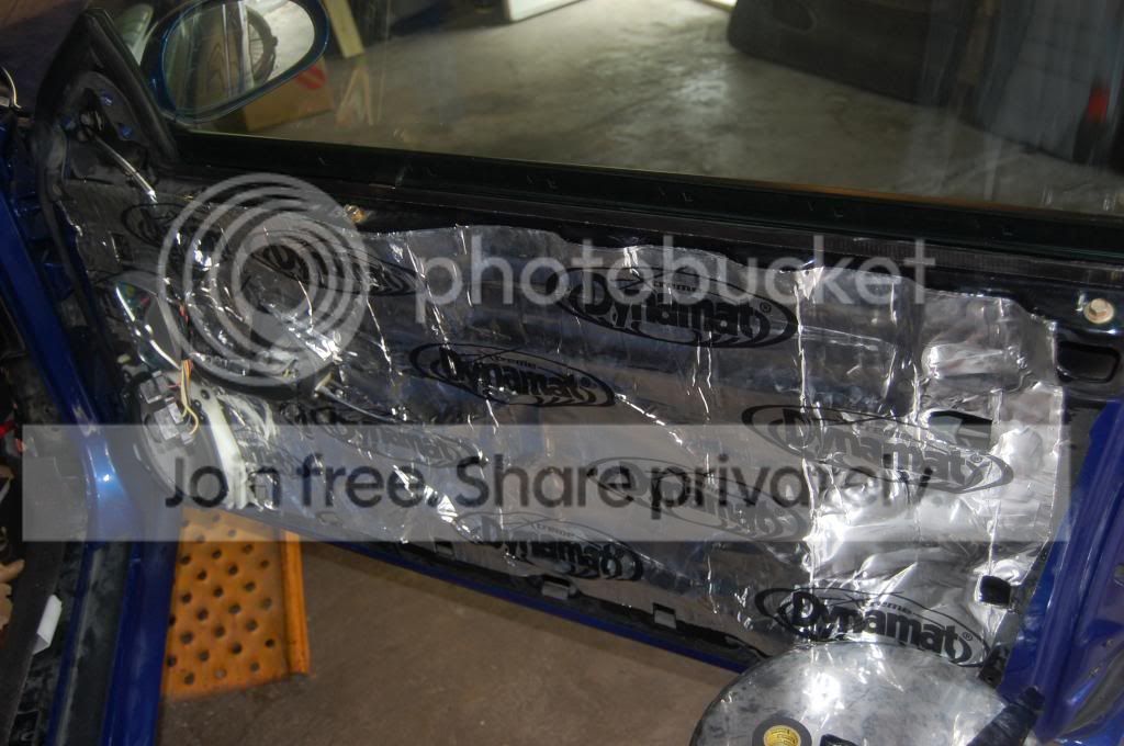

Dynamat on the doors, Installed Kappa perfects components, crossovers, etc. rewired them from the console through the original door boot!

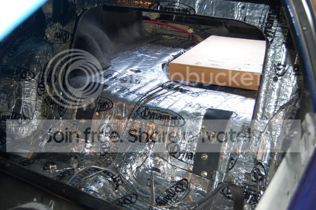

Dynamat in the rear area, and the Torque boxes installed:

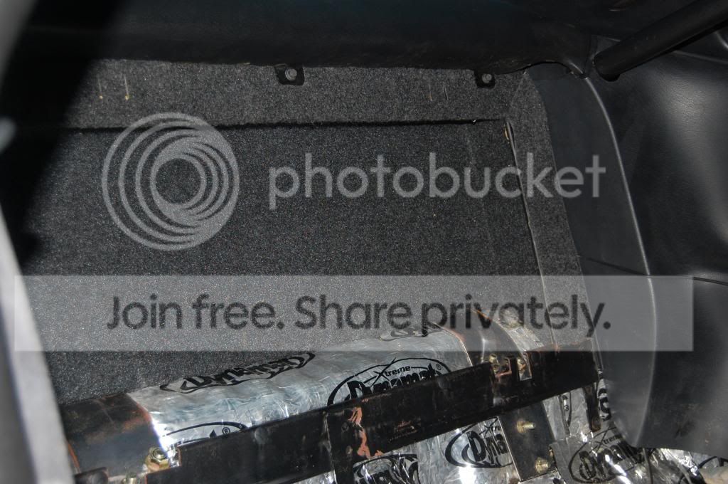

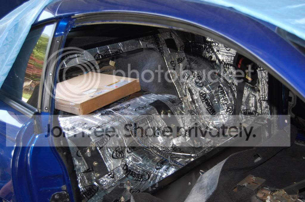

Installed the rear seat frame, cut it to clear the torque reinforcements, and made an amp rack carpeted to look factory, looks great in the trunk! You will never see the amps with the rear seat delete installed, and fans to remove heat on the top of the rack!
