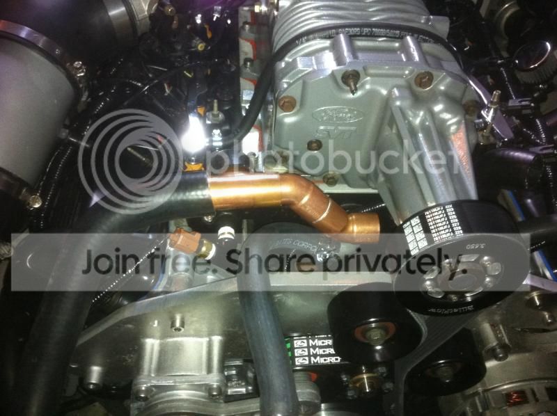

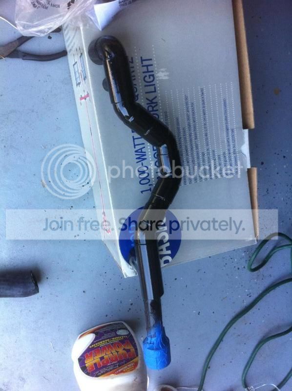

The coolant cross over they can provide for 100 bucks is god awful ugly and sticks out. I got this idea from TobyNT over on SVTPerformance. Fabricated a coolant cross over out of copper. Also learned how to solder copper.

Nice man. I like that copper crossover. I usually just make them out of aluminum . This should be alot of fun dude
