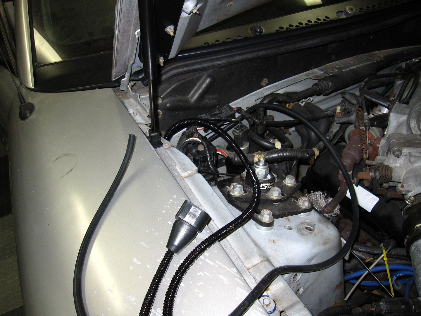

Okay, did some more work today/tonight. Actually, I hit a really big milestone. I got the new battery wired up, finally. I haven't connected the cables yet and actually put power through them, I need to do some double checking first. But all the wires are in place and should be good to go.
Here is the jumper bracket in place:
And with both the ground and battery cables wired up (I used the existing ground cable, cut the battery terminal off and crimped on an eyelet, and ran an extra ground cable from the jumper to the driver side strut tower):
So this may not seem like it, but this is a Big Deal. It's one of those "this is holding up a LOT of other things from getting done" type of things...that is now done. I know it doesn't seem very exciting, but I'm pretty stoked.

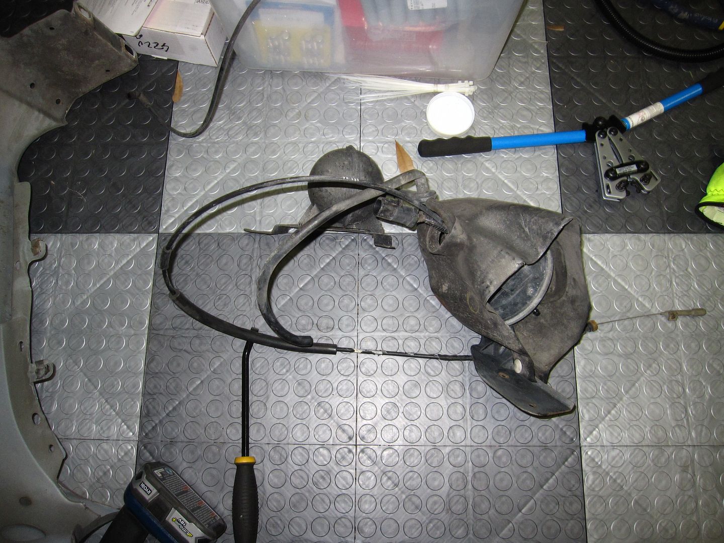

While I had the driver side fender off, I also decided to remove the cruise control:

While I was at it, I ran the passenger bank wideband cable through the firewall along with a silicon vacuum hose and my fan hi switch wire (not visible in the pic). When I go MegaSquirt, I will need to reference a vacuum source and route it to the ECU, so this is some planning ahead since I needed to run the wideband cable anyway. And let me tell you, it was a beotch :angry:

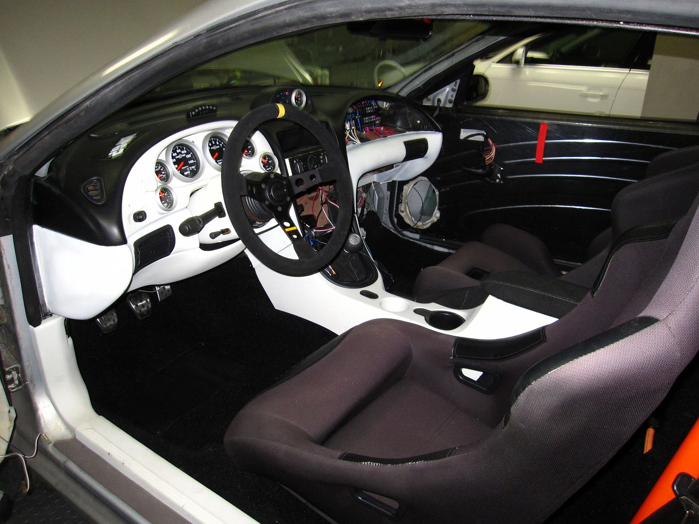

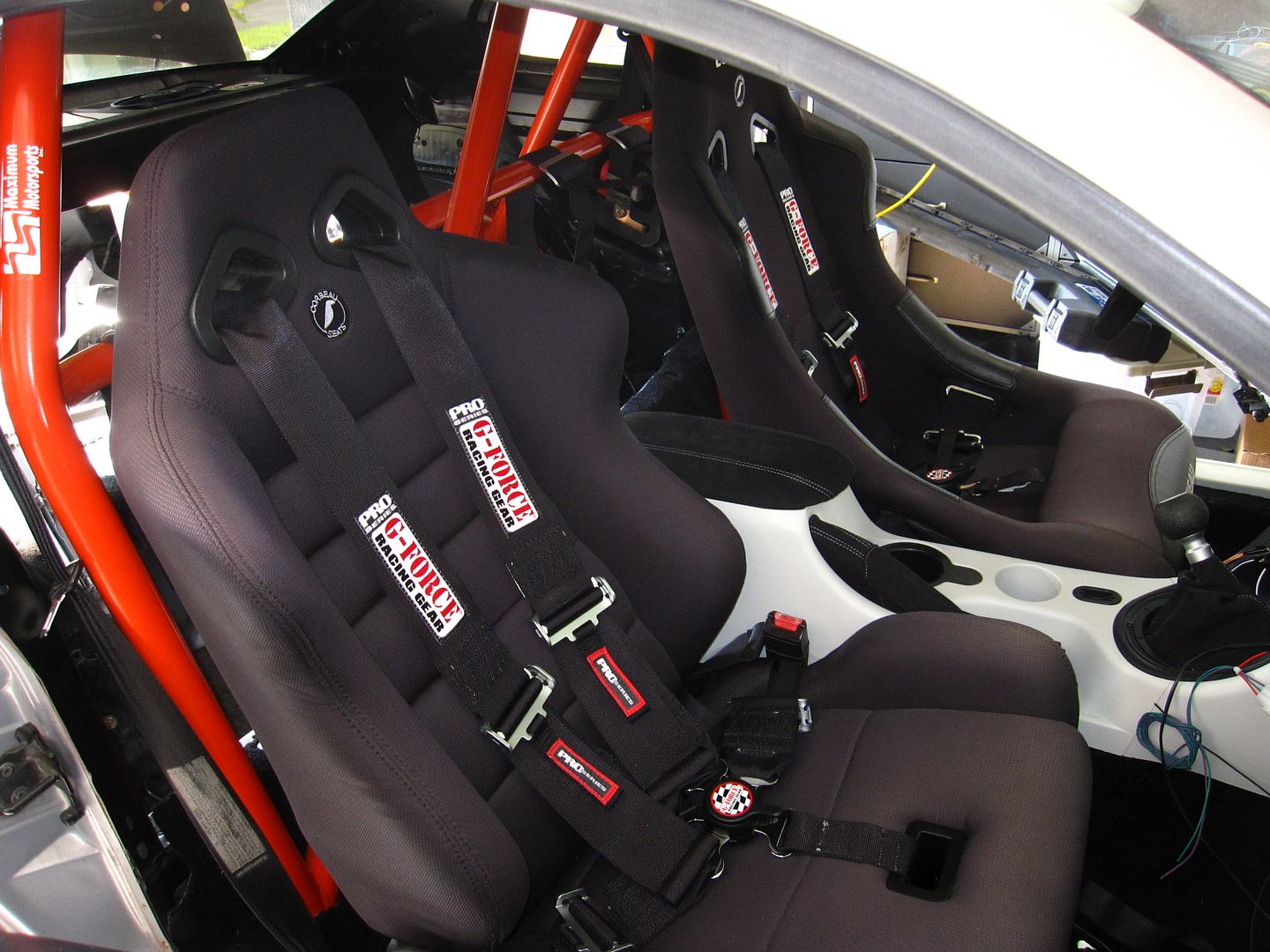

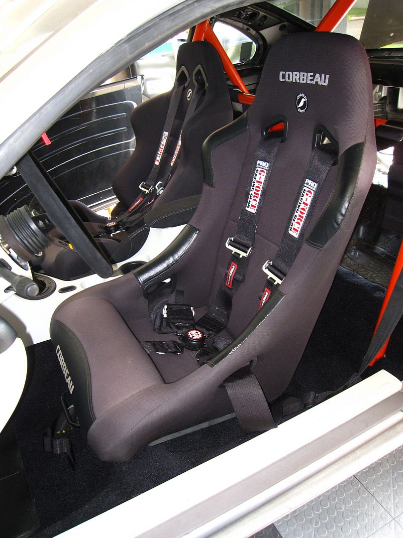

Small update, put the racing harnesses in the car. The shoulder straps will stay in the car; the lap belts and sub harness have snap clips on eye bolts for easy removal when I'm not racing (which is like never! :derp:). The normal seat belts are still functional, as I need to reach my sunglasses in the glove box. Obviously.
The Scott Rod rear seat delete aluminum panels will get riveted in after I get the tint on the rear window replaced. Not gonna lie, the interior is really starting to look damn good. It's not perfect, there's already scratches and stuff in the white paint on some of the interior trim. But for what this car is.....not bad, not too bad....

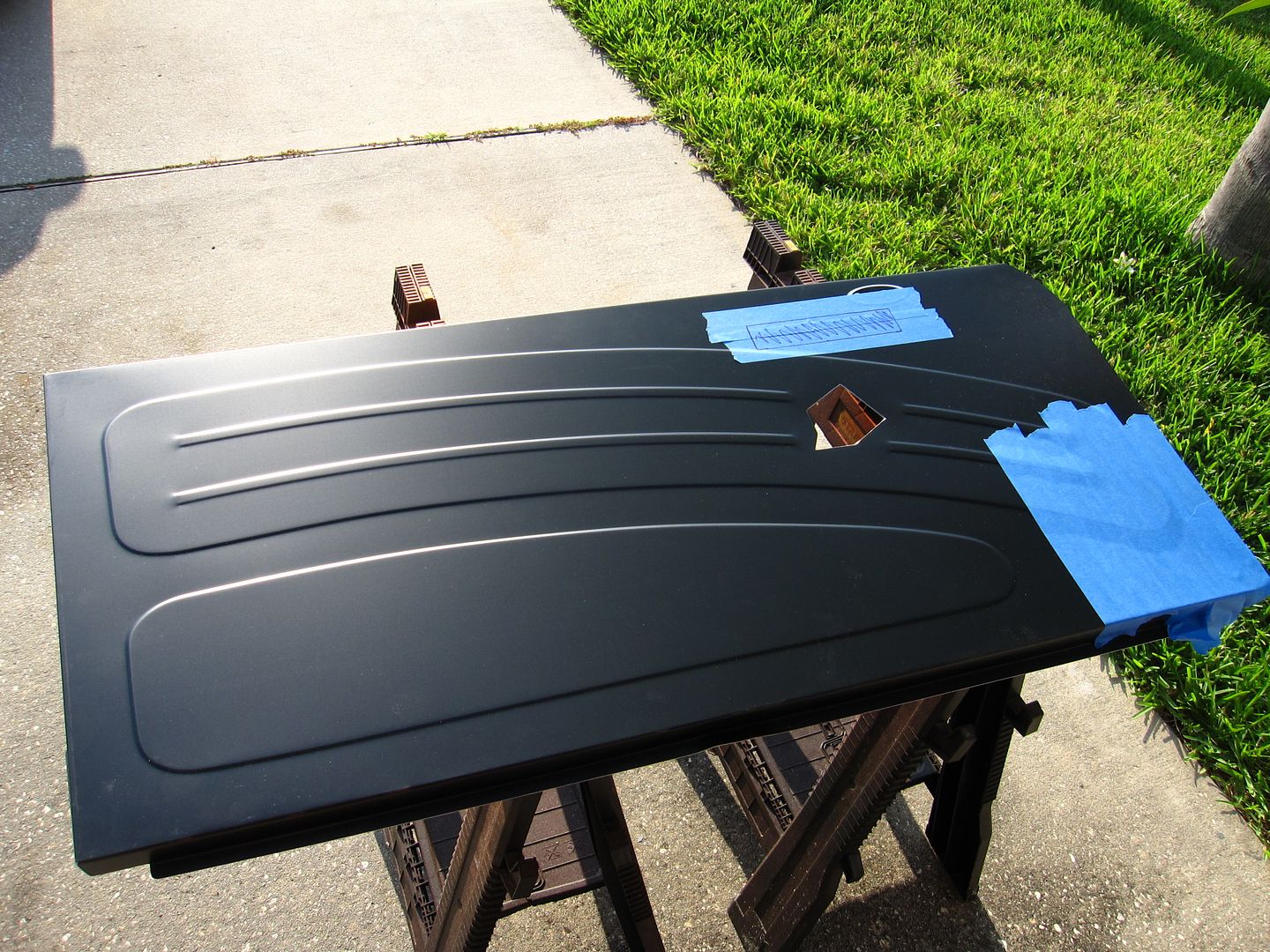

Also started working on the driver side door panel. This will be another HUGE milestone when it gets done. And seriously, it's a pain. In. The. Ass. Like fo realz.

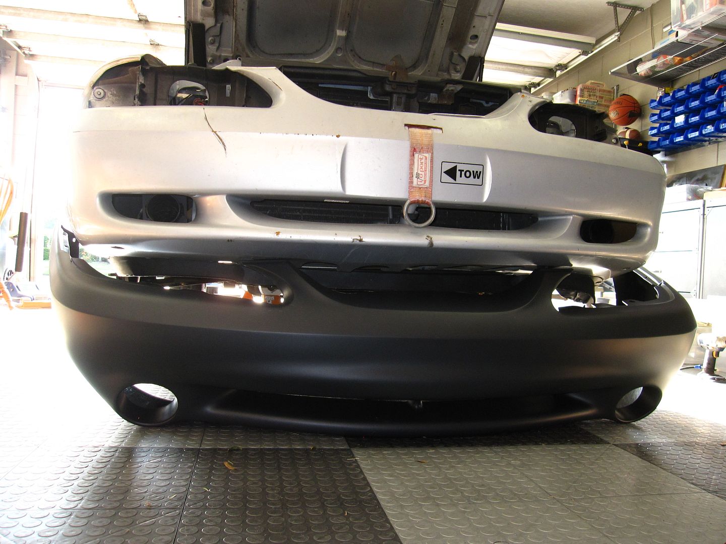

Aaaaaaaaaaaand the Cobra front bumper came in! :gasp:
Got a coupon from LMR for spending billions of dollars on the Cobra front bumper, so I'll use it to knock a couple bucks off the millions I have to spend on a rear bumper. I'll order that in a couple days, we'll see if there's a memorial day deal first...

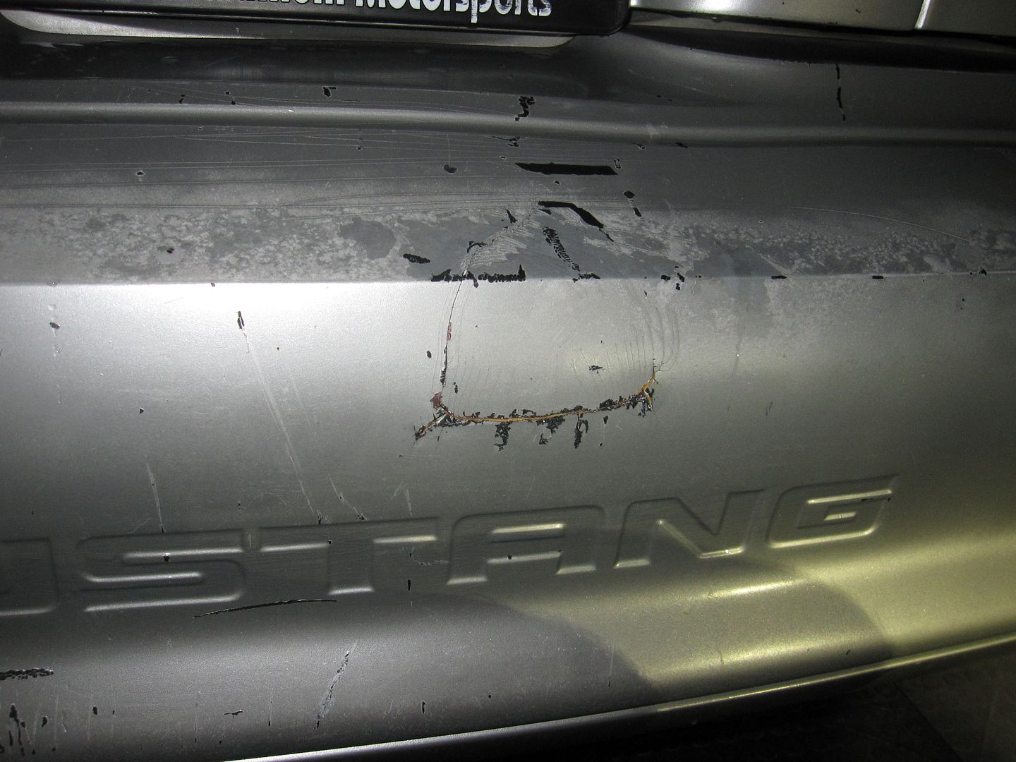

Whats' wrong with the rear bumper
It's got a sizable tear in it - looks like someone backed into a trailer hitch without first lower the connector part. It punched a flap into the bumper. I have made that flap "flush" with the bumper, but it's still there. And there's gouges and stuff. Things I'm not sure my cheapo Maaco job will really cover. Dunno, maybe I don't care. And when I bought this car, it actually had a hitch receiver thing on it, so that's probably exactly what had happened.
Disclaimer: clearly I know nothing about trailers, as evidenced by my trailer terminology in the above paragraph.
Edit: found a pic of it...
