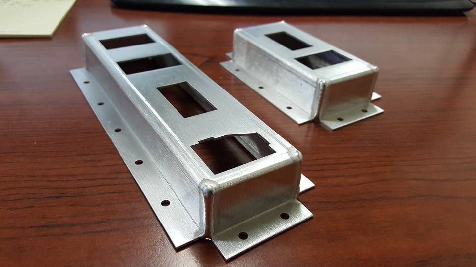

...AND WELDED!!!!! These look great, they will be shipped and in my hands soon...

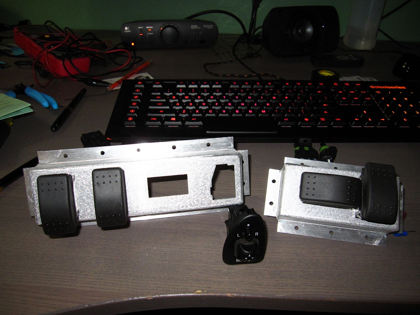

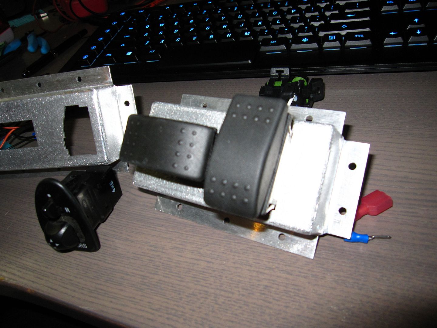

I started working on the switches for the power door locks and power windows last night. Due to their height, I have to solder on the wires to the terminals and then use spade connectors to hook them into the car's harness - this will make more sense after I post up some pics, which I should get around to tonight. The real excitement will be tomorrow evening after the stand-off things arrive and I can populate them with the switches.

I also started wiring up the switches to the car's harnesses. Ford was very, very clever when they designed the power window and power door lock circuits. Very clever. And, also very hard to modify. You need very special switches to make it work, a normal switch won't work with the stock circuits. Changes are required. Which I will get into later, both here and in this other post.
Here's the switches: there wasn't enough room for spade connectors, so I had to solder "pigtails" on them. I also used Weatherpak connectors. Because it's what I had. The little wires with the spade terminals are for the LED switch lighting. More on that laters.
Here's the factory harness, starting to get "modified" to accept my switches:
And hooked up...

Switch stand-off things arrived today, and they look fantastic!
The switches don't quite fit in their spots - on purpose. I had the holes cut a tad small to make sure I didn't accidently end up with a loose switch because the hole was too big. I will use my scroll saw and nibble away some aluminum in key spots and they will fit liiiiiiike a glovvvva!
BIG THANKS to [MENTION=21192]Jakespeeds[/MENTION] for doing this job for me - pretty much no one else would because it was such a small job. He and his guys nailed it, they look fantastic and I really appreciate their efforts! Cannot wait to get them painted and installed, they are going to look just absolutely tits.
