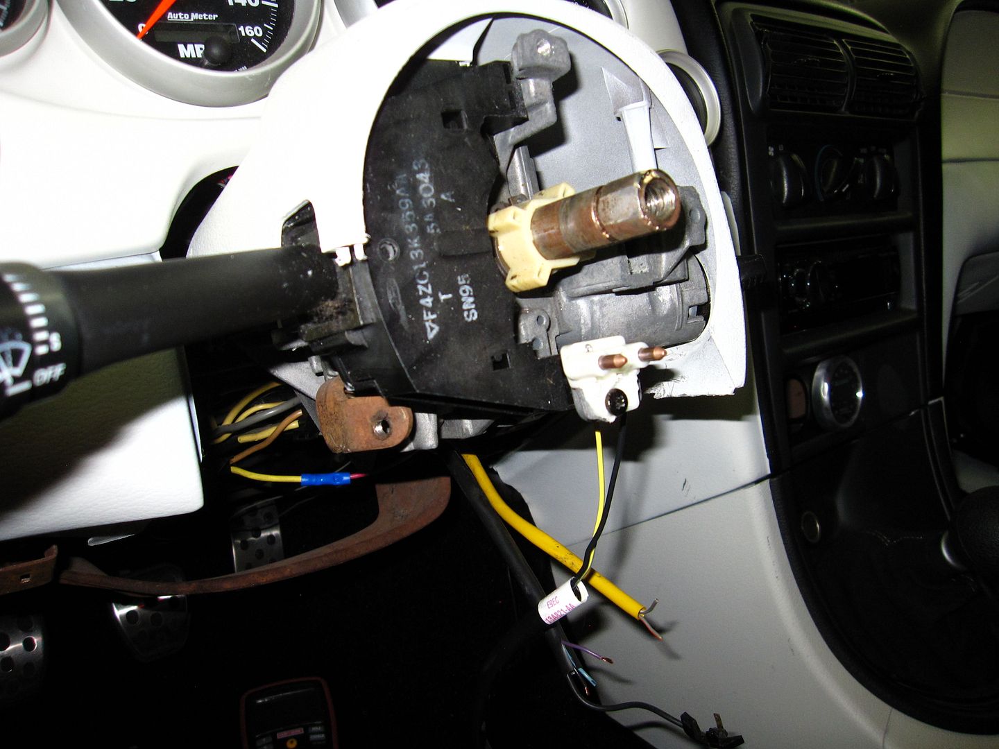

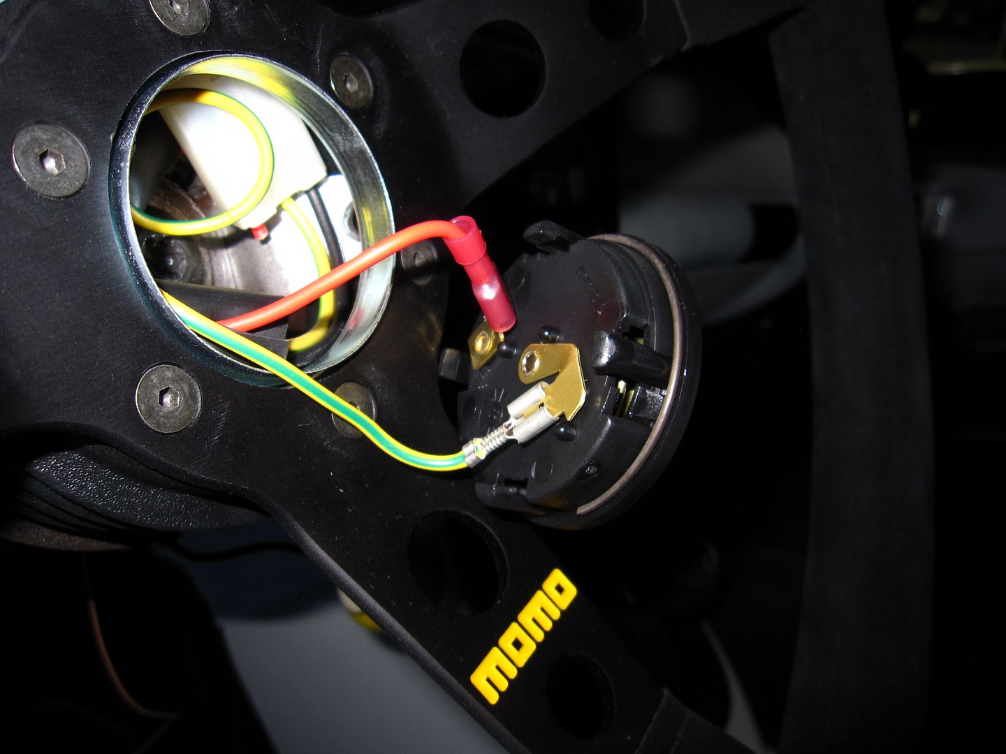

For starters, I wired up my horn button. This sounds trivial. Oh ho, does it sound trivial. But let me assure you, it is not. I've had an aftermarket wheel for a couple years now, and also a non-working horn button. Because no more clock spring. Well, in the process of installing my car alarm, I don't want to use a siren. I want to the alarm to use the car horn. So no choice but to figure it out. It ended up turning out pretty damn good. I created a write-up for it in case anyone else is interested: horn write-up.
Here's some pics though in case you don't care to see the other thread:
With that done, I moved on to making all the connections for the car alarm. So far, I have the door lock/unlock wired up and the door trigger monitor wired up. I still have the parking lights and some final installing to do, and then that's that. It's turning out rather well.
