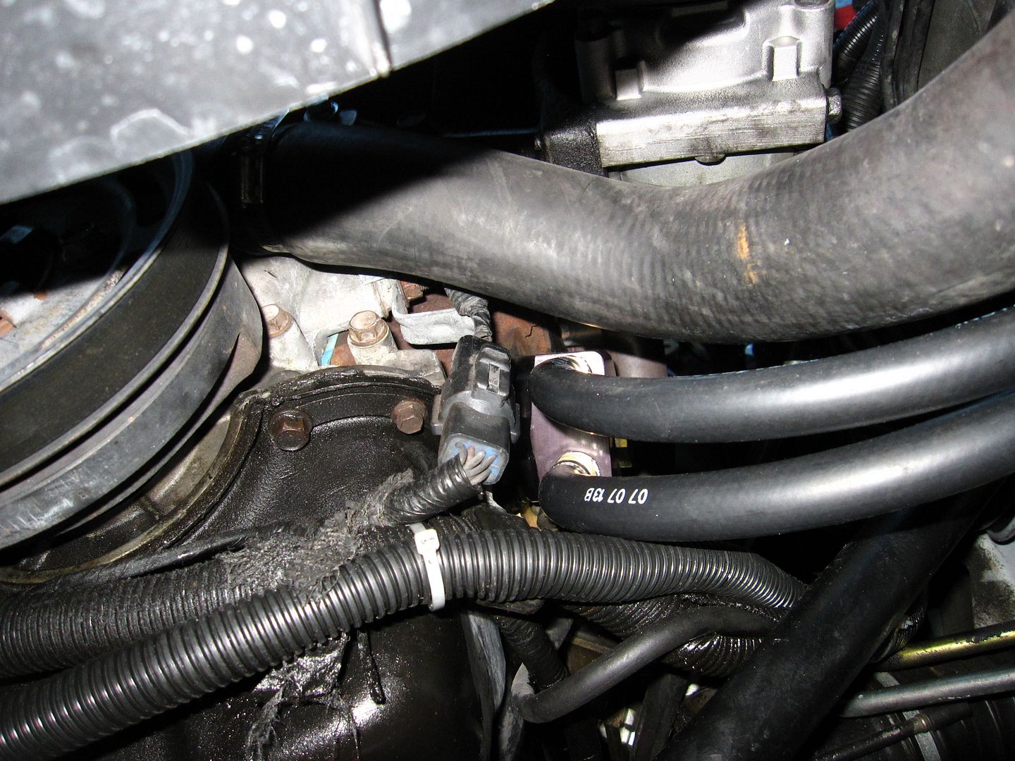

Do those brass adapters screw out? Might want to think about jic fittings instead. If not double clamp them things mang!
Looks good though i like how you think
Which brass fittings do you mean? The hose barbs, or the fittings for the senders? Both? They are brass NPT threaded. I used teflon tape (but not close to the bottom of the threads, don't want tape in the oil) and tightened them down to GAT specs (good and tight). They should not unscrew themselves, and hopefully won't leak.
What are JIC fittings?

Didnt realize they were pipe nipples, from the pic they look like those nipple you push a hose over then clamp it. JIC fittings are just flared fittings used for high pressure hydraulics. They never leak unless they get torn off.....but then anything would leak

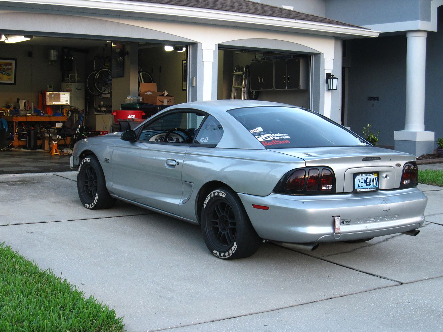

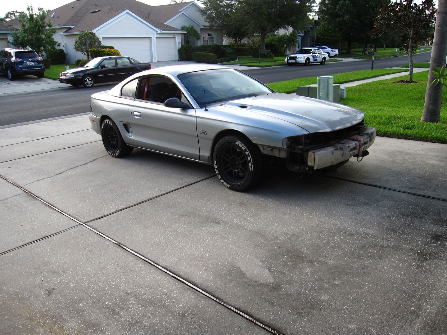

Okay. Let's play a game. I'm going to show you guys a picture. You then tell me what is missing from that picture. Here we go:
Eh? Ehhhhh? Do you (not) see it? Ehhhhhhh? YES! THAT'S RIGHT! THE CAR IS NOT THERE! Why is it not there you might be wondering? Because this happened:

So I left the car running, and checked for leaks and stuff, and there were none. No leaks so far. Which is fantastic. And full disclosure, before filming the attempt at starting, I did pull the fuel pump fuse and bumped the starter a couple times to get the oil circulated.
I drove the car for like 40 min all through the neighborhood. It was nice to be back behind the wheel again. And, perhaps surprisingly, the car was good. A little rough at first but sorted itself out pretty quickly. The trans is pretty hard to shift right now - getting into gear is pretty tough. I probably should replace the trans fluid. We'll see about that. The car is not done. There are still things to do. But it starts. And it drives. Now I just need to start getting some confidence back into it. :) I will close out this post with some pics.

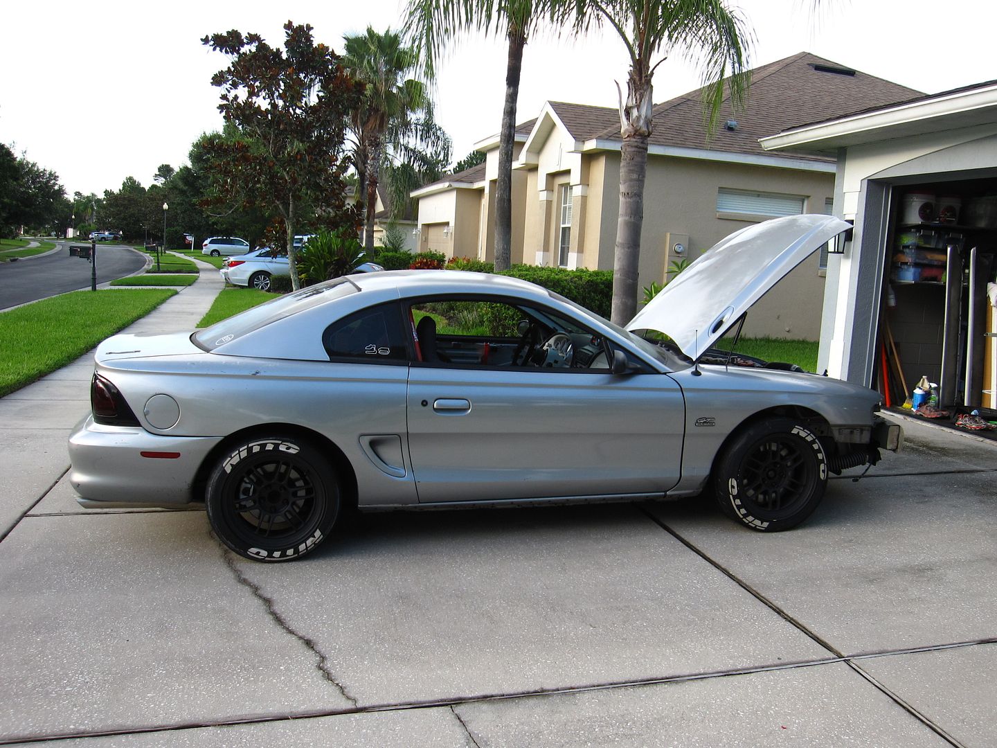

Some longer shots:
I took the side skirts off because they were sort of already falling off (I ordered new replacement clips), and because I will be getting the car painted and I want them painted separately off the car. Looking at these pics, though, I'm kind of digging the skirt-less look...
Here's the remote oil filter, installed. I still have some plastic wrap stuff to put on the hose to dress it up a bit - I'll do that later. I wanted to leave it off for now to make it easier to check for leaks:

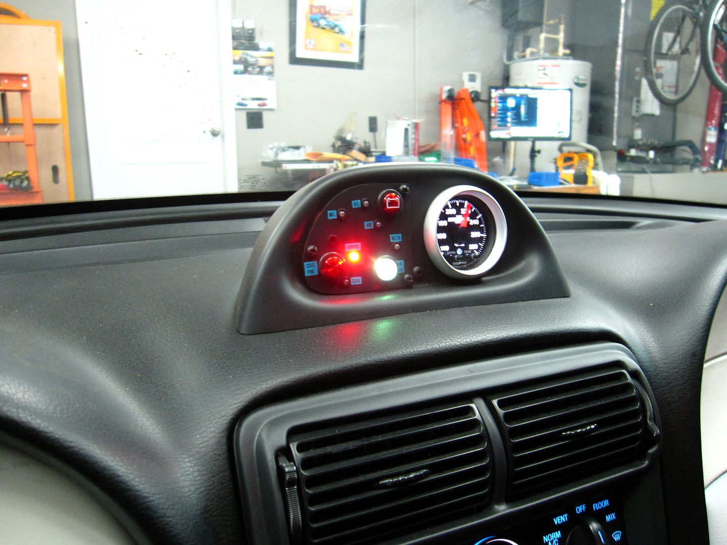

Here's a shot of the pod, with the oil temp gauge, working. The green light is the air bag (I haven't unhooked the module yet, I will get around to it - the light is not distracting) and the red LED is the eBrake that is on:

Friggin awesome dude. Looks awesome, sounds good. Im proud of you dude thats tits. And thoee hoses are the way i thought. Double clamp em when you get a chance. Ive seen them pop off at high rpm.
