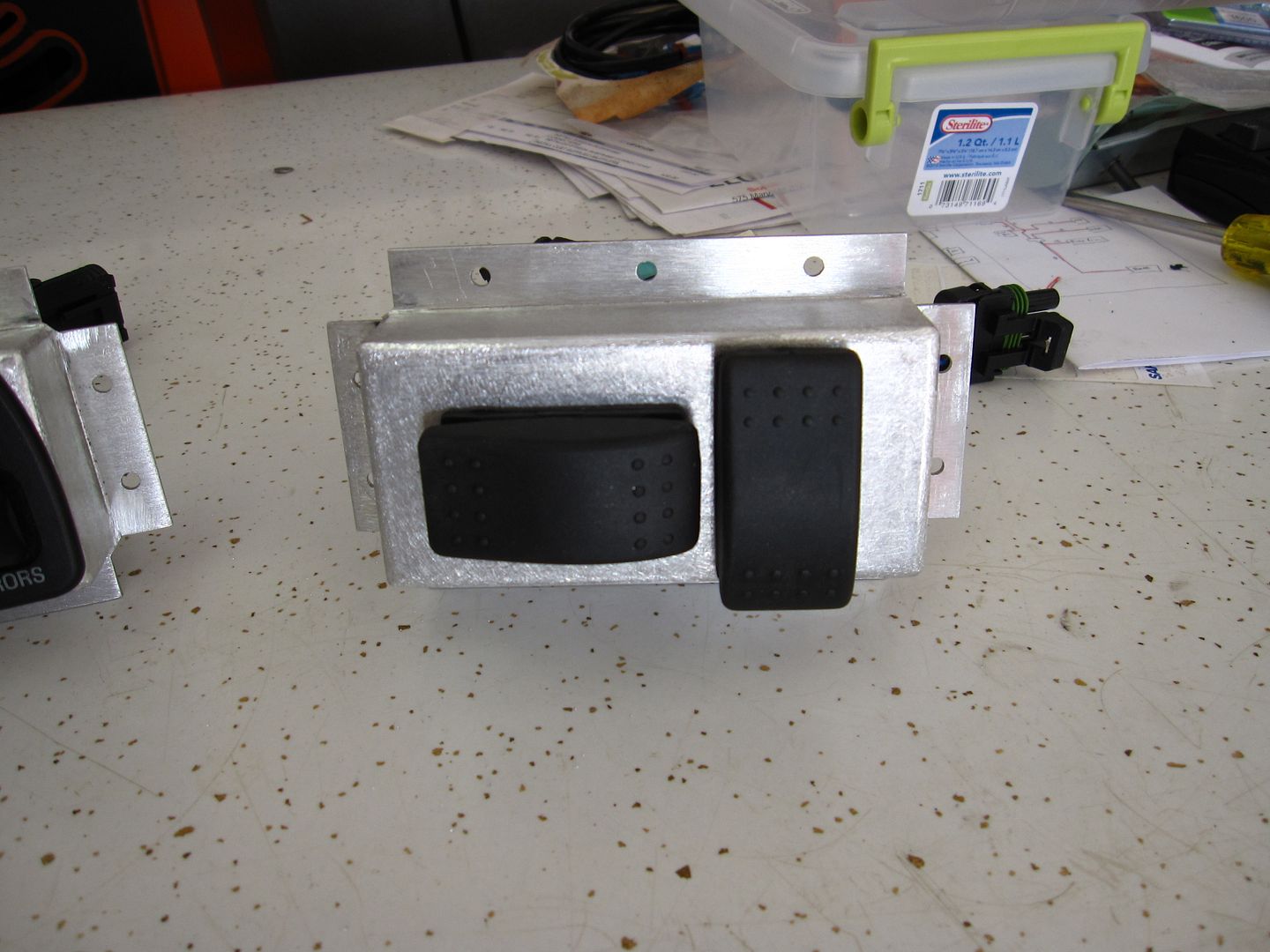

I've got some things coming in the mail for the Brake Issue, so I worked on some other stuffs instead.
Like these guys; on the left is the driver side stand-off, with (left to right) driver window switch, passenger window switch, door lock switch, and mirror adjuster switch; on the right is the passenger stand-off, with (left to right) door lock switch and passenger window switch:
I've got the passenger side stand-off done, and fitted up to the door panel (fixed with screws and nutserts, so I can remove it to service the switches if necessary):
Once they are both fitted up, I'll paint them black. You may notice in the bottom left corner of the previous picture, I also installed the speaker grill. I'm not sure I love the way it ended up, but it'll do for now.

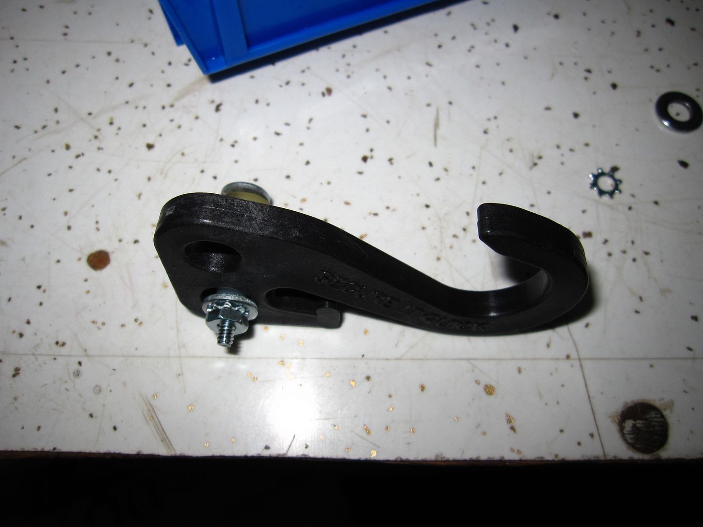

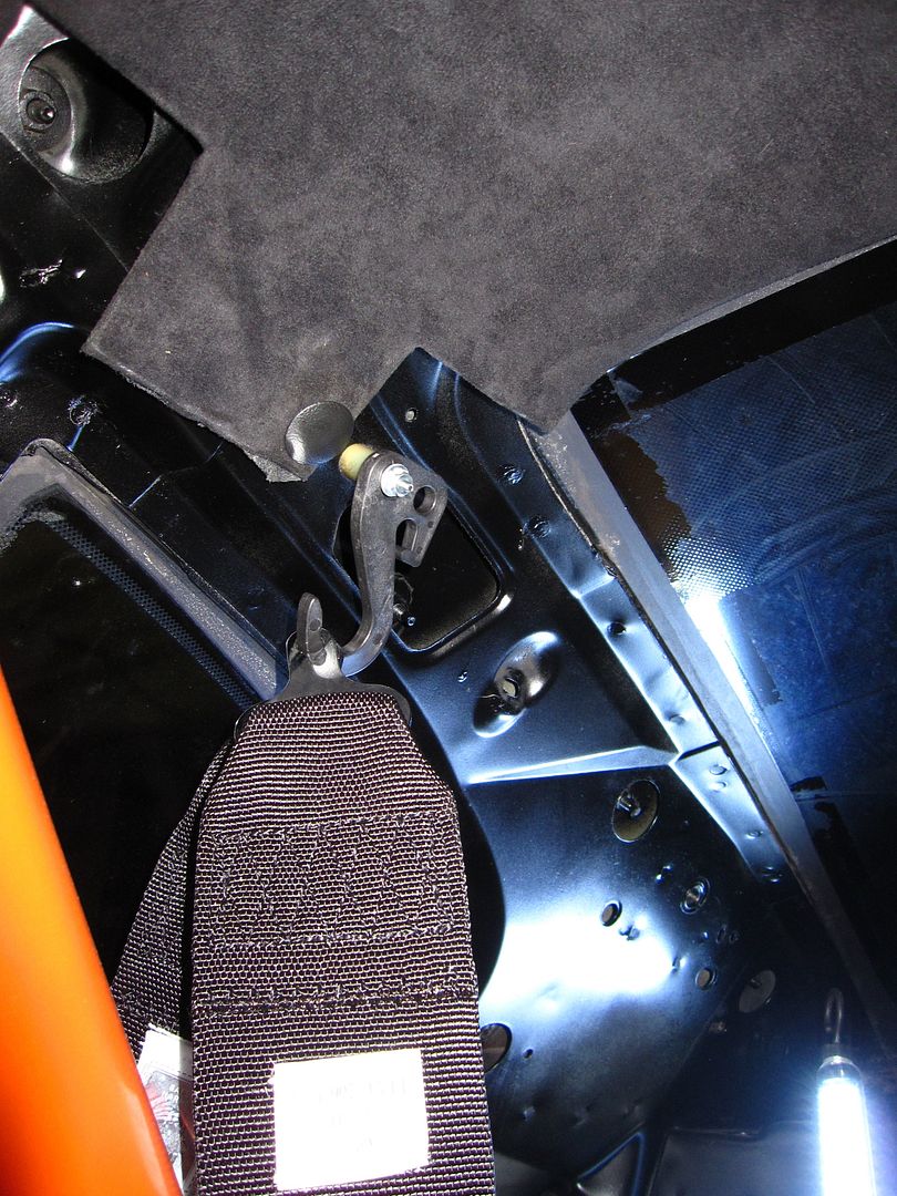

And, I started on this project:
Ehh? Ehhhhhhh? See what that is? Easily the most critical part of the build. Easily. BAM! INSTALLED!
DO YOU SEE WHAT IT IS FOOOOOOOOOR???
YES! It is for hanging of the shoulder racing harnesses when not in use! That way, they aren't just hanging down off the roll bar. I'll install one on the driver's side as well. It will keep the belts out of the way and off the floor. Like I said. Easily the most critical part of the entire build. Like I said.

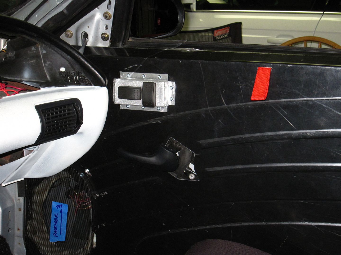

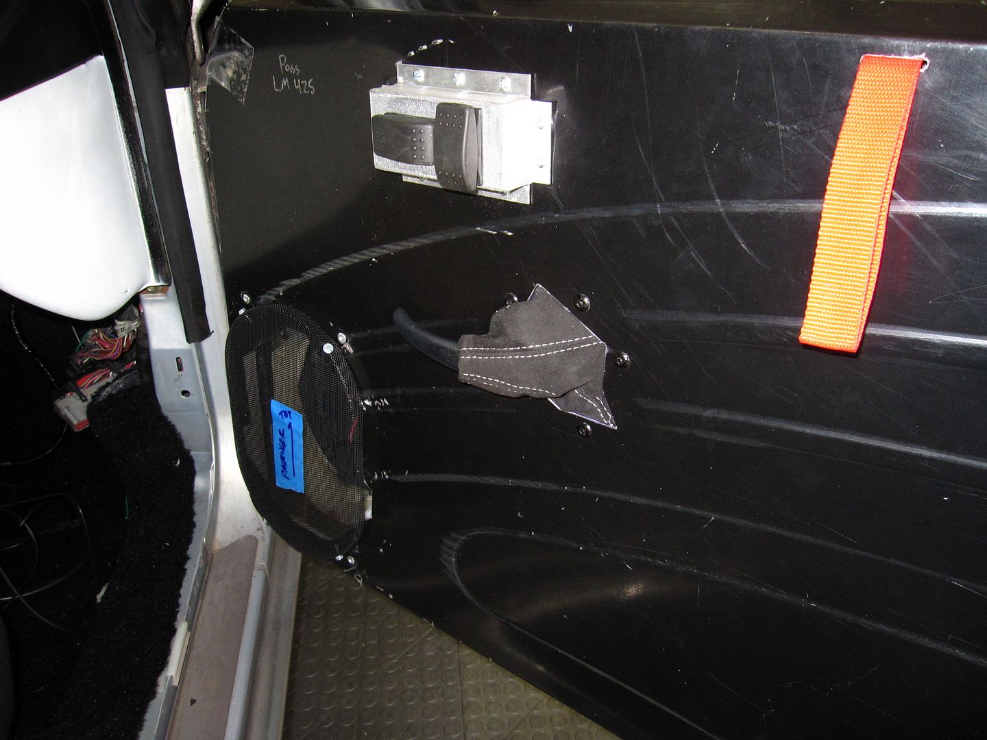

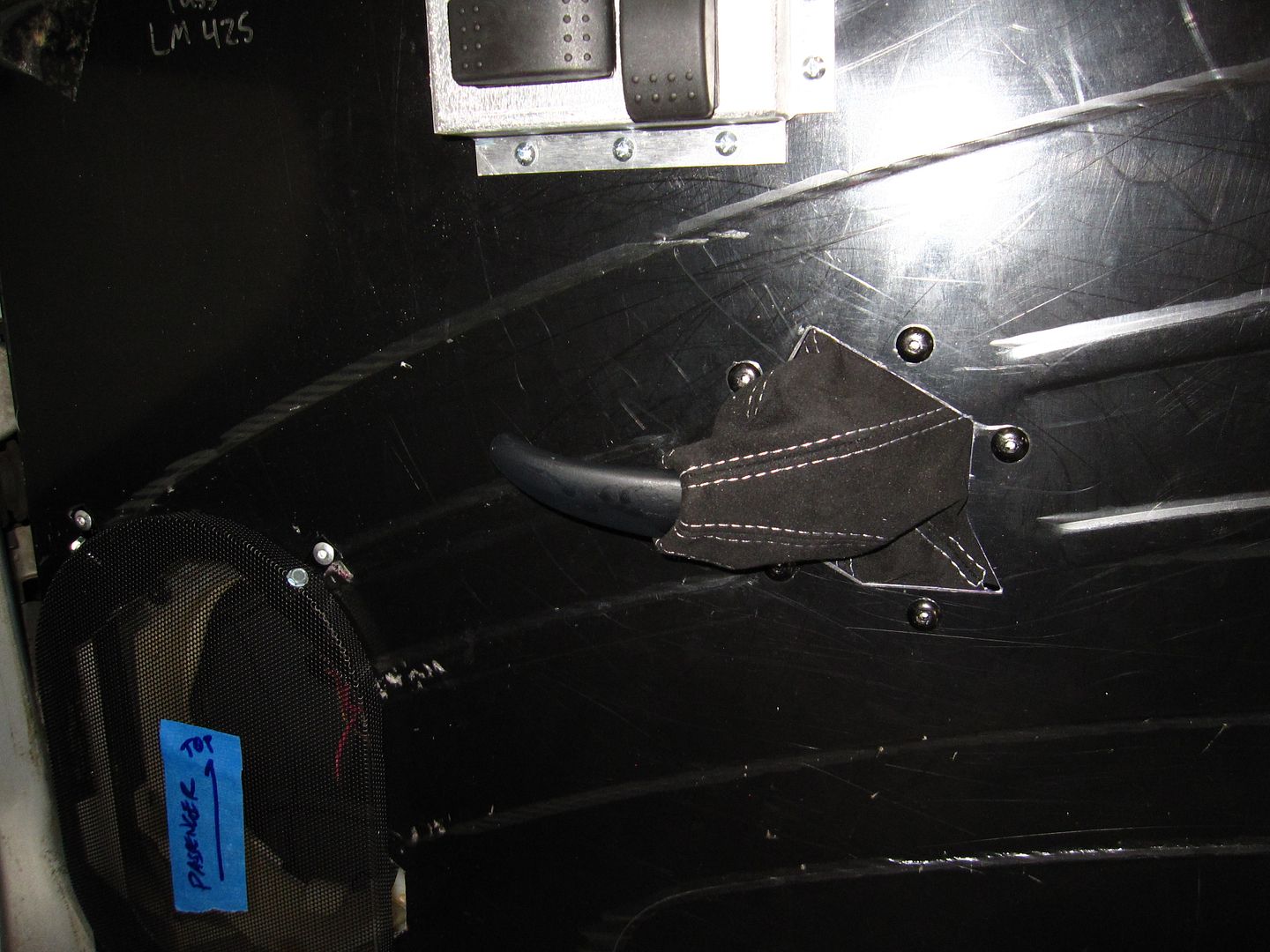

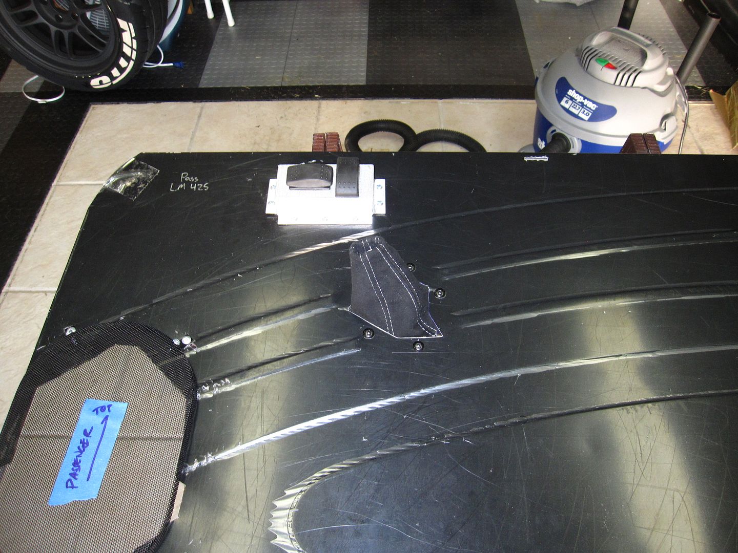

Did some more work tonight, specifically on the door panel. I got the boot thing for the handle installed. Wasn't too bad. I had to cut a bracket out of aluminum to rivet to, turned out pretty good I think, this now matches the arm rest, shift boot and ebrake boot:

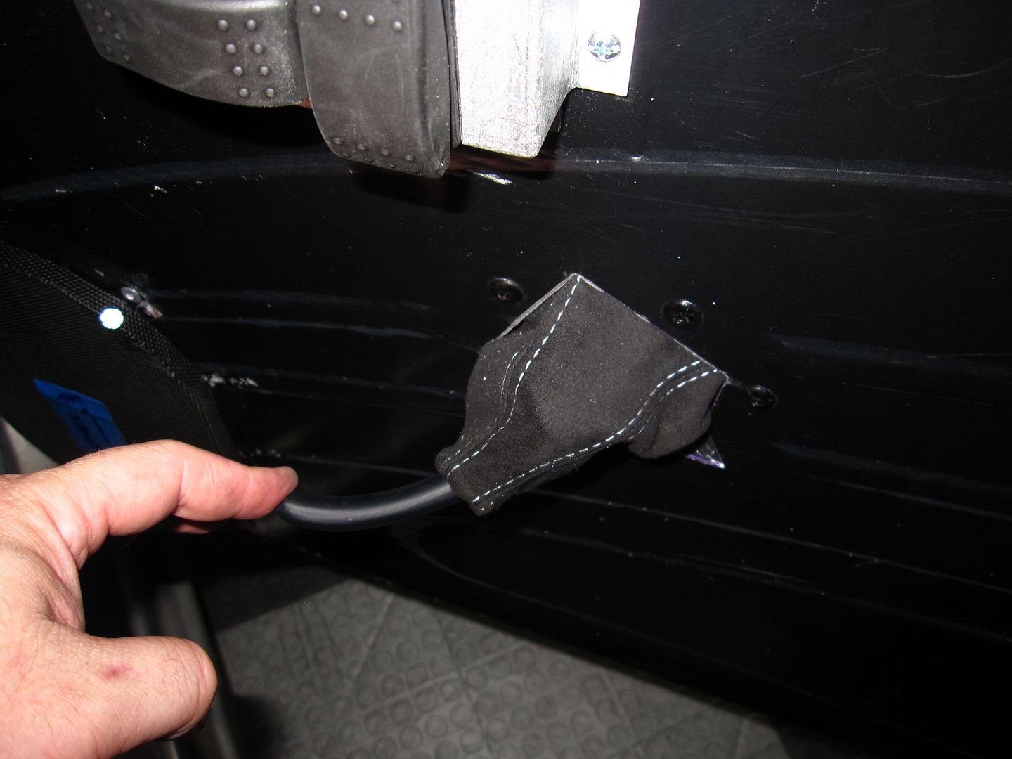

The handle has no problem being operated:
