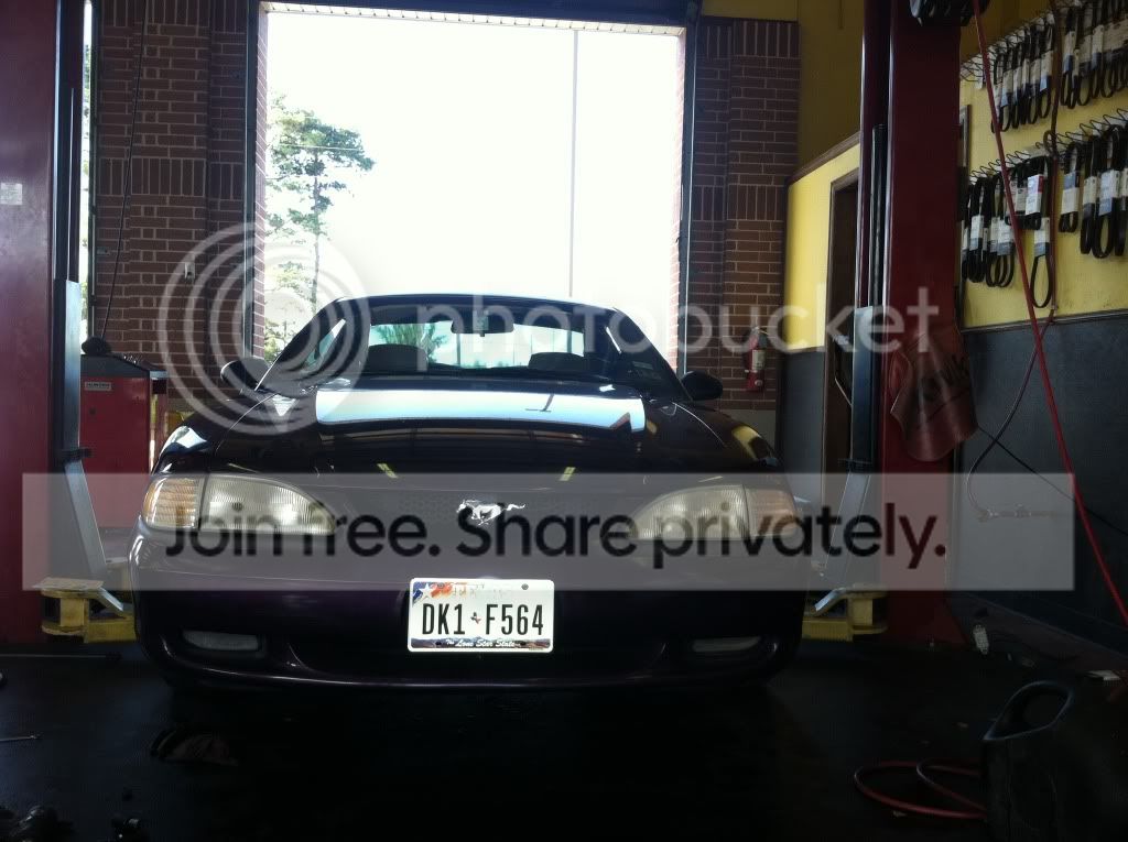

She was dropped off at the shop today :D year down begins tomorrow...purchased a new clutch kit for the billet cobra flywheel.

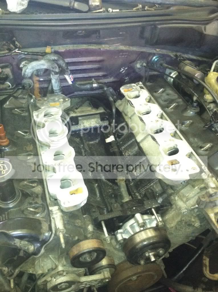

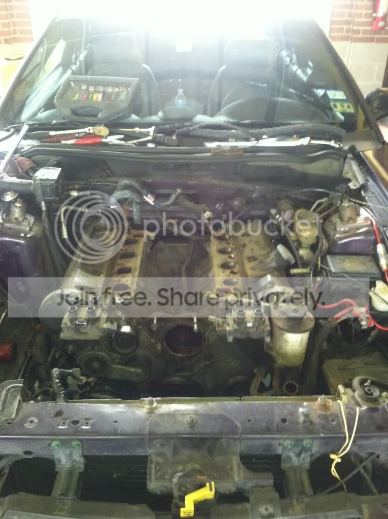

4.6 is about ready to be pulled

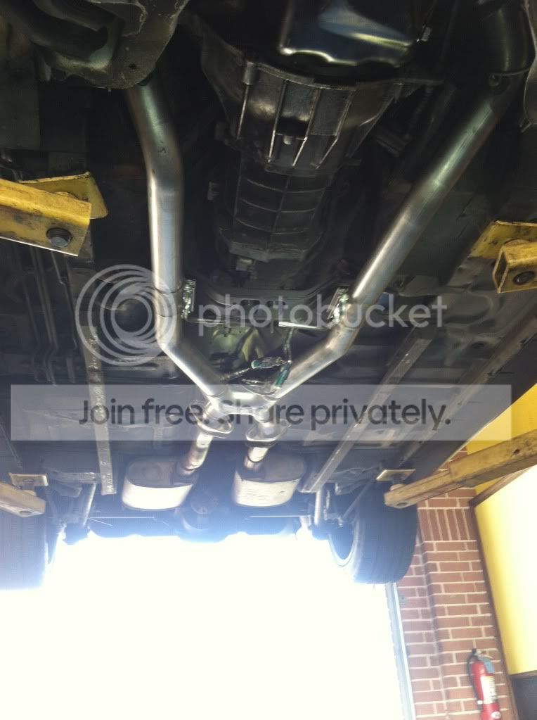

Always good to have access to a lift
Cobra aluminum flywheel with a resurfaced grip disc installed

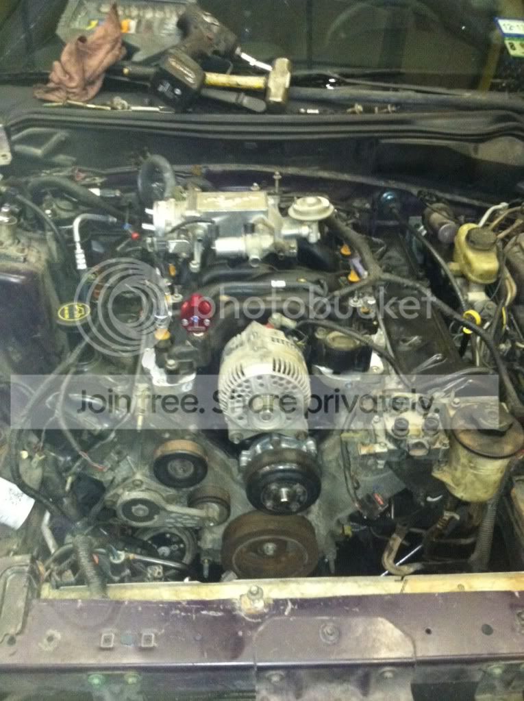

5.4 is now in
K member spacers are in now to work out the exhaust
