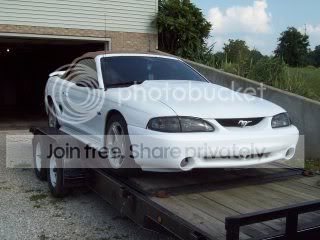

Well its been a long time coming but I finally have my baby back! I've had it back since last friday and it a whole different car. Final dyno number were 300rwhp, 296tq. Im looking for some new mufflers right now, longtubes and an x pipe make flowmaster 40's sound like crap. Thinking about some lm2's or a set of Dynomax bullets. We'll see what i can find. Here's how it turned out:
