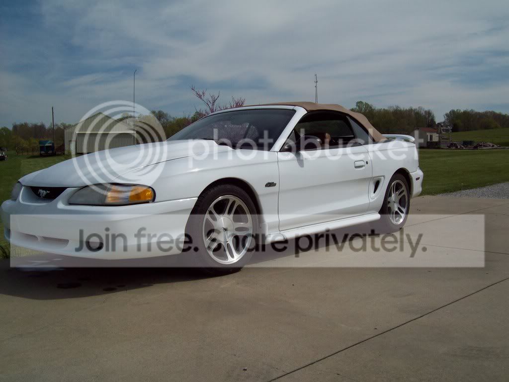

Welcome to my build thread. This is how my car looked when I found it
1997 GT Convertible, 101k miles, picked it up for 4k.
After some cleaning, a new top and a set of sportlines, I had a decent looking ride.

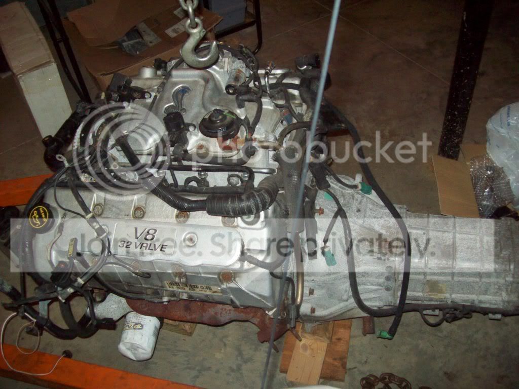

So now I had come to a crossroad, I could either replace all the internals and build this 2v, or upgrade. I chose to upgrade, and recently bought this:
46k miles, 01 cobra engine and trans

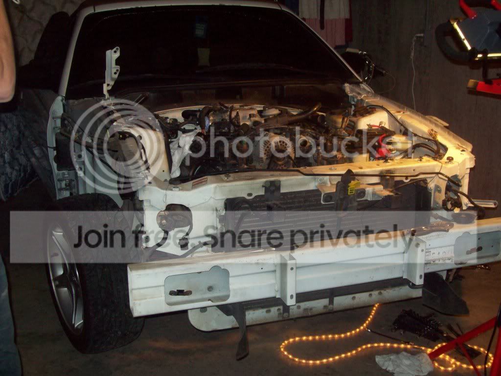

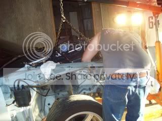

we removed the hood, fenders, frontbumper, inner fenderwells, radiator, overflow, drained the ac, dropped the exhaust, intake pipe, driveshaft, clutch cable, powersteering lines, yada yada

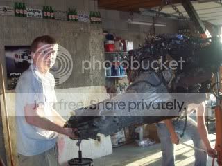

Next we rolled the hoist up, hooked the chain and pulled out the engine and trans
a shot of me, don't make fun
and a shot of me and my 2 buds that have been helping so far
We were really proud at this point, we're all 21 and this is the first motor we've ever pulled.
So this is where we sit right now
Im currently waiting for the ac delete pulley and k member to arrive. Then we can drop it in, button it up and make sure it'll run good. Then it'll get a set of underdrive pulleys, and im thinking i'll have the intake and valve covers powdercoated black. Thinking about the timing cover as well, but not sure yet. But a dyno tune will be first on the list. Thanks for looking, will update when something changes!
