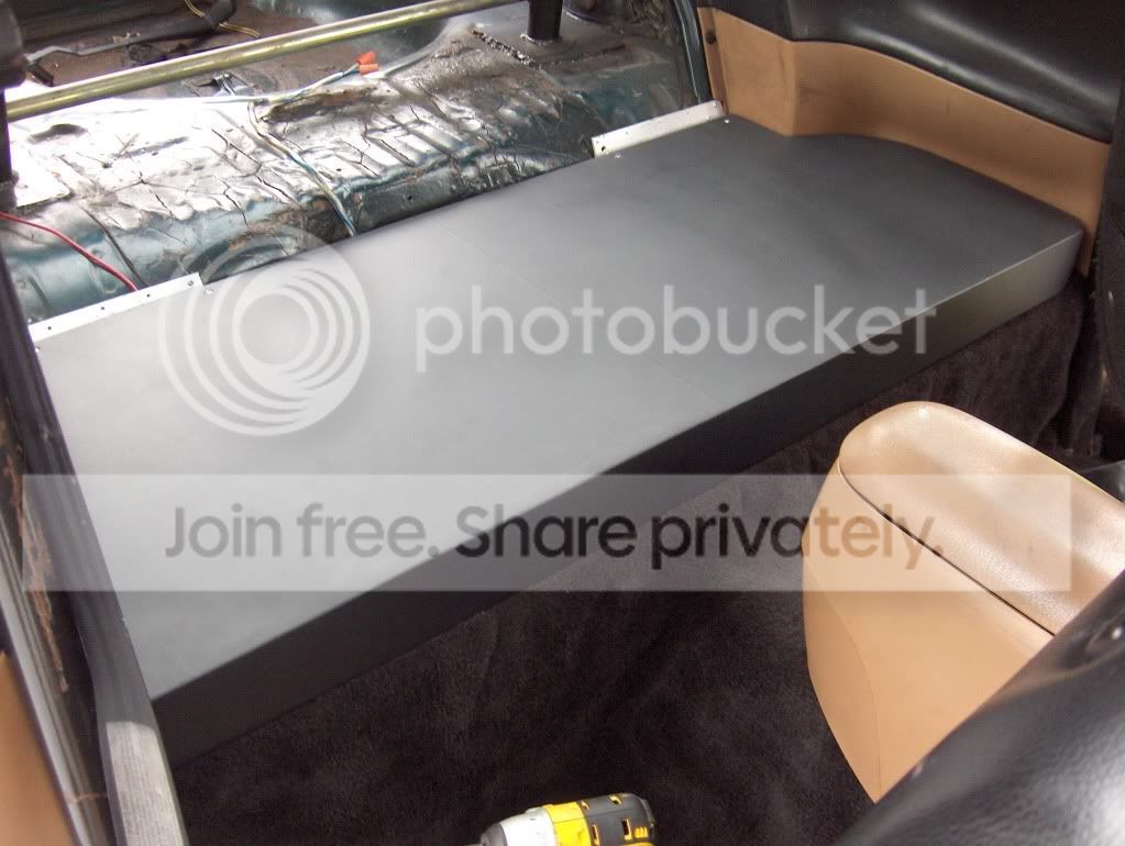

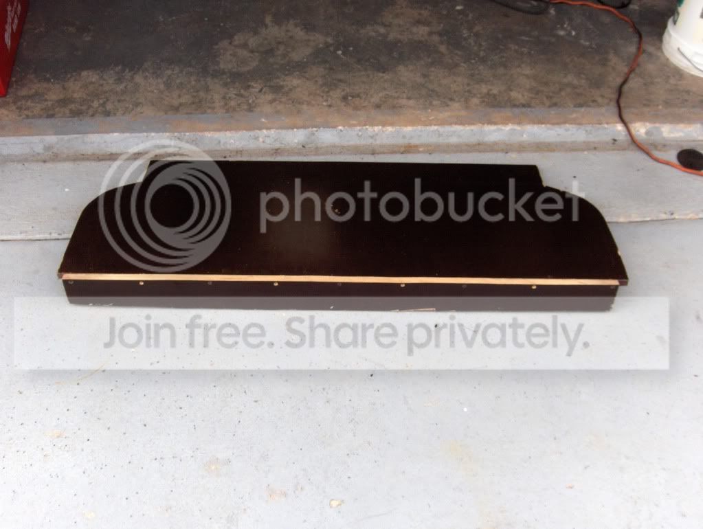

Hopefully next weekend or so I can post up my homemade RSD, I'm going to try and keep it under 5 lbs and under $50.
Also maybe try and make it look a little cool, instead of the overused black carpeting.
I have a plan, and it looks good in my head...But we'll see when it's done.
When I did mine I used some plywood I had lying around that was like 3/4" for the seat portion. For the backrest portion I bought some 1/8" plywood. It was light yet still strong enough to hold its shape. I then used black vinyl from Walmart and wrapped it in that using staples to secure it. I wanted to go back after it was done and redo the seat portion using the thin stuff but it came out so nice I didn't want to screw with it. pics for ideas.
Seat Portion:
Backrest: You can see strips of velcro to hold it in place and for easy access.
