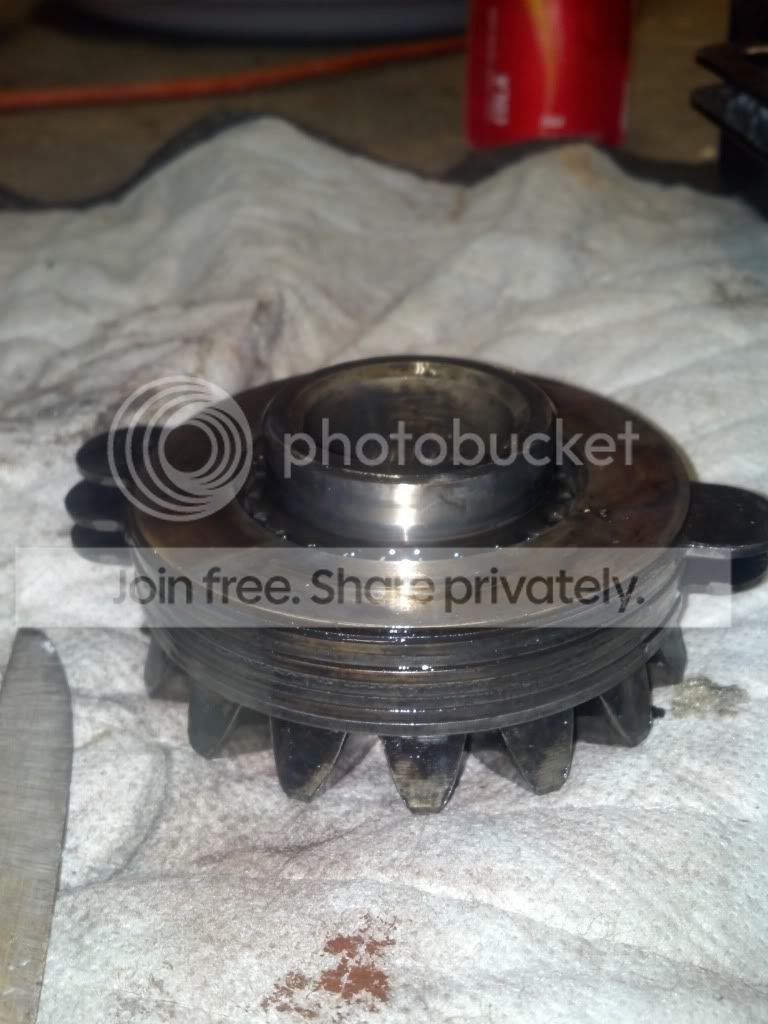

the old clutch pack

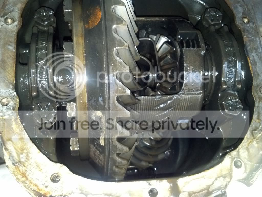

empty diff

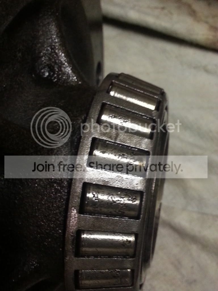

And here was the biggest shocker!
one of the carrier bearings was completely chewed up!

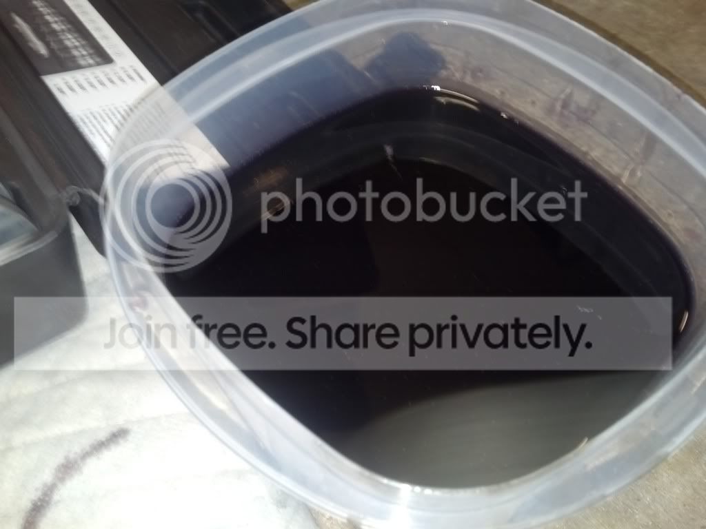

and this is where i left off, letting the carbon fiber clutch packs soaking in the rp gear oil (with friction modifier) over night, i will resume tomorrow.
