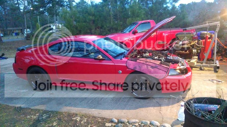

So I finally decided to stop being lazy and compile all my stuff into one thread.
This is what my car looked like when I bought it. This was the moment I handed over the cash.
Two hours later when I got her home.
Replaced hood stripe about an hour after I got her home.
Borrowed my GT's Pony emblem.
Got some 18" saleens
Got sent to california for recon school. Got Mac long tubes, lethal offroad X, extensions, steeda tri AX.
all those parts installed.
Tinted my headlights and tail lights.
New clutch cable, firewall adjuster and quadrant installed.
Picked up an IRS magnaflow exhaust.
Put the saleens on.
Painted the shaker
Painted brakes.
Installed a raptor performance shift light
Factory clutch said "**** you" after a 5k rpm launch. exedy stage 2 (mach 400)
