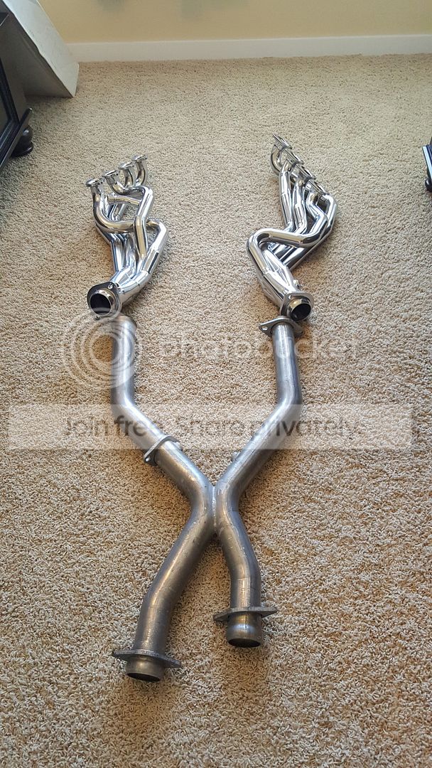

BTW here is the pictures in all their glory..

Now that, is a nice set up. Where is our exhaust video?
Oh trust me you will have one when they get out on tomorrow!
AH, should sound like supreme devastation once fired up :)
I haven't heard to many mach 1s with longtube and borlas. Seems like a unicorn set up. Maybe 2 videos on YouTube..

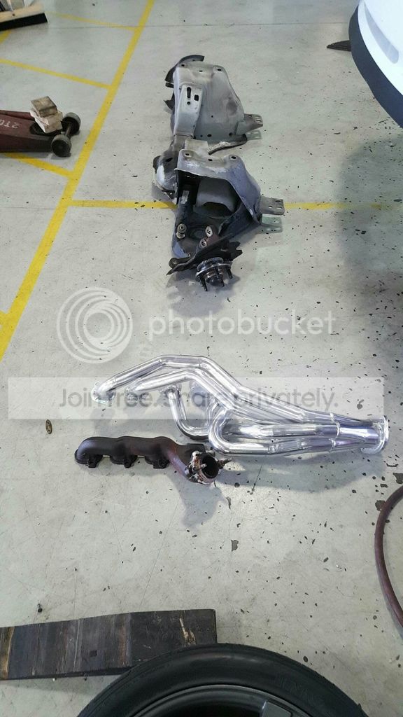

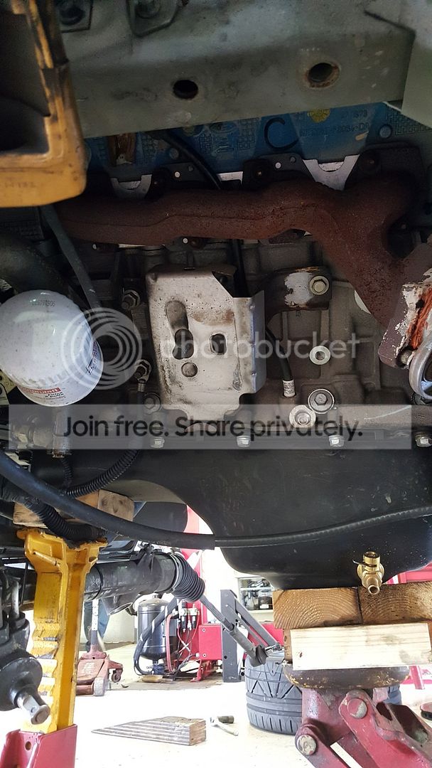

Major Update:
Here is the update for y'all. Headers are installed, but broke a tie rod and didn't realize till I went to re assemble everything. Took 1.5 to remove everything to get to the K member, then 4 hours to put the headers on, and 1.5 hours to reassemble. The install wasn't hard, just tedious.
TBH it sounds the same at idle and start up lol.. Revving sounds much louder.
