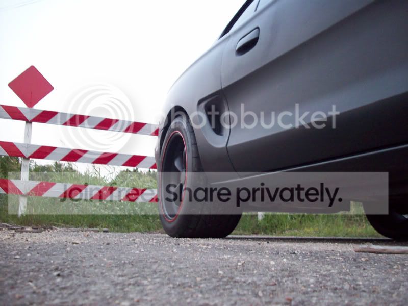

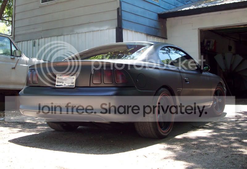

Since you can do body work and the paint yourself...do this!
BEFORE
AFTER (Smoothed trunk, bumper reflector)
ALSO, I've never seen this done before...
BEFORE
AFTER (smoothed side scoop)

Man you know what those are some AWESOME ideas i might just try those...... i like the rear end just like DALMARS (SP THE WHITE STANG) and the side scoops i am really going to try here soon kinda like the bullit SWEET. No i have not got around to putting in the HIDS.... to busy with work and i wanna do the install right and nice. Man i really love the rear without the lines......hummmmmmm Might just have to start sanding on that ish this weekend...we see Thanks again for the insight on the new ideas!!!!!! (^^0)

I have a few questions about that paint job. How's the paint driving on city roads and rocky roads, do you get chips easily? I have been wanting to paint it like that for a while and saw your car and think it would turn out bitch. I am just skeptical because I would figure the paint would chip easier without a clear coat and because its my DD.

Not usually a fan of murdered out cars, simply because they are played like crazy, but I actually dig that. Nice time attack touch on the wheels

I was thinking about taking my side "scoop" out and just making it flush like a Bullitt style one. The only reason to hesitate for me is because it's "functional" which has a bit of cool factor to it.
I am curious though... Is this a rattle can job? I remember you saying that it was John Deere tractor paint, but I haven't found it anywhere (I haven't really looked very hard) so I don't know what it comes in. I want to try this at least before I paint mine DSG. :coolsmiley:

No problem man...definitely do the trunk, I want to do it to mine...getting rid of the line look sick :thumb:

Um the paint is not a rattle can job, i used a HVLP gun and compressor just like a normal paint job and the paint comes in gallons just like regular paint you need to get the thinner as well. For a gallon its like 27 bucks and the thinner is like 8 or 9 dollars really cheap, you can get it from john Deere suppliers etc.

Well its kinda tricky with the paint, it holds up really well against rock chips etc just like a normal paint job, but what is cool is you can also buy the paint in a rattle can for touch ups like i do it blends really well. The only problem that i am having is if you spray it wrong than you might see some zebra striping and with a normal paint job you can wet sand it out, but with a single stage flat if you wet sand it, it will turn shiny on you. But i think its worth it, different looking kinda throw back to old rat rods etc.... plus it looks just plain cool on our cars. When i get my hood i am going to be respraying it because i can see some imperfection in the paint that i did when i painted it the first time, but i like to do stuff like this so its no biggy for me.
