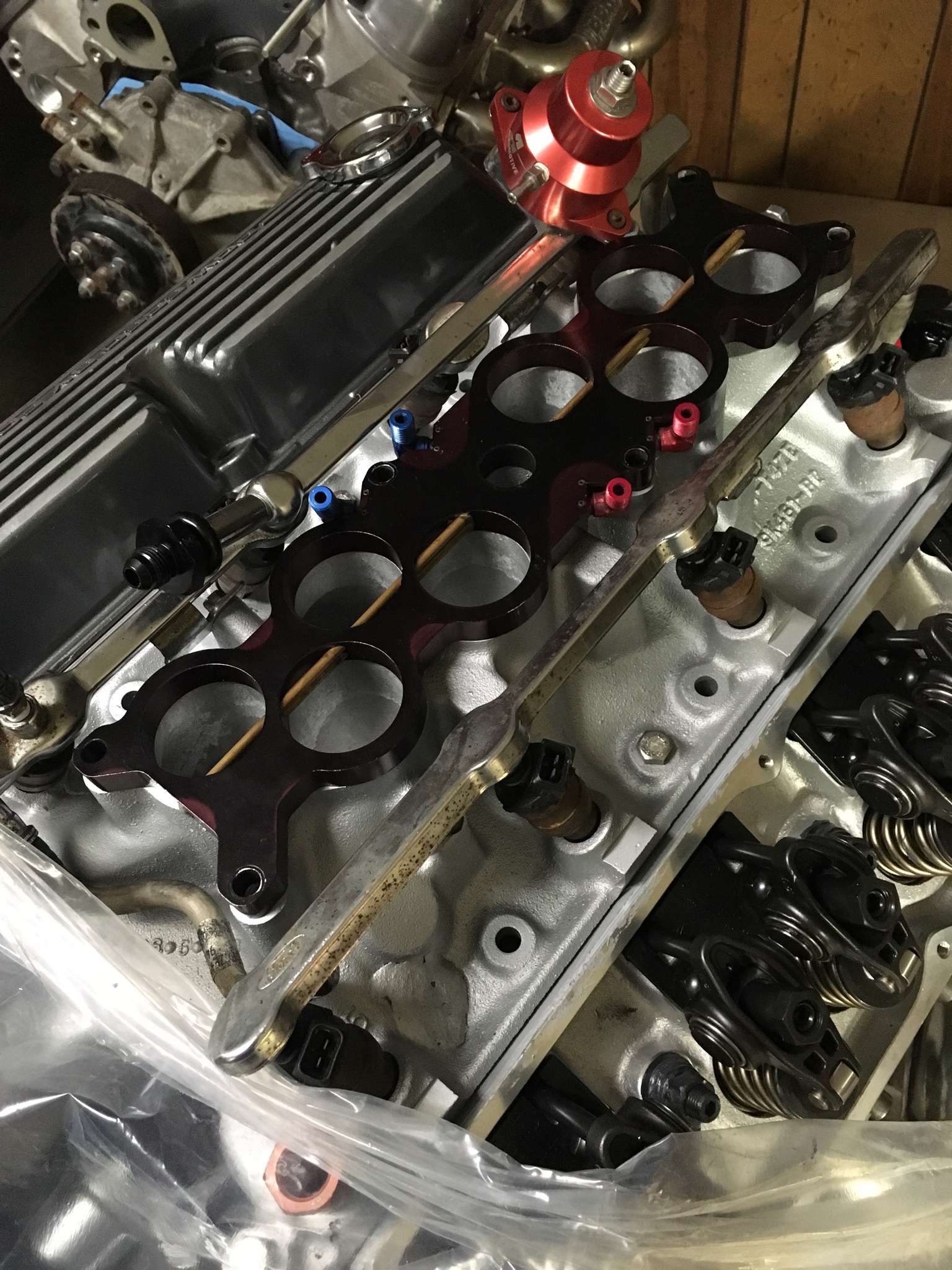

This will also be mine soon:

Nitrous plate and a spacer plate all in one, how convenient lol. How much spray are you going to put through it?
Still doing some research on the plate system but from what I've read that plate will go from a minimum of 150 up to the big leagues. It's a NOS Big Shot GT40 plate. But at the moment that's all I have. Jason acquired it in a swap so I'm getting it from him. I'll have to piece together everything else I'll need. Not in a rush to be able to spray it either, it'll happen eventually though. But yes, I needed a spacer anyway so it was very convenient lol.

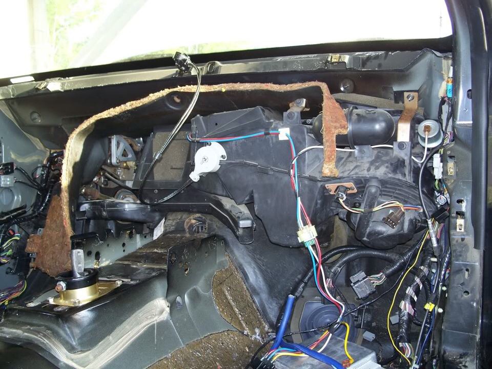

Got a few things done the past couple days. Ordered a distributor and heater core which will be here tomorrow morning, and you know what that means.....I get to pull my dash. Woohoo. But I also have another reason for pulling the dash. Reading thru some other threads I found where someone had cut a hole in the firewall just behind the bellhousing and fed the wiring for the injector harness, trans harness, and sending units through that hole.
In the picture you can see the hole just below the dash vent box. So last night I went ahead and got started getting all the bolts out of the dash, only need to drop the steering column and it'll come out.

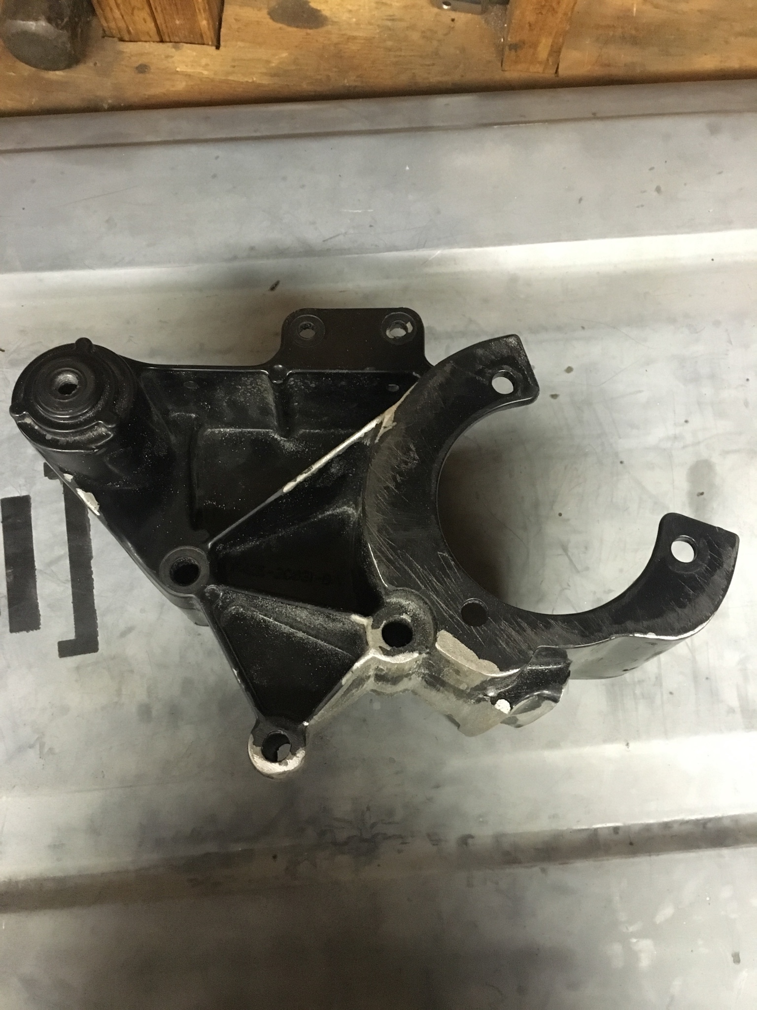

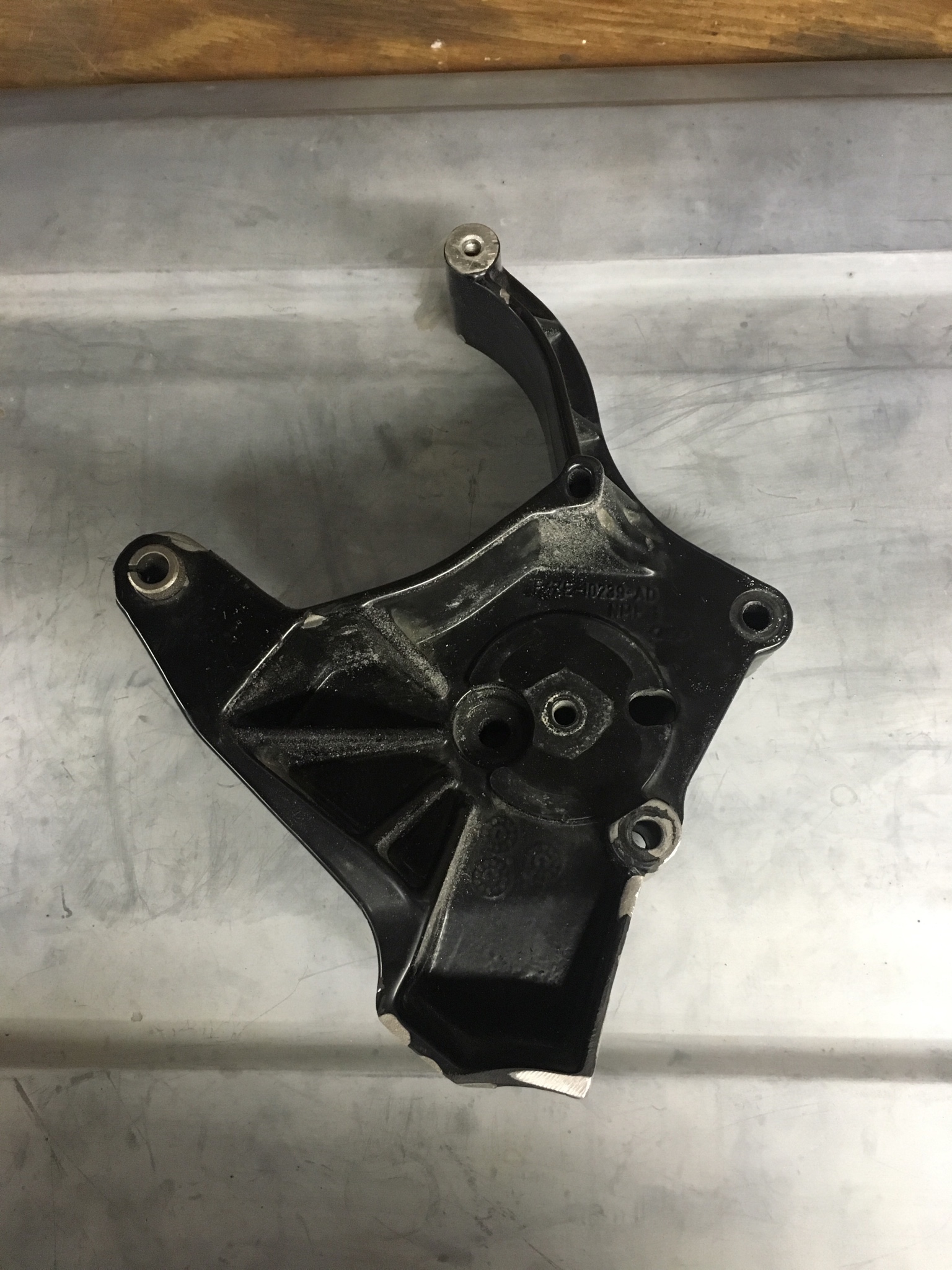

Since I already got rid of the smog junk and I'm ditching the AC, I decided to cut the excess mounting portion off the brackets for them. (I have another set of brackets if I ever decide to use the AC again). All together I spent about 3.5 hours on getting them smoothed back out. After they get painted you'll never be able to tell anything is missing.
Smog pump mounting tab removal:
After filing down what was left of the two tabs:
Then started working on this part, 'twas a *****:
A lot of elbow grease turned it into this:
Next was the power steering/AC bracket. Before:
Material removed:
After a lot of filing:
Was it worth it? I think so, not for the weight savings lol but for a cleaner look and more room to work on things. Will I ever do it again? I fvcking hope not.

What started out tonight as "I'm going to get my other valve cover then come back home" turned into "putting an anti-roll bar on the Coyote car and pulling the dash out of my car."
God that sucked.
What sucked worse was pulling the injector harness and transmission harness back through this hole in the firewall.
Next up is gonna be cutting away some of the insulation on the firewall and stripping the wrap off the harness to give me enough slack to run them where I want them. Picked up a heater core and distributor today also.
The factory dash already had a couple splits, and they only got worse after pulling it out...soo it looks like I'm gonna get a new dash too finally. Already have a lead on that though.
This build is getting deep...when I started I had no idea it would be at this point and now here we are.

Whats the main reason for running the harnesses through the firewall? Is it just for a cleaner look rather than having them come through the passenger side of the engine bay?

That's exactly it lol. I already wanted to figure out a new way to run the plumbing for my sending units, hated the way they were done before. So now you shouldn't be able to see anything coming out of the passenger fender area except the fuel lines and intake tube. It's a little over kill but it'll look a lot better in the end.

Sounds interesting. Do you happen to have a pic of how it looks?

Thanks man. The only picture I have is the one I posted that just shows the location of the hole in the firewall. I'll put a grommet in the hole and feed the harness out of it directly behind the center of the intake.
