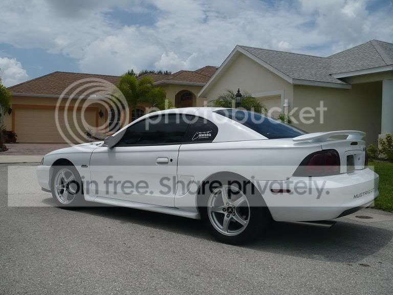

Hey everyone,
Just thought I would share my thoughts and goals with you guys to see what you thought.
So here is the Build List.
1. BBK ceramic coated long tubes
2. stage II porting on my heads
3. Built MMR short block 8.5:1 compression
4. Kenne Belle 2.1L blower & all the goodies that go with.
5. Stage 1 spec clutch
6. Aluminum flywheel and drive shaft.
7. And a nice set of aluminum valve covers.
I hope to run around 10lbs of boost with some good numbers. I don't want to go any higher than that for now because of my trans and the fact of gas mileage. With the build will be going a nice set of fuel and boost guages.When I get back from basic training I will be starting on this :) Anyway thought you might like to know what's in the works. Give me your 2 cents if you'd like :thumb:
X
