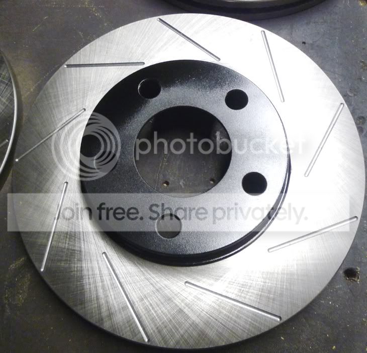

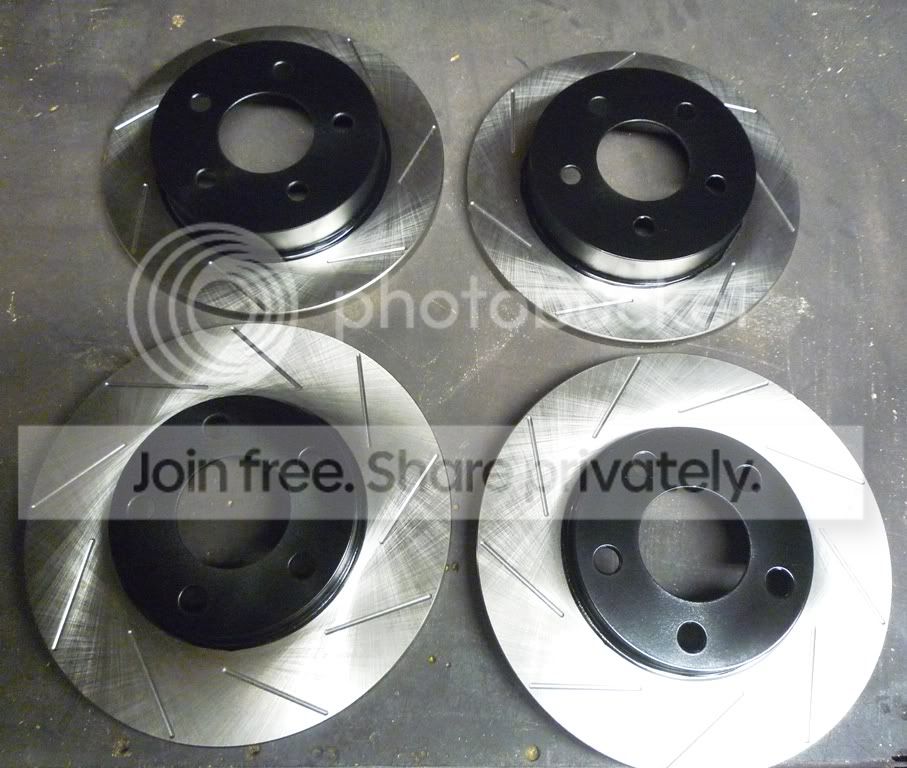

Powerslot rotors are here, now just waiting on the pads then I am going to do the full brake job and change my front studs with longer ones while I have it apart

Now have the pads as well, tomorrow and Sat are booked solid but maybe Sunday I will have a chance to do everything
