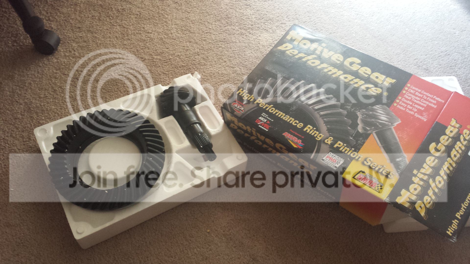

Got the gears today from Summit. Getting them installed professionally. I get my supercharger back from Jon Bond this Thursday. Then the car should be back on the road in a few days.
