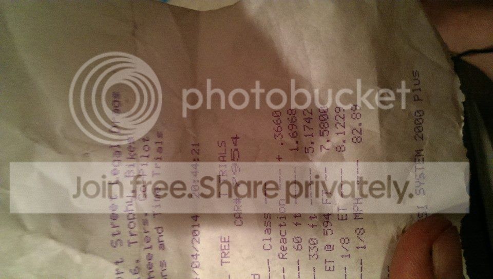

made an all time best pass last night. bought a pair of ETs

and i spray outta the whole and in ever gear. i never let off the gas or the wot switch until i cross the line. This pass should have been a 8.0 pass as i flipped the kill switch about 5 ft from the finish line :( should get a 7.90s pass this tuesday. might even yank the wheel 1/4 inch off the ground lol. friend of mine who was there swears he seen light shine from under my passenger side tire when i launched. but until i have it on video. i wont believe him.
