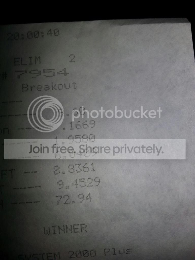

Well I wanted to give an update, I went to the track last night and ran a personal all time best

Not sure why my 60ft never changed. but i did run a all time best :)

Congats on the new best time. The same 60' with a lower time would point more towards better shifting or shift points.

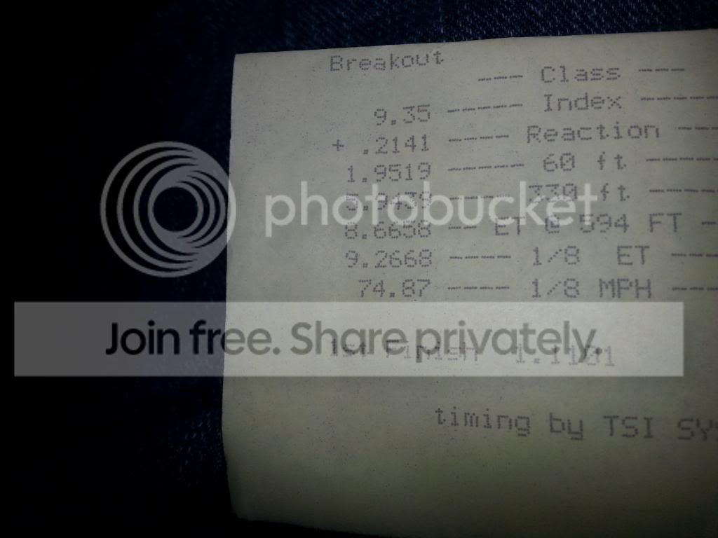

Also note, i did find a time slip where i ran a 9.37 and my 60 foot was 1.93. Think had i launched better i would have been closer to 8s

Just try it on the street shift around 5400 lift the pedal a little while you shift otherwise you'll Bounce off the fuel shut off
