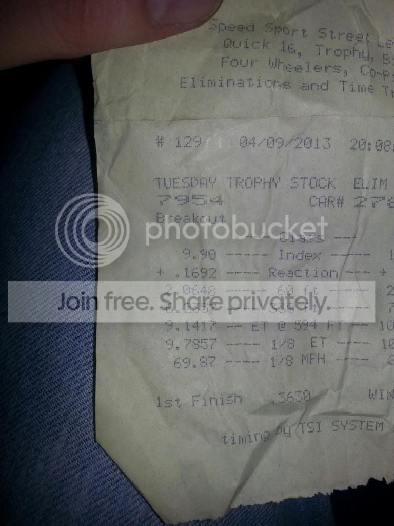

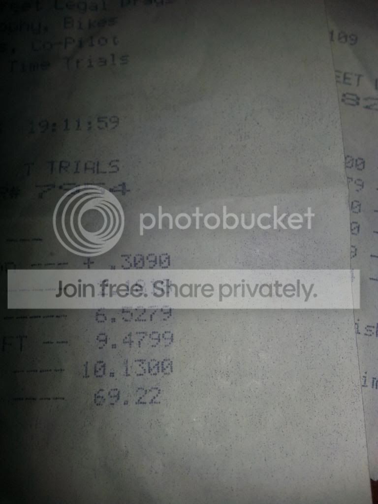

So, i got some way better times :)
This is me dumping the clutch at 5 grand
and this is me slipping the clutch
I have a crap load more slips but these where my best times doing both methods.
