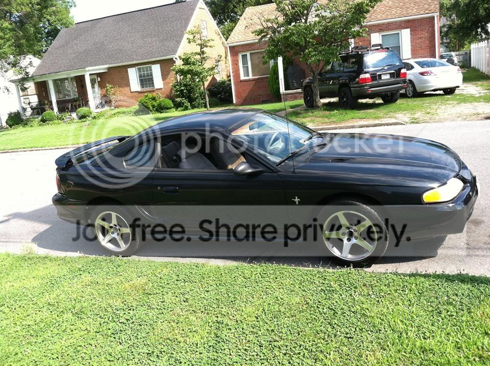

Currently running all stock susp.
I purchased some springs from LMR (sve lowering springs) and now im looking for a decent strut package,that wont kill my pocket.
Something what will work well with the 1.5-2'' drop.
looking to spend $200-$300.
Keep in mind this is for a daily 3.8 coupe. :D
(Current height)
