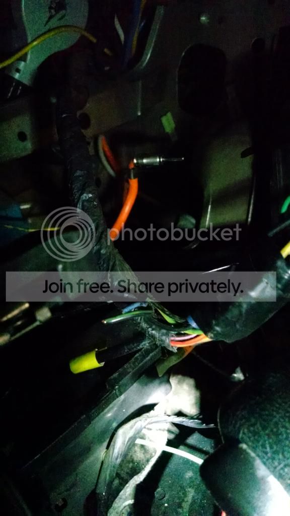

How the Best Buy harness was...

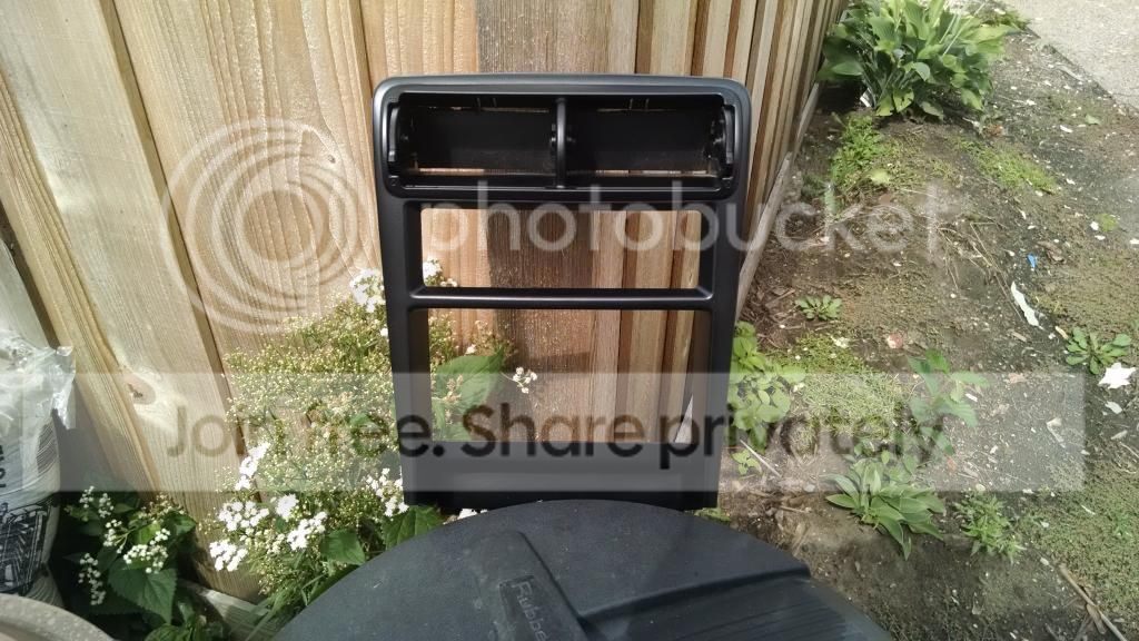

Made progress on my double din bezel

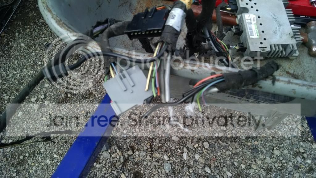

Mach 460 front amp and damaged factory harness,

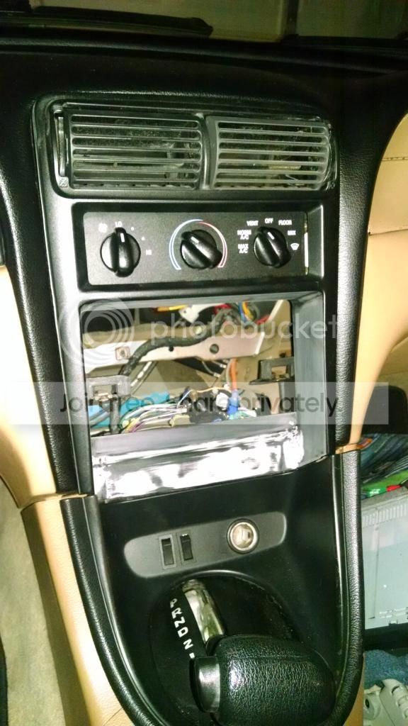

but here is what it looks like now
