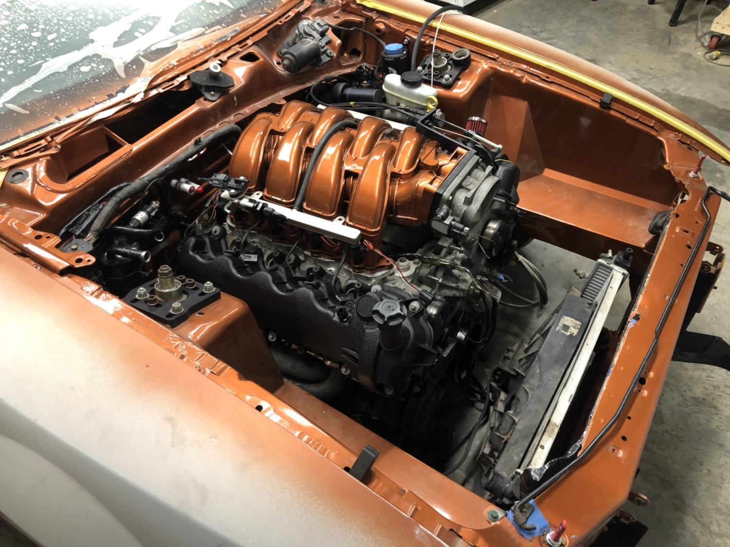

Well i got the engine and trans installed today. I’ll finish up the wire tuck with it all in the car since it’ll help keep things organized as an installation package.
my machinist buddy also sent me a photo of one of my brake brackets in “process” of getting machined. I am really excited to get these since they are the last item needed for the brakes.

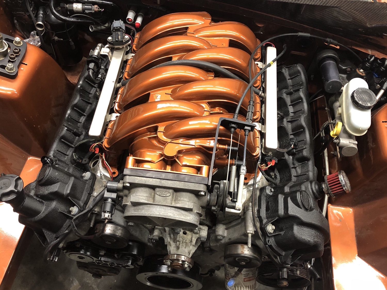

Got the TPS wires extended and then used some vulcanizing tape to attach some christmas tree tabs onto the main connector bundle along the firewall.
Now once i figure out how to get the IAC mounted nicely i can do the last wire.

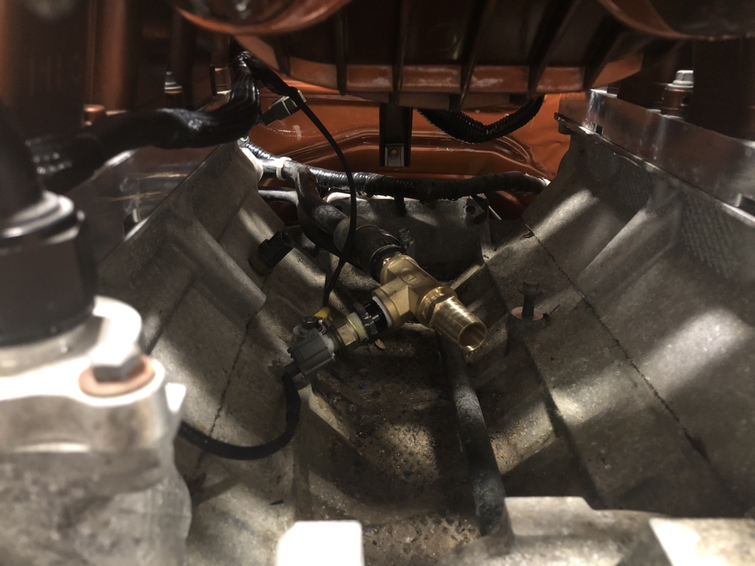

Also got the ECT sensor relocated to under the intake in one of the heater core lines:

I also finished the heater core hose adapter setup that mounts the factory water temp sender under the intake and converts it over to 12AN to adapt to the MMR coolant crossover AN conversion adapter plates:
