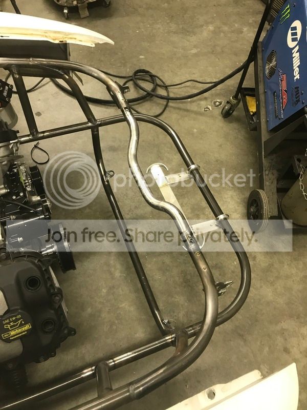

Made some covers for the steering column and also some tabs to mount the front end to the tube front. Also got a killer deal on some scales

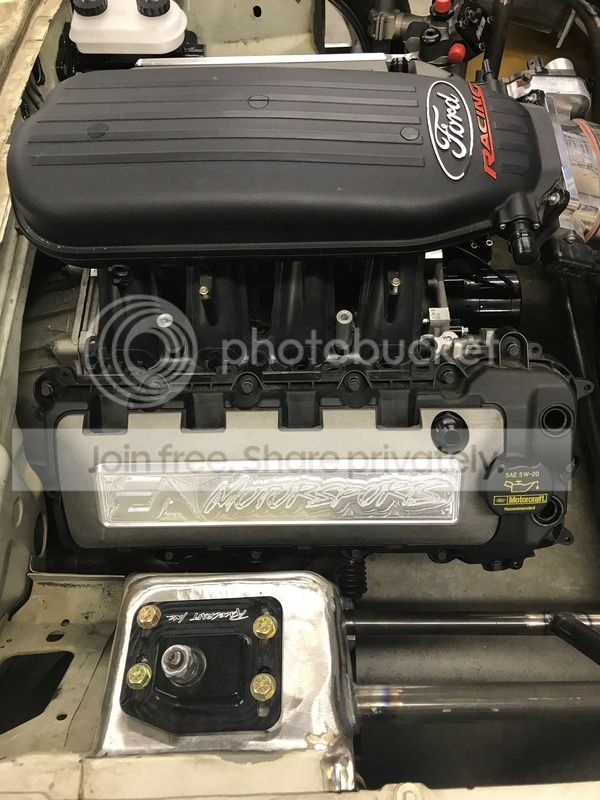

Set the motor and trans in to see how the headers fit and how I wanna do the intake. Also weighed the car as it sits now

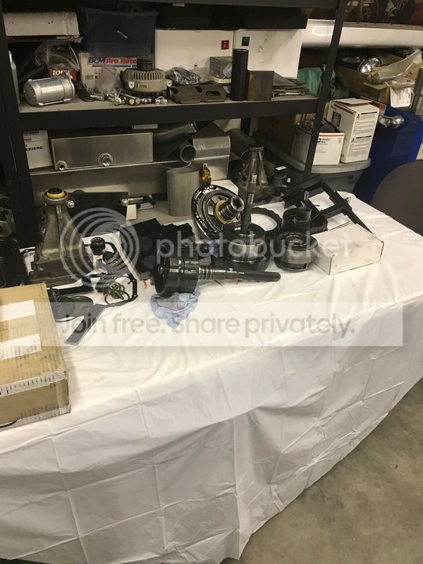

300m input, stub shaft, sonnax forward drum, 300m direct drum, extra clutches in the foward and direct, and fb mvb
Dont forget the spiral snapring for the roller clutch. That thing will come off and wreak havoc. The sure cure kit has what you need in it.
