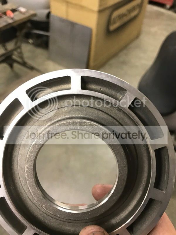

Starting reassembling the trans, waiting on a pressure plate to come in to install everything back in the case.
Stock forward drum vs sonnax drum
300m input and foward drum together.
Stock direct drum vs 300m center one
Drilled pressure reliefs in forward and reverse piston for valvebody and transbrake.
