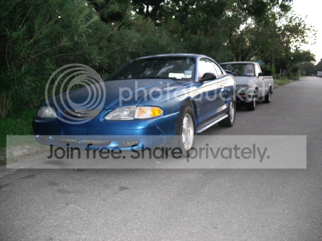

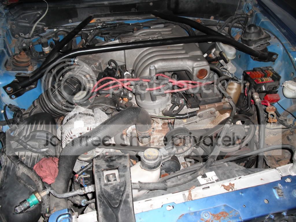

I figured I should start a build thread since im about to do alot of work to my mustang and Id thought Id share. So some history first I guess.
I bought the car a year and a half ago for 1,200 bucks. Its transmission didnt have OD, overheated and the suspension was GONE. Came with an off road H pipe, thick aluminum radiator, MAC shorties (in the trunk), 2 chamber catback, and plenty of body damage.
Rebuilt the trans, I needed to get a new case, but I found a hardened (billet?) input shaft and converter in it.
Geared it. 4.10's, new bearings, and shimmed up the traction lock.
Found the overheating problem. In a nutshell I had to do the Timing cover, water pump, 2 bypass hoses and about 4 coolant flushes.
Headgaskets popped on me one day (rusted and coolant ran out the back). I put a set of .030 milled GT40s on it and 1.6 motorsport rockers I had.
Did the shorties. Never will again. Long tube or nothing next time.
Replaced the tie rods. REALLY need to do everything else too.
As I got it...
