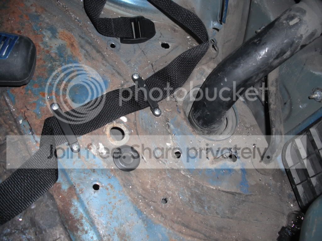

Drilled some holes
Car has the perfect cable grommets already. Need to hit the JY for more..

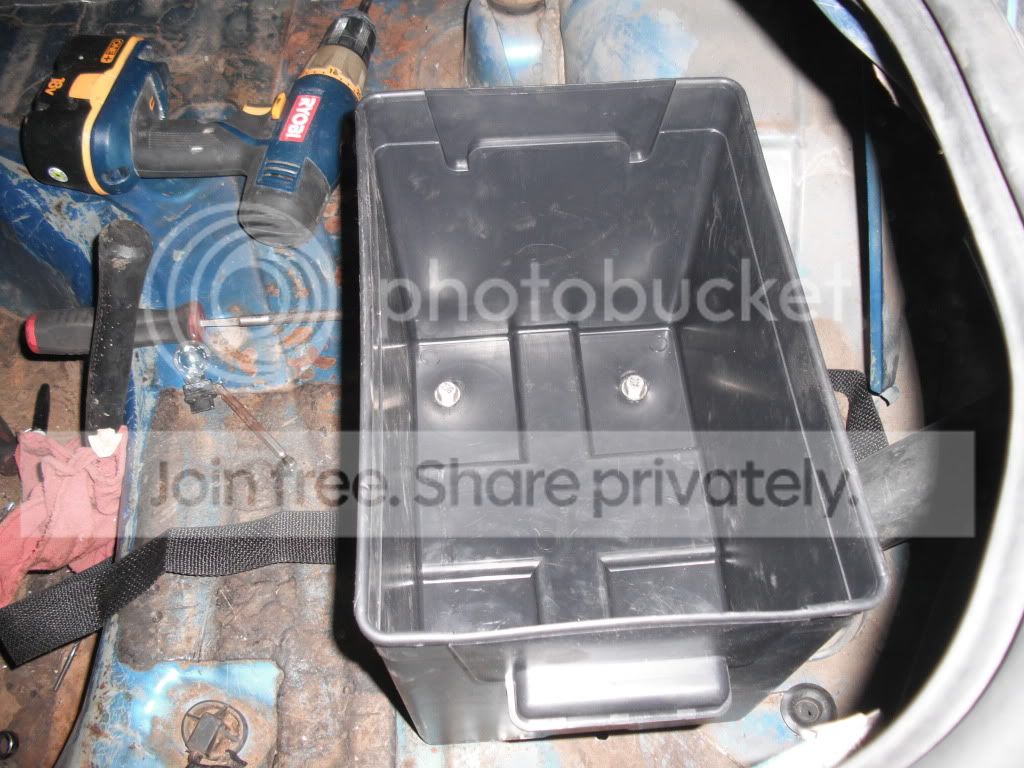

Box bolted down

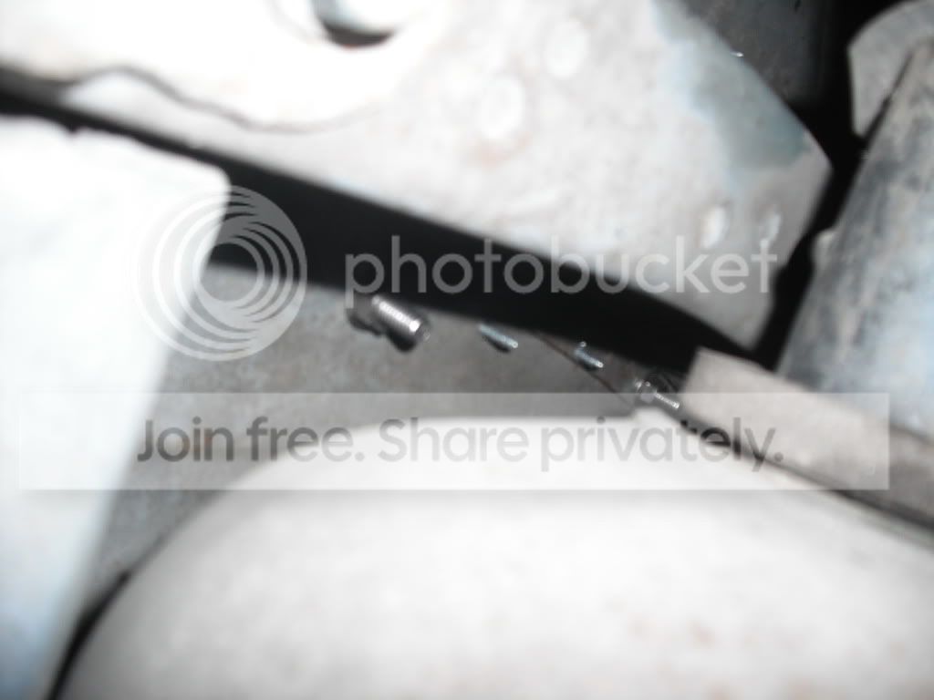

I was worried about the bolts (stainless steel) hitting the gas tank. An obvious no-no.
They cleared plenty...

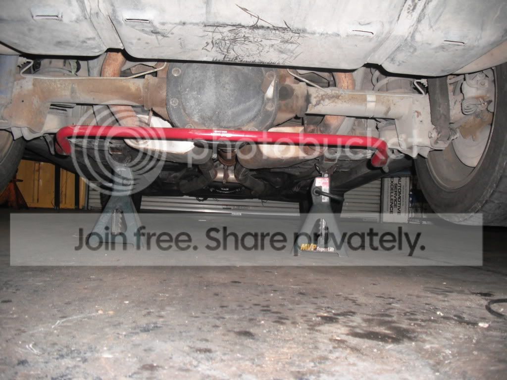

And a pic of my swaybar while I was down there..

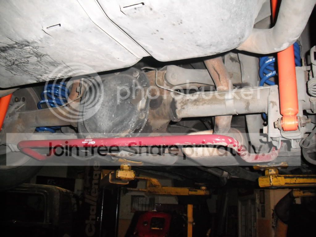

Got my parts..
And went from this...
To this...
Rear...
And front.
Rides pretty rough, but Im still getting used to it. (I did have a GONE suspension). Handles excellent.

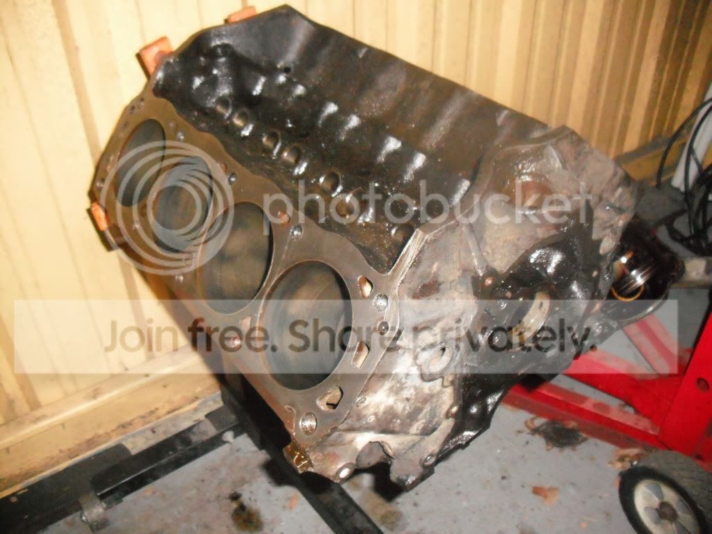

Oh and today I stripped down my 351 block. Thing looks perfect inside, a 10 over bore would be plenty, but for convienece sake Ill just do a 30 or a 40.
Making either a 393 or preferablly a 396.
I need to order some probe pistons I was looking at and send it to the machine shop.
