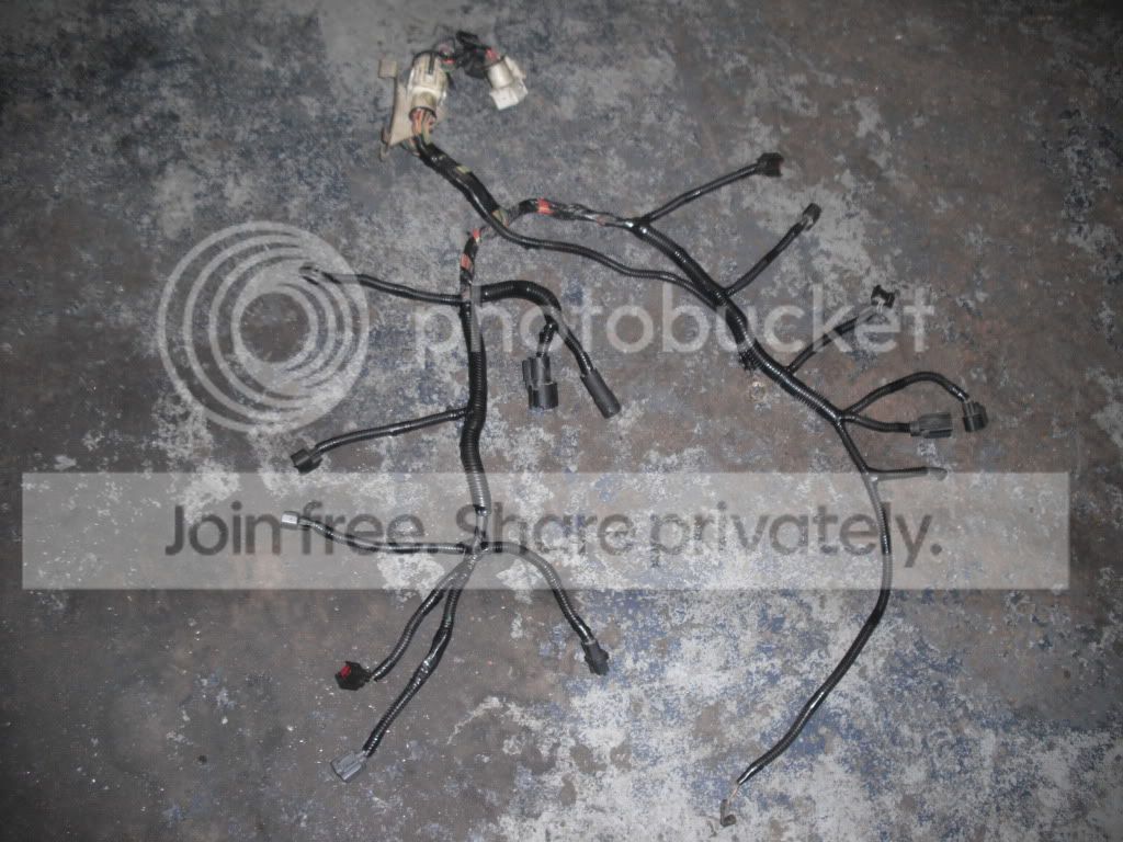

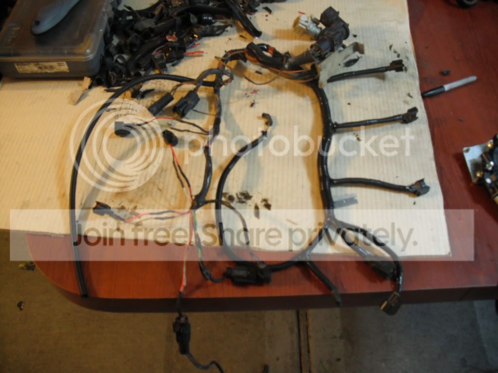

Oh and also I almost finished my EV6 injector harness last night as well. New plugs and re-loomed. Getting close...

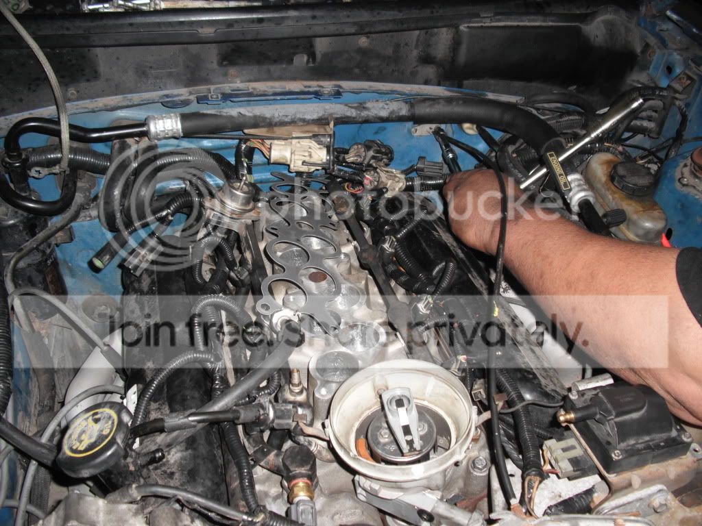

Today I got my fox throttle cable, and finished the injector harness...

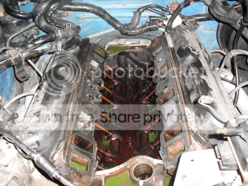

pulled the intake...
Me puttung goop on for the new intake...
EV6 injectors and SN95 fuel rails/coolant bypasses.
Put the inj. harness on. Then my buddy Rueben put the throttle cable on...
My goofy ass after uppers bolted on.
Throttle body and EGR spacer on...
Oil changed and coolant topped off. Thing fired up first try.
Amazing differance in power!!! Spun 1-3 gears like nothing. BBK throttle body whistles a little bit though. Cant wait to run it at the track. Feels like a 13 seconder. Oh yea!

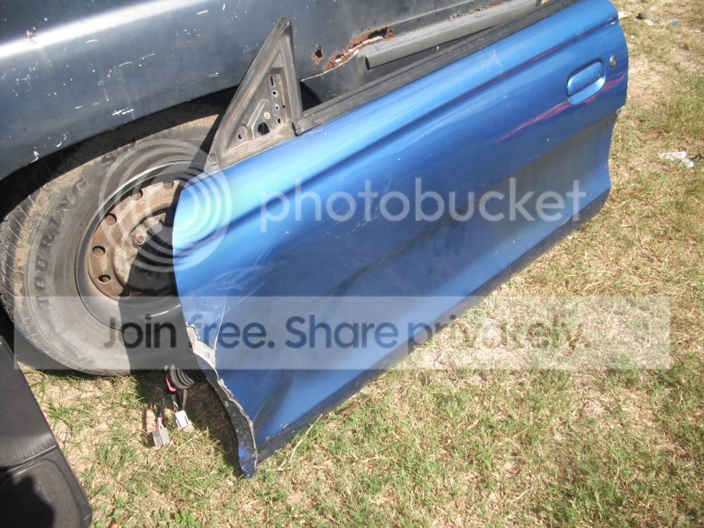

And yesterday I installed my new (junkyard) door and fender on the drivers side. Little known fact that the upper hinge is different in later years. (and mine is worn out to boot).
Today I need to install my old door harness in it and put the door panel back on. Besides that, everything went in smooth as silk.

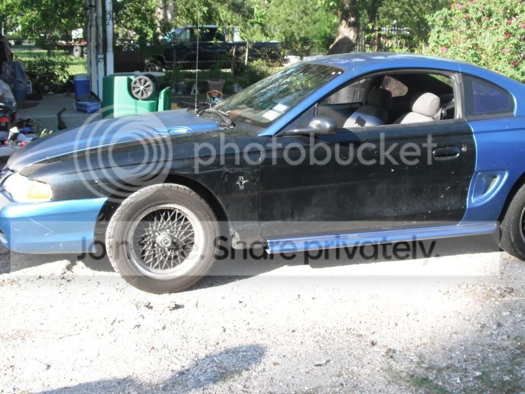

Put the door harness, steeda door handle, speaker, and door panel back on the drivers door.
Heres some pics...door
fender
here it is. (really dirty!) I need to put on the sideskirt bit.
My core support/headlight panel, and front bumper will be replaced soon. Then paint!

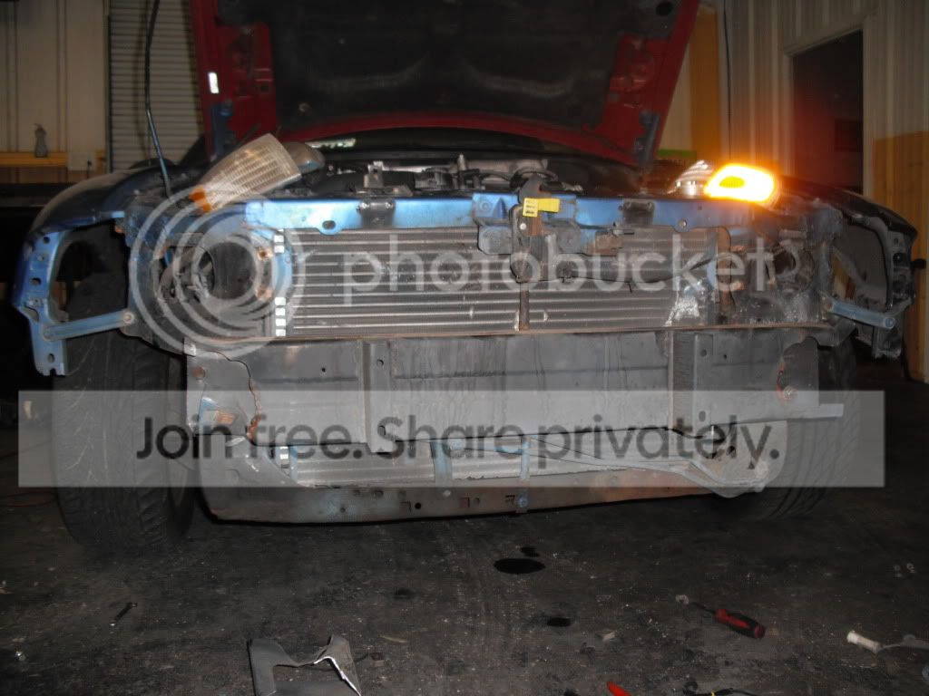

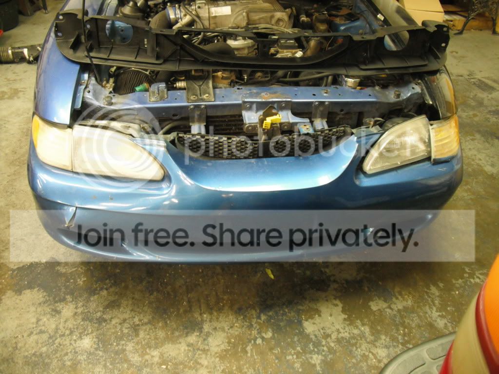

I replaced the headlight panel and headlights yesterday. No more bad boob job headlights...
Before..
after...
(with my old lights)
Found nasty damage under the bumper cover. (no foam piece...)
Bumper shortened (temporary) and everything extra pulled off.
put in the headlight panel
and the blue beauties.
